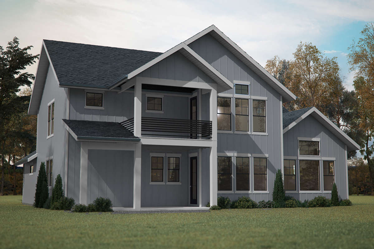

ChiefUserLukie Posted January 21, 2020 Share Posted January 21, 2020 Trying to make the living room a vaulted ceiling with the full gable roof, but it does not seem to take. The training videos show different options on the roof tool than I have in the newest version. It shows the gable type I want on the front bedroom, but I can't get the vaulted ceiling to work and it just runs the roof line all the way to master bedroom? Any help would be appreciated. The exterior pictures look odd because I'm still learning the program and am trying to figure out how to adjust my terrain to account for a walk out basement lol Link to comment Share on other sites More sharing options...
solver Posted January 21, 2020 Share Posted January 21, 2020 It sounds like you have 2 related problems, one with the ceiling and one with the roof. Attaching the plan file (close the software first) will help others help you. I would focus first on the roof, so someone will need to know what it is supposed to look like. Is this a new design or an existing house? Link to comment Share on other sites More sharing options...
ChiefUserLukie Posted January 21, 2020 Author Share Posted January 21, 2020 New design, but basing it off a picture online. Home Designer Architectural 2019. I attached the plan file as well. woodview.plan Link to comment Share on other sites More sharing options...
LawB10 Posted January 24, 2020 Share Posted January 24, 2020 First, Delete the first floor so that 2nd floor becomes the 1st floor and the third floor becomes the second floor. For the Living room gable, use the break wall tool, make a 12" or so break and ungable that little piece and lower the pitch. 1 Link to comment Share on other sites More sharing options...
