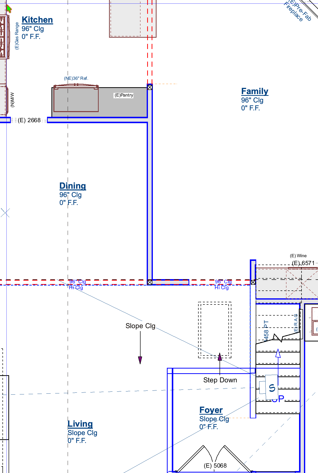

solver Posted May 20, 2019 Share Posted May 20, 2019 Easy enough to make your own using cad. I added the 4' and line to show the drawing scale and started a new scale bar below. I'm sure 3D Warehouse has a selection. Here is one from my library. Bar Scales.calibzFetching info... Link to comment Share on other sites More sharing options...

PaulJManoogian Posted April 30, 2023 Share Posted April 30, 2023 Hi, I realize it's been years since this was posted, but I'm looking for a scale exactly like the one Solver posted May 20, 2019. I downloaded and installed it to my library but I can't use it with Home Designer Pro (I get an error that it can't be used with this version). Any thoughts on where I can find a scale as such? Thanks for your help, as always! -Paul Link to comment Share on other sites More sharing options...
