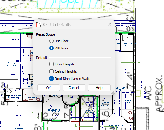

Jo_Ann Posted May 4, 2025 Share Posted May 4, 2025 1. Rebuild foundation, and don't alter it. 2. Turn ON Auto Rebuild Roof. 3. Under the toolbar EDIT, Reset defaults (all floors roof directives in walls). With the floor plan the ACTIVE window >TOOLBAR>Tools>Display. Uncheck dimensions auto and dimensions manual. Uncheck roof planes,roof baselines. Uncheck room labels,room interior area and dimensions and standard area. Lastly, on the toolbar under VIEW, uncheck reference Grid. The plan should now look very uncluttered. Do a 3d perspective view, and tile it vertically. Select exterior walls you know are gable walls, and set them. Pay attention to what changes in the 3D view. Link to comment Share on other sites More sharing options...
BraveUserMike Posted May 4, 2025 Author Share Posted May 4, 2025 1) while on floor 1: build>floor>build foundation>radio left on monolithic slab, click ok I notice that the pool deck has gotten out of line with the house and under roof patio so I undo, correct the pool deck, and redo step 1 2)switch back to 1st floor, build>roof>build roof>select auto rebuild roofs, click ok 3)Edit>Reset to Default>select radio for all floors, select check box for Roof Directives in Walls, click ok 4) Tools>Display Options>uncheck dimensions automatic, dimensions manual, roof planes (roof baselines was already unchecked),room labels, room interior dimensions (other two were already unchecked), I also unchecked CAD default to hide the survey, click ok 5)View>uncheck reference grid 6)Perspective Full View tiled vertically 7)Saved Link to comment Share on other sites More sharing options...
