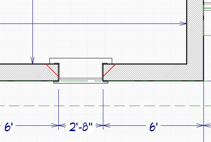

VisionNet Posted March 2 Share Posted March 2 Any ideas on how to show a 45-degree splay on interior jambs? Link to comment Share on other sites More sharing options...

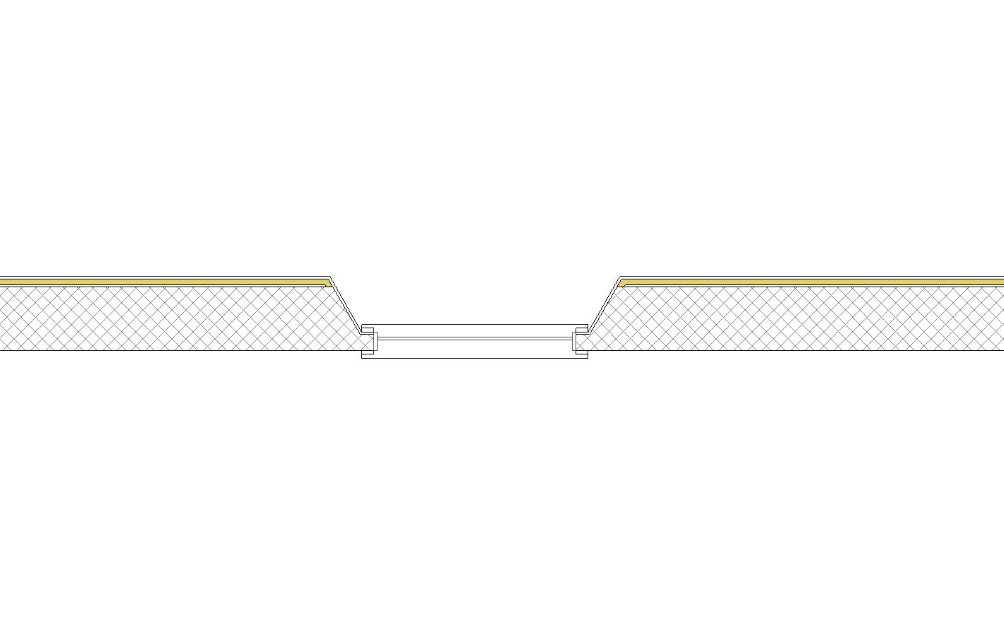

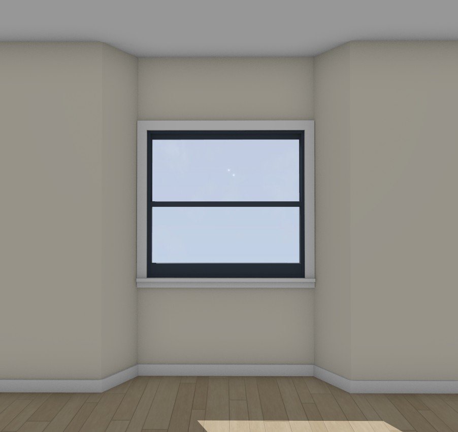

Angie15 Posted May 29 Share Posted May 29 It’s been done in Europe for hundreds of years, easily framed. It’s usually a stud wall on the interior. You don’t need a custom symbol from the premier line . This is how I do mine in Pro 25 but its been the same from Pro 21. In this image its a 350mm block/stone wall. Break the block wall at the width of your window. Change that wall to the same depth as your window. Draw a new stud/plasterboard on the interior of that and it will cut the block wall. Link to comment Share on other sites More sharing options...
