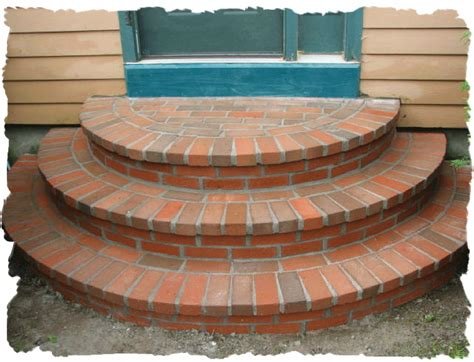

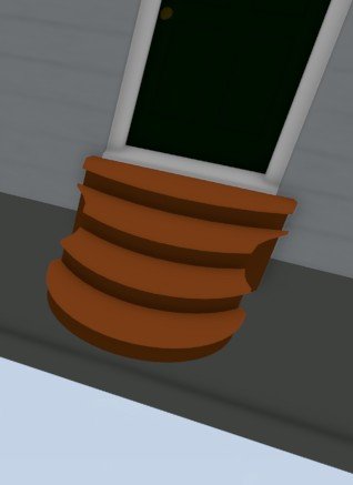

WeebleSue Posted November 4, 2025 Share Posted November 4, 2025 How do I create a semi-circle stair? Example is pic #1. I have tried using the flared stair option but the best I can get is the attached pic #2. I have searched and searched the available help but cannot find anything on this subject. The videos only cover options available, and this does not appear to be one, so it's not in the video. Still using HDPro2021. Retired and on fixed income, can't justify cost of a $500/year subscription for a program I don't use that often. Thanks. Susan Link to comment Share on other sites More sharing options...

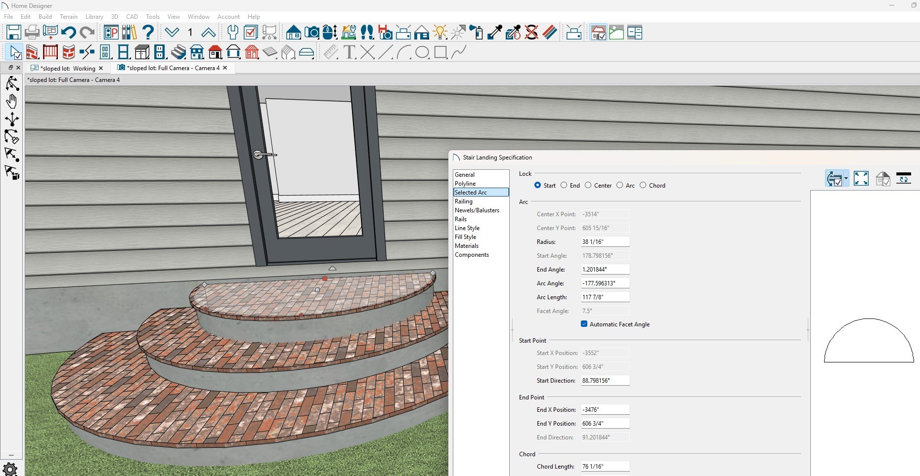

scottharris Posted November 4, 2025 Share Posted November 4, 2025 You could also use a stair landing and set the radius. Link to comment Share on other sites More sharing options...

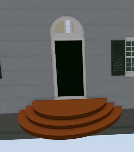

WeebleSue Posted November 10, 2025 Author Share Posted November 10, 2025 Thank you! I will try. One of these is sure to work. Link to comment Share on other sites More sharing options...
WeebleSue Posted November 12, 2025 Author Share Posted November 12, 2025 I did it! Thank you!!! Link to comment Share on other sites More sharing options...
