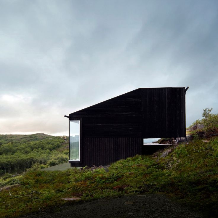

Randall30 Posted February 24, 2023 Share Posted February 24, 2023 Is it possible somehow to create an angled roof line, something like seen here in this photo of a modern black cabin? If so, how is this done? (I have Chief Architect Home Designer Architectural 2021) Link to comment Share on other sites More sharing options...
Rookie65 Posted February 24, 2023 Share Posted February 24, 2023 If Architectural has manual roofs, that's what you'd use. A lot of information on it in the reference manual or the "help" function in the program Link to comment Share on other sites More sharing options...
DavidJPotter Posted February 24, 2023 Share Posted February 24, 2023 Architectural has no strictly manual tools like Pro does. What you would do is to carefullly study the tutorials found in the "Build Roof Dialog - Roof Styles tab" on how to preprogram the Build Roof dialog and Wall specification dialog-Roof Tab settings to achieve the geometry you desire. DJP Link to comment Share on other sites More sharing options...
