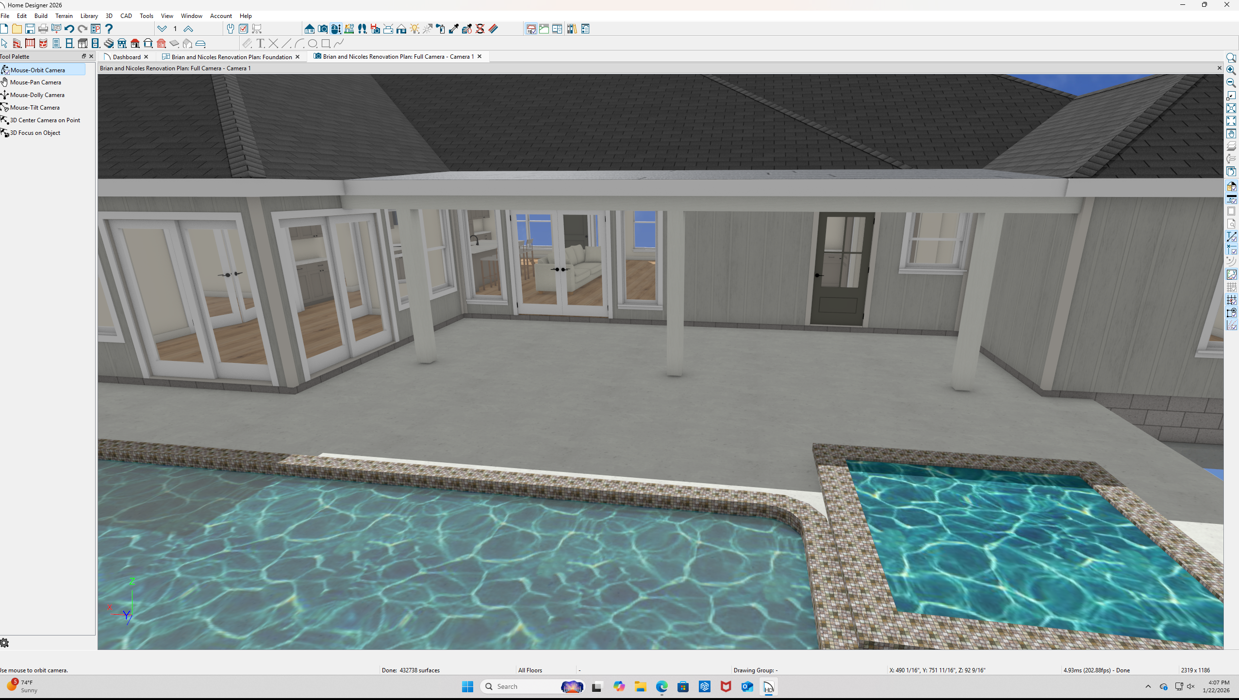

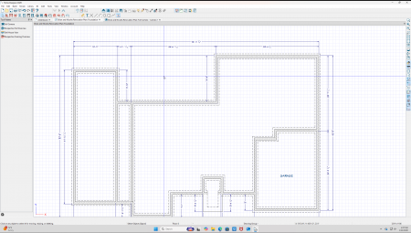

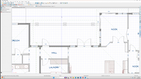

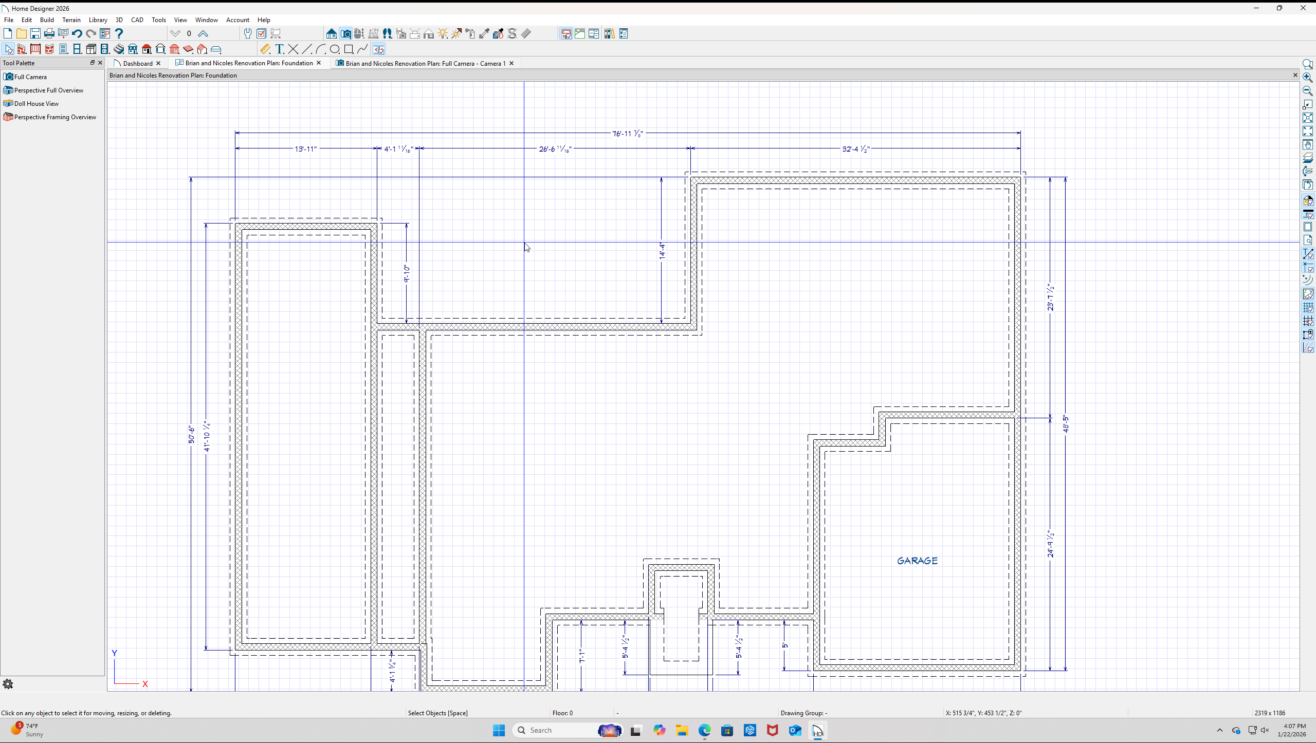

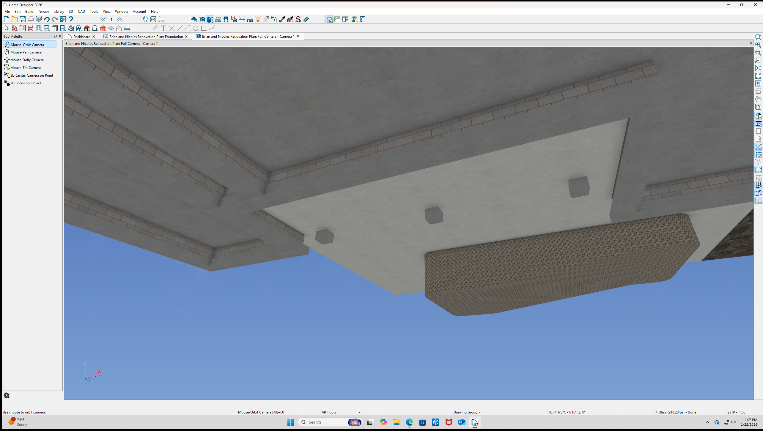

KTBuilder Posted January 22 Share Posted January 22 I think I searched existing topics pretty well, but only found where it was suggested to turn on "Post, Footings" in the Display Options. I already had that checked. I've got three patio roof posts each with a square concrete pad footing. They show everywhere except on the Foundation Plan. After I took these screen shots, I carried one of the posts down to the top of the buried footing, even though that is not how I would build it, but that won't make it display either. Am I missing something overly simple?? Link to comment Share on other sites More sharing options...

KTBuilder Posted January 23 Author Share Posted January 23 That sounds like an interesting way to do it. I haven't messed around much with railings other than putting them around an outside wood deck. The three posts are supporting a low slope modified bit roof with dimensional lumber rafters, and T&G ceiling. I think it probably needs the pad footings. This is also to be installed at an existing pool deck, so the pool deck will have to be cut out, excavated, and pour footings/piers. I can always draw the three pad footings on the foundation plan after it is sent to Layout. Just curious why it wouldn't place them automatically. Link to comment Share on other sites More sharing options...
y-g-m-n Posted January 24 Share Posted January 24 Not sure but probably one where you have to play with things to find the culprit. My guess is they are made on the first floor level not the foundation or level 0.. And I am not sire if that can be fixed... Link to comment Share on other sites More sharing options...

Rookie65 Posted February 13 Share Posted February 13 If you placed the footings manually, copy them from the main level, then "paste-hold position" on the foundation level. Change the line style too, and you should be all set. Link to comment Share on other sites More sharing options...
KTBuilder Posted February 13 Author Share Posted February 13 4 hours ago, Rookie65 said: If you placed the footings manually, copy them from the main level, then "paste-hold position" on the foundation level. Change the line style too, and you should be all set. That worked! I had previously just drawn them on the foundation plan after I sent it to "Layout". So both methods will work. Thanks Link to comment Share on other sites More sharing options...
