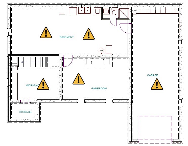

GLOBE-Res Posted January 6 Share Posted January 6 How do I remove the alerts? 1 Link to comment Share on other sites More sharing options...
Rookie65 Posted January 6 Share Posted January 6 Click on them to see what they are. They could be in reference to some framing directions. Link to comment Share on other sites More sharing options...
GLOBE-Res Posted January 7 Author Share Posted January 7 I did in fact click on them but they don't go away. Link to comment Share on other sites More sharing options...

Rookie65 Posted January 7 Share Posted January 7 If you click on them, it'll tell you what the issue is. Often it's a framing thing, and if you display "bearing lines", you may see them to delete. Yes, I have been fortunate to have a good design business going. I have a great group of clients who keep me busy steadily. Link to comment Share on other sites More sharing options...
GLOBE-Res Posted January 7 Author Share Posted January 7 Still no way to remove the indications 1 Link to comment Share on other sites More sharing options...
Rookie65 Posted January 7 Share Posted January 7 Try posting the plan Link to comment Share on other sites More sharing options...
GLOBE-Res Posted January 7 Author Share Posted January 7 1950 - 1.plan Link to comment Share on other sites More sharing options...
Robborito Posted January 7 Share Posted January 7 My dimes worth is that the exclamation marks are indicative of non-rectiiner wall angles. check ortho angles are 90 degrees apart and they should leave your workings. But I am a novice here. 1 Link to comment Share on other sites More sharing options...
Rookie65 Posted January 7 Share Posted January 7 As I mentioned earlier, these are joist direction lines causing the errors. If you drag your cursor over one of the warnings, there will be a comment showing what it is. Make your "bearing lines" visible, then you can delete them. Very simple. Link to comment Share on other sites More sharing options...
