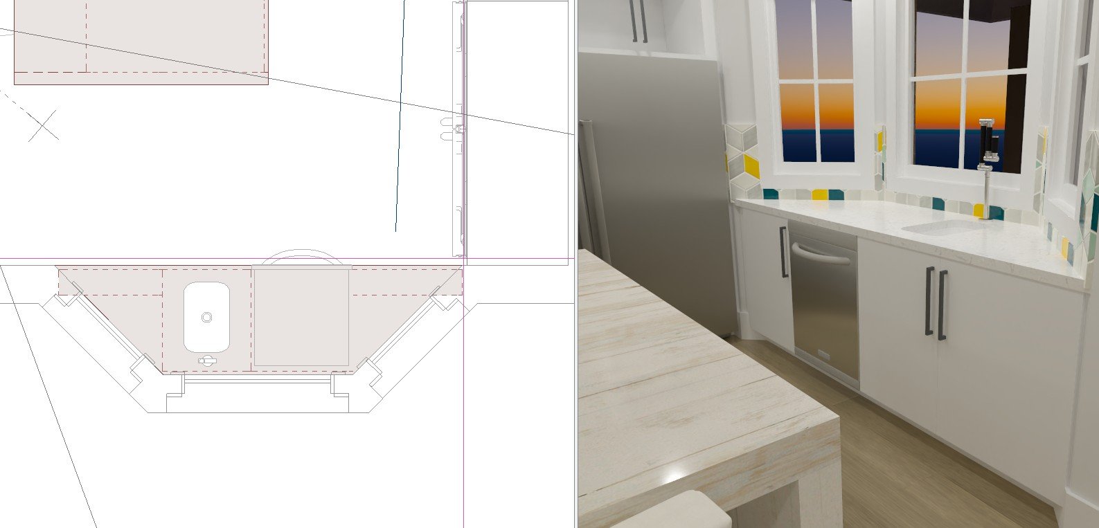

SandraH Posted October 22, 2025 Share Posted October 22, 2025 Is there any way to modify a kitchen cabinet so the back is set to 0 to create a triangular cabinet? I have a kitchen where the front will taper from 18" to 0 in the back, as the cabinets finish at an angled wall. I have played with the angled front, but its not exactly as I envisioned. I kind of solved it by making a cabinet that is only 4 inches deep and cover with a custom counter, but wondered if there was an alternative for these (rare) instances? Cabinet.pdf Cabinet elev.pdf Link to comment Share on other sites More sharing options...
Solution scottharris Posted October 23, 2025 Solution Share Posted October 23, 2025 Sandra, I think how you have done this looks good. The angled front is not a good fit here. I did this on a past project in a similar way. Link to comment Share on other sites More sharing options...
SandraH Posted October 23, 2025 Author Share Posted October 23, 2025 Thanks Scott. Just needed confirmation. Not ideal, but this is a poolhouse, not a full kitchen. Link to comment Share on other sites More sharing options...
y-g-m-n Posted October 24, 2025 Share Posted October 24, 2025 This is when your local custom cabinet maker gets involved... As they could make a cabinet box to fit and tie into others and look seamless. Not much storage inside so doors only. For software I would draw a base cabinet that is only 3/4" deep (sheet of plywood they use in cabinets) Door Front Only. Then add custom countertop to cover top. Link to comment Share on other sites More sharing options...
