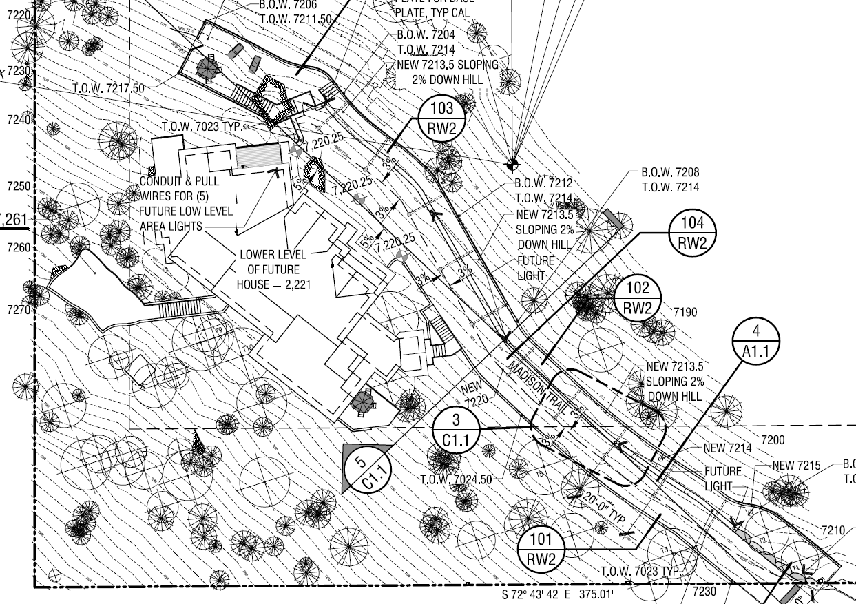

This is the actual drawing I am trying to get into Home Designer.  At least reasonable close :-)
