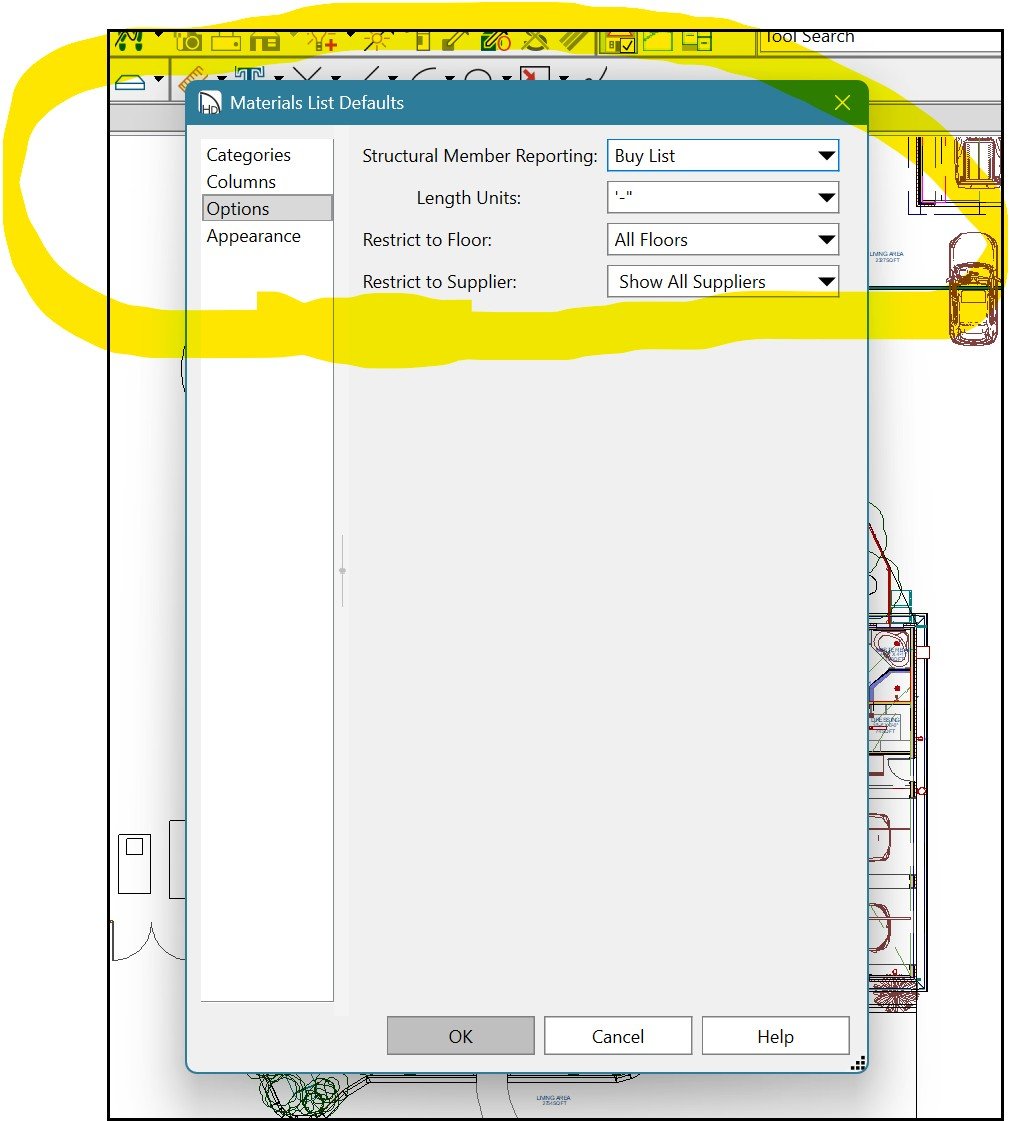

On 4/10/2026 at 1:44 AM, y-g-m-n said:
what are your settings under default for material list?
See attached as example
It shows "buy list" as well, but on the material list itself it lets me choose back and forth to different lists which it doesnt really break it down when I put on "cut list".
Link to comment
Share on other sites
when I put my default to cut list - that is what I get every single one and the length.
Does not combined a bunch of short ones into something that can be cut out of say a 12ft long board ...
