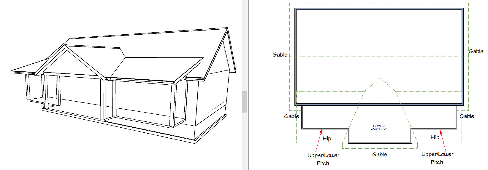

y-g-m-n Posted October 26, 2025 Share Posted October 26, 2025 draw it as a room - As Always use the HELP button it is very useful in anything. For walls use railings but Set roof to what you want over wall in thie case the front wall would be GABLE the sides HIP. CHECK - Rail style = open CHECK - Newel/Post = Post to Beam Play with type of post at wall start and end NEWEL/POsts Set width, any offset from wall, spacing then choose what you want for column in library Room Dialogue Set Type to PORCH Set floor Absolute elevation to your -7" (negative nunmber as 0 = top of 1st floor slab Pretty sure they have videos on website or something. PLay with software as it takes many hours of playing to find what works best and how to do things. Link to comment Share on other sites More sharing options...

y-g-m-n Posted October 27, 2025 Share Posted October 27, 2025 read about GABLE lines check the exterior walls by clicking on one and then open the EDIT dialogue. Go to ROOF TAB and review what you have as they list a few types but for most applications HIP or GABLE is what you would choose. SO for porch side walls select HIP POrch Front wall select GABLE Link to comment Share on other sites More sharing options...

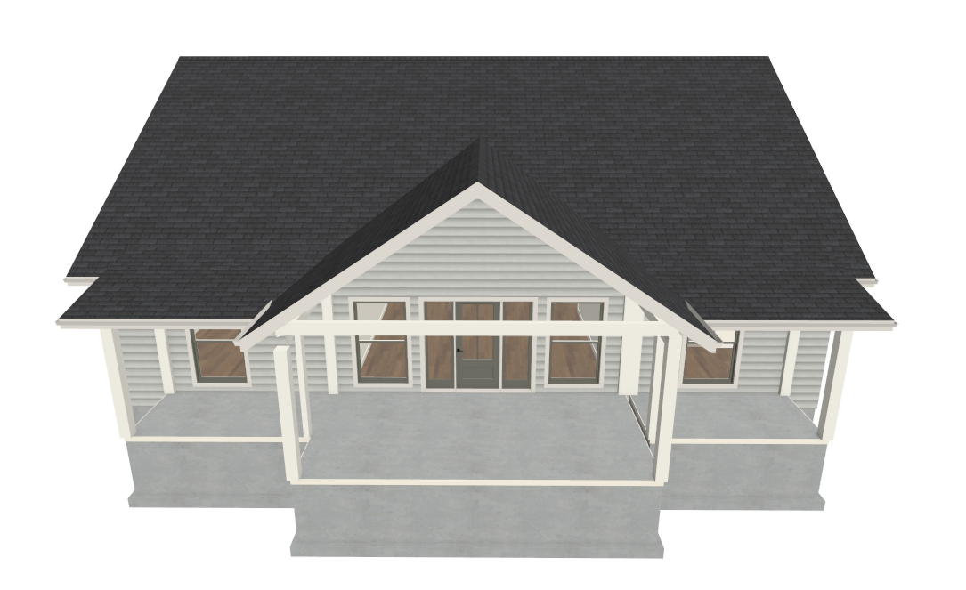

HomeLinda Posted October 28, 2025 Author Share Posted October 28, 2025 Wow - thank you all, I got it working. It looks great! I drew the side porches and then used the Roof Plan tool to draw a roof line just in front of the porch and then pulled it back onto the main roof which gave me a shed roof and then worked with it for a long time until I got it to connect to the center porch roof and main house roof. One problem - the left column on the front of the main porch is too short. I have tried soooo many things to fix it - including deleting that railing and redrawing it, deleting that railing and then copying the one on the right and reflecting it over to the left - still too short. I can't figure out how to attach a plan but will attach a screen shot. Link to comment Share on other sites More sharing options...
Solution HomeLinda Posted October 29, 2025 Author Solution Share Posted October 29, 2025 I fixed it! Part of the railing was missing but it wasn't obvious. Link to comment Share on other sites More sharing options...
y-g-m-n Posted October 29, 2025 Share Posted October 29, 2025 that roof might be too flat for shingles as they have a minimum roof pitch for them to work properly otherwise you have to treat it as a flat roof with the rubber overlayment and guys with torches sealing it off.. especially if you live where it snows. Check with a shingles manufacturer website or drive to HD or Lowes and rear the package on a shingle bundle. Doing this research now can save you headaches when actual building. see where I live in Hurricane gulf coast those would get ripped off in high wind events since wind can easily pick up edge and lift them off. Link to comment Share on other sites More sharing options...
