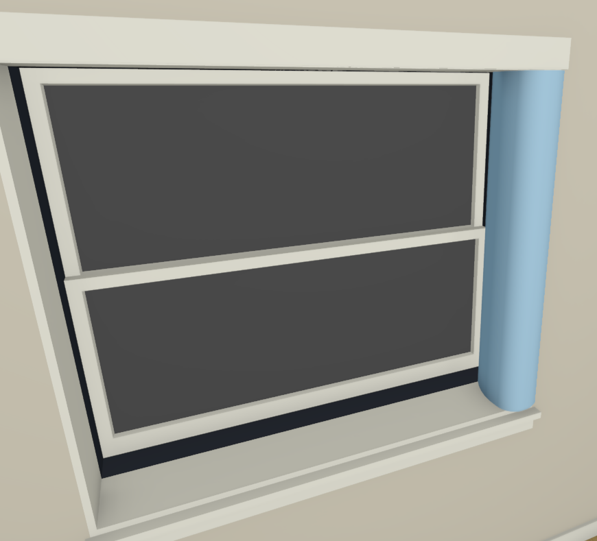

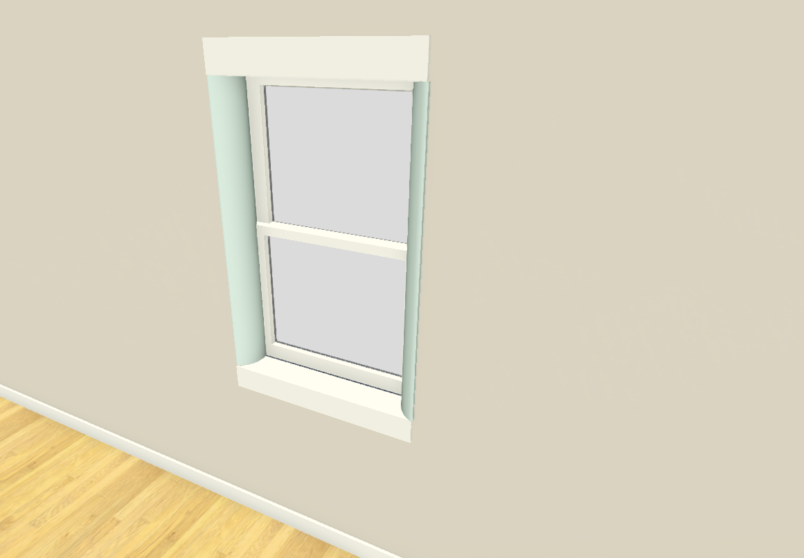

doctorSnow Posted July 20, 2025 Share Posted July 20, 2025 Hi guys, please does anybody know how to make this kind of half-rounded wall around windows ? Thanks a lot. Link to comment Share on other sites More sharing options...
scottharris Posted July 29, 2025 Share Posted July 29, 2025 Have you tried using a casing profile that shape? It might work. 1 Link to comment Share on other sites More sharing options...
Jo_Ann Posted July 29, 2025 Share Posted July 29, 2025 Maybe embed a custom countertop. 2 Link to comment Share on other sites More sharing options...
doctorSnow Posted August 10, 2025 Author Share Posted August 10, 2025 In Home Designer Pro 2025 I didn't find casing profile that shape. In Demoversion of Chief Architech I found RT02 - Rafter Rail, that is that thape. But In Home Designer I didn't found it. Link to comment Share on other sites More sharing options...
Jo_Ann Posted August 10, 2025 Share Posted August 10, 2025 Once again, embed a custom countertop. 1 Link to comment Share on other sites More sharing options...
doctorSnow Posted August 16, 2025 Author Share Posted August 16, 2025 Thanks a lot, custom countertop is a good solution. Link to comment Share on other sites More sharing options...
