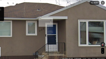

pwiref Posted May 9, 2025 Share Posted May 9, 2025 I`m looking to recreate the roof overhang in the street view picture,but am unsure how to go about it. Home Designer Architectural 2025 Link to comment Share on other sites More sharing options...
Jo_Ann Posted May 10, 2025 Share Posted May 10, 2025 Roofs build over "rooms". I do not see a porch "room" on the software pic. Link to comment Share on other sites More sharing options...
pwiref Posted May 10, 2025 Author Share Posted May 10, 2025 So then I have to build some type of platform, or in this case stairs and landing for the software to consider it a room or do I label in such? Link to comment Share on other sites More sharing options...
y-g-m-n Posted May 10, 2025 Share Posted May 10, 2025 also your roof pitch in model do not look like those in picture. drawing look steeper more like 12/12 where picture looks like 4/12 Link to comment Share on other sites More sharing options...
