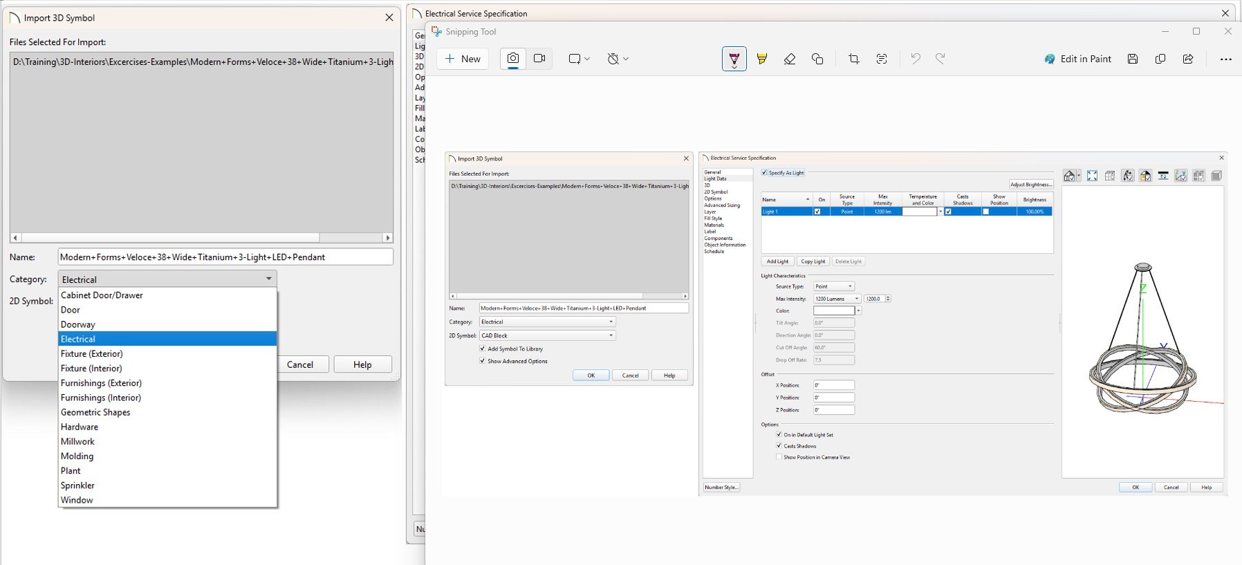

scottharris Posted 10 hours ago Share Posted 10 hours ago Home Designer does not have the symbol import that allows you to choose the symbol type like electrical lighting objects – see the example from Chief Architect Premier. So, what you might try – import the 3D model and place a light behind it so it appears to emit light. Link to comment Share on other sites More sharing options...
