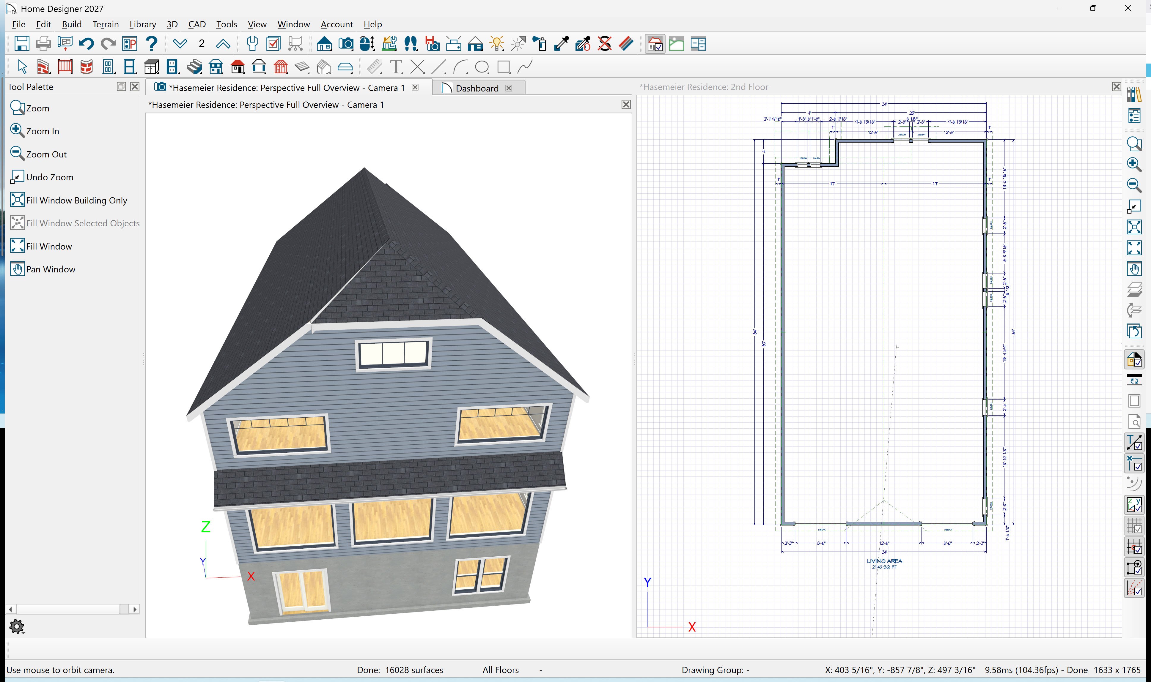

DaveFite Posted 16 hours ago Share Posted 16 hours ago Could some knowledgeable expert please explain why my roof plan is torn? I've tried creating the roof several times and it always is incorrect at the same ridge. The two big roof planes are supposed to be at a 9" pitch and the small one at 12" pitch. Thanks! Hasemeier Residence_2026_08_21.plan Link to comment Share on other sites More sharing options...
Rookie65 Posted 13 hours ago Share Posted 13 hours ago There's a tool that looks like 2 triangles at an angle that is the roof connector. You click on the 1st roof, then the one you want to join it with. Plus make sure the break in the edges is the same distance from the ridge. Likely more of an explanation in the reference manual. Should update your signature now that you're using Home Designer 2027 too Link to comment Share on other sites More sharing options...
DaveFite Posted 8 hours ago Author Share Posted 8 hours ago Thank you for responding! Fixed the signature, but can't locate a roof connector tool. Is it under build roof? Tools pulldown? Searched the manual for "roof connector" with no results... Arrrgh! Link to comment Share on other sites More sharing options...
Rookie65 Posted 7 hours ago Share Posted 7 hours ago If you click one of the roof planes, look along the bottom tool bar towards the right side. Unless you have your tool bar set other than default. Or just search under "Roof." Link to comment Share on other sites More sharing options...
