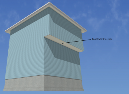

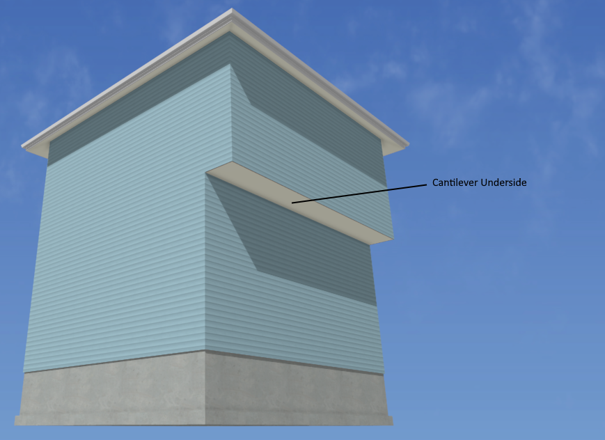

CarrieS Posted July 31 Share Posted July 31 Hi @Browneye The Cantilever underside only applies if your room overhangs the lower floor. You don't need to really worry about it unless you have that scenario. Though looking closer at it, we don't model actual geometry for that underside surface so it isn't included in the Material List. Carrie Link to comment Share on other sites More sharing options...
