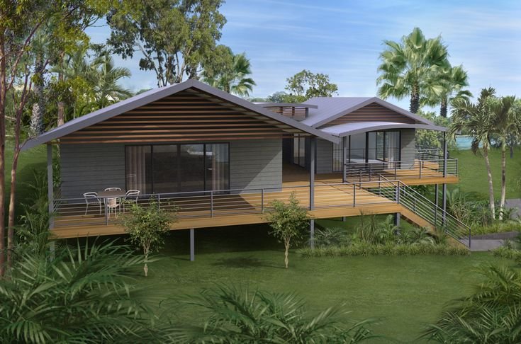

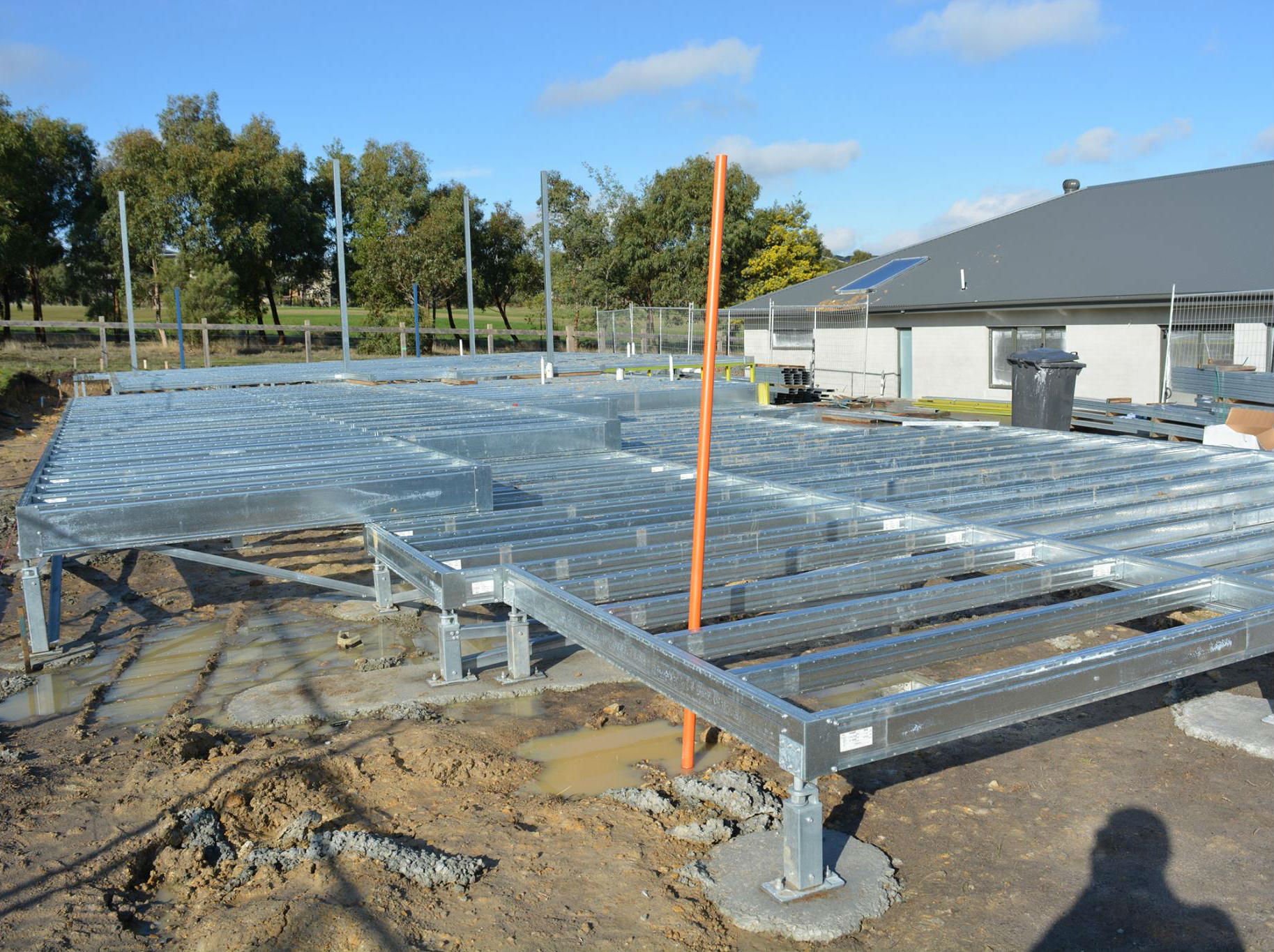

This worked great originally however for various reasons we now need to change from a slab foundation to a pier and beam foundation (suspended floor) on both levels that meet the ground. I'm struggling to figure out how to change the plan so that the correct foundation is included - for starters it won't give me anything but stem walls and slabs even when I specify "grade beams on piers" in the foundation tool.
