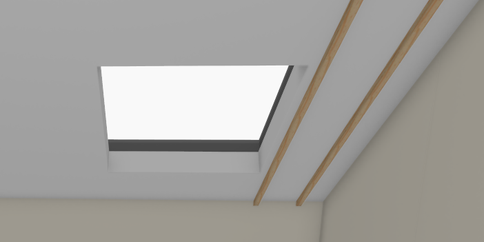

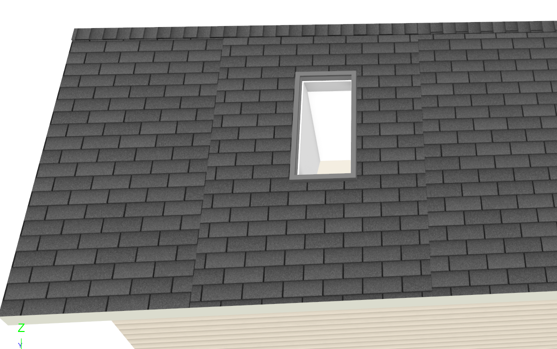

JohnEisenbraun Posted February 18 Share Posted February 18 I am modeling my current house in anticipation of some remodeling. I have a vaulted ceiling (with a skylight) that has a different rafter size (2X8) than the other sections of the roof in the house (2X6), but is in the same plane as other roof sections. I have attempted to model this by creating different roof planes and then joining them, but that doesn't work. (Sample model attached.) I can't join the roofs. I can place the roof sections adjacent to each other, but they won't join which is functionally correct but doesn't look good in the 3d view. Is there any way to do this? Any alternate approaches? (I tried to upload my plan but I get an error -200.) Link to comment Share on other sites More sharing options...
Rookie65 Posted February 18 Share Posted February 18 Once the roofs are attached, open the roof plane that needs to change, and change the "structure" tab to the correct size rafters. If that doesn't work, and you are using auto roofs, change the framing to all 2x8, then turn auto build off, and manually change the framing of the roofs to 2x6 where needed. That will keep the ridge at the right height. You can also copy the ridge height of the matched roofs, then change the height of the 2x6 roofs to match that ridge. Link to comment Share on other sites More sharing options...

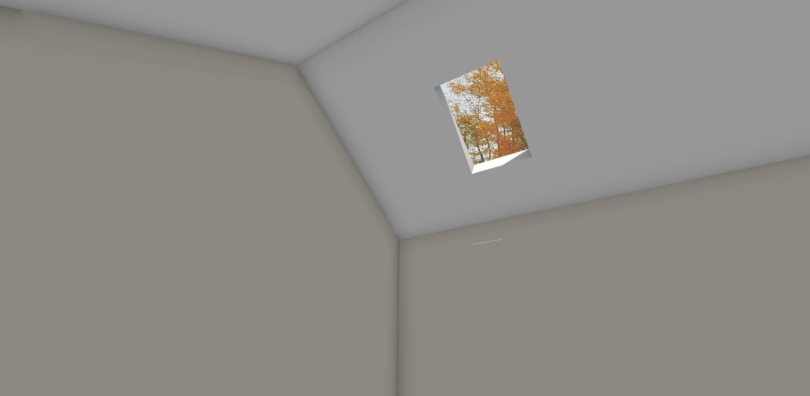

JohnEisenbraun Posted February 18 Author Share Posted February 18 I'm not sure what you are telling me... I've uploaded another picture. It shows the original problem a little better. I can't join the three sections of roof that make up the roof. Home Designer won't let me. I can try changing each individual rafter (in the 3d rafter view) that are in the vaulted ceiling to 2X8's - that might work. I did have an issue when I change the entire roof to 2X8s where the rafter tails jut out from the facia. (In the actual house, the rafter tails are cut down to 2X6 size which I don't think I can do in Home Designer.) I also tried to just create a ceiling plane the right thickness to make up the extra room for the 2X8, but the holes in the ceiling plane and roof don't align. Link to comment Share on other sites More sharing options...

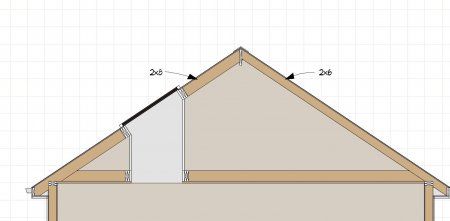

Rookie65 Posted February 18 Share Posted February 18 Is this what you're looking to do? Link to comment Share on other sites More sharing options...
JohnEisenbraun Posted February 18 Author Share Posted February 18 If I try extending the 2X6s to 2X8s they show through the vaulted ceiling. Any way to fix that? Link to comment Share on other sites More sharing options...
JohnEisenbraun Posted February 18 Author Share Posted February 18 Keith, no, that isn't what I'm trying to do. Changing the entire roof plane to 2X8s would work, but that doesn't model the existing house. Only the section of the roof where the vaulted ceiling is has 2X8s. The rest of the roof is 2X6s. Link to comment Share on other sites More sharing options...

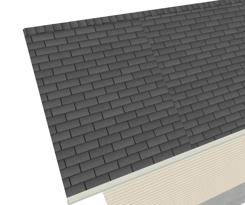

JohnEisenbraun Posted February 18 Author Share Posted February 18 Also, changing to 2X8s results in the following. I was hoping I could change a section of the roof (just the rafter tails area back to 2X6s), but that runs into the issue where I can't join roof sections again. Link to comment Share on other sites More sharing options...
Rookie65 Posted February 18 Share Posted February 18 As I mentioned, build the roof at all 2x8. Then once built, change just the side that needs to be 2x6. Keep the ridge height the same for both roofs Link to comment Share on other sites More sharing options...

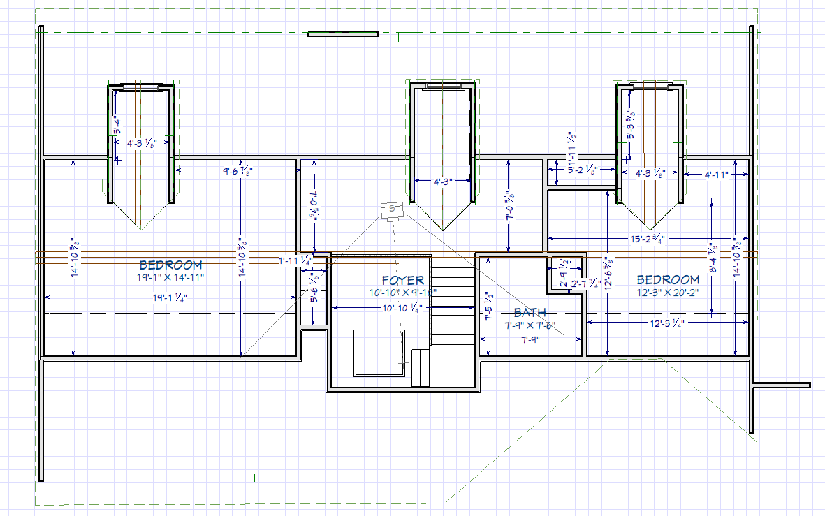

JohnEisenbraun Posted February 18 Author Share Posted February 18 Keith, yes, I could do that, but that isn't correct. The roof on the one side of the house is made up of 3 sections, all on the same plane. Two of the sections are 2X6s, One is 2X8s. (See the original sample roof I drew). You can see three sections of roof. (There is a line in the shingles where the roof sections are drawn). Drawing the roof all with 2X8s also runs into the rafter tail issue I show above. I've attached the actual plan. Only the Foyer has 2X8s. The rest of the roof on that side is 2X6s. Link to comment Share on other sites More sharing options...

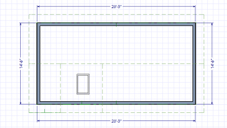

JohnEisenbraun Posted February 18 Author Share Posted February 18 Just for clarity, here is the example plan I used to illustrate the problem in the original post. Link to comment Share on other sites More sharing options...

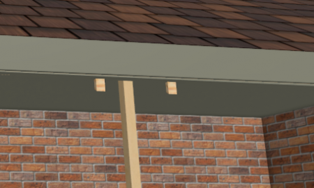

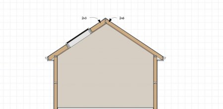

JohnEisenbraun Posted February 19 Author Share Posted February 19 Rafter depth changes at the walls of the foyer. That's the only area where the vaulted ceiling is. I thought of a solution... 1) Create the roof with 2X8s rafters over the entire side of the roof. 2) Go back and manually edit rafters that aren't in the foyer to be 2X6s. 3) Shorten 2X8 rafter so they won't stick through the facia. 4) Create 2X6 rafter tail in Sketchup and attach to the end of shortened 2X8s. Link to comment Share on other sites More sharing options...
y-g-m-n Posted February 20 Share Posted February 20 or make them all 2x6 and then add ceiling plan in vaulted room to bring ceiling lower than underside of rafters. This does not make sense - is this vaulted room outside Hip wall inline and same ceiling top plate height? Something has to be lower or higher, Not sure how you can have the same top plate height, ridge height, roof pitch, overhang, soffit face height, etc With different roof Rafter lumber sizes. Something has to give as that 7.25" versus 5.5" rafter difference has to be somewhere... PS most rafters are made from 2x10 in my area and supported in attic to keep free span to spec. Link to comment Share on other sites More sharing options...
JohnEisenbraun Posted February 20 Author Share Posted February 20 >Something has to give as that 7.25" versus 5.5" rafter difference has to be somewhere.. It's in the birdsmouth cut - it's deeper in the 2X8 vs the 2X6 and then the rafter tail is trimmed down to 2X6 size. Link to comment Share on other sites More sharing options...
