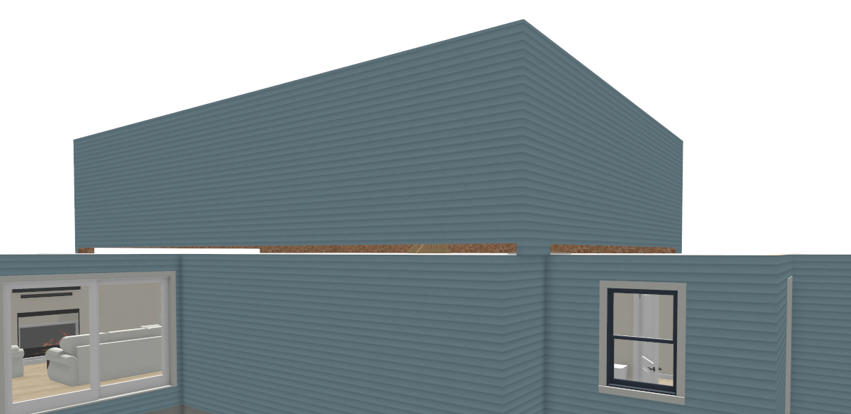

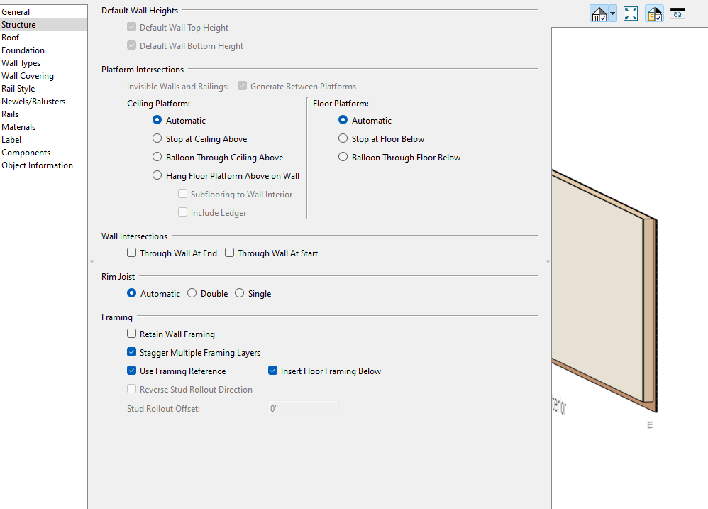

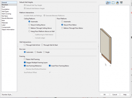

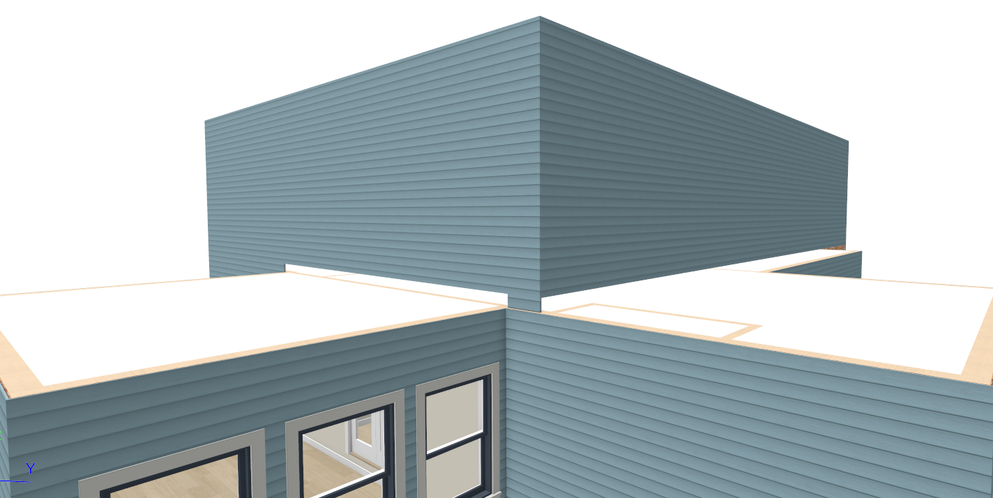

BobRoll Posted February 1 Share Posted February 1 I am using Home Designer Pro 2024. The picture below shows my second floor walls. They do not come all the way down to the floor. The siding extends beyond the bottom of the wall (see the second picture). I have checked "stop at floor below" What else can I do to get my walls to sit flush against the floor? Link to comment Share on other sites More sharing options...
Rookie65 Posted February 1 Share Posted February 1 Looks like the room is not defined? Make sure all of the perimeter walls are not marked as "no room definition" and "no locate" Link to comment Share on other sites More sharing options...

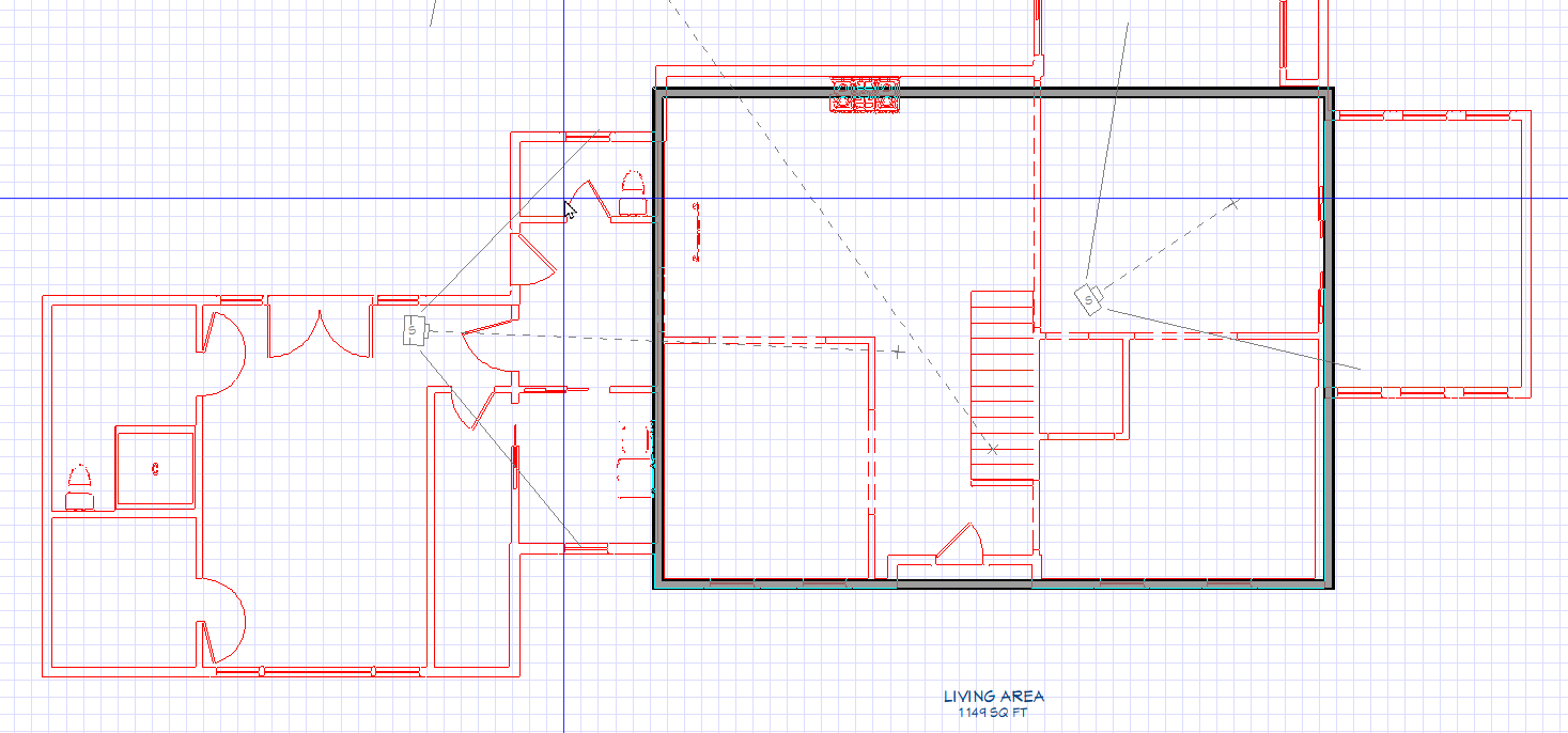

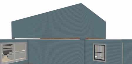

BobRoll Posted February 1 Author Share Posted February 1 I'm not sure where "no room definition" would be. But here is another example. I just drew four exterior walls for my second floor as show below. And all second floor walls show the siding hanging below the wall as shown in the second picture. The third picture shows a gap between the first floor wall and the second floor. Thanks for your help! Link to comment Share on other sites More sharing options...
Rookie65 Posted February 1 Share Posted February 1 Wall Specification>General>Options It also looks like your walls are not aligned with the walls below? Spend some time with the reference manual Link to comment Share on other sites More sharing options...

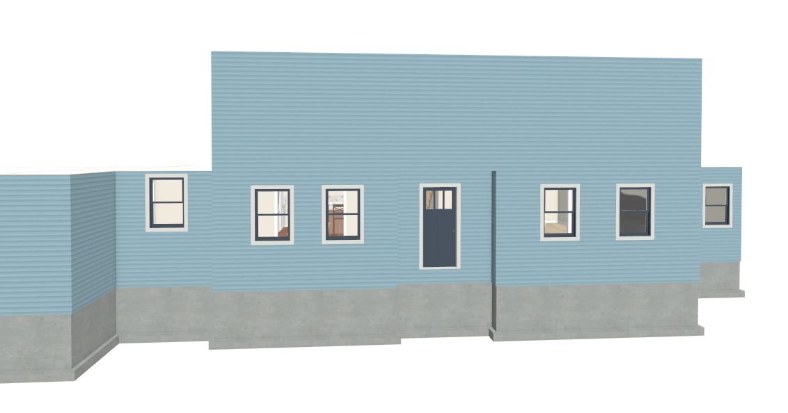

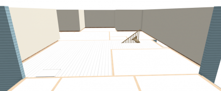

BobRoll Posted February 1 Author Share Posted February 1 Yes, neither no locate or no room definition are checked. Here are two more pics. The first shows the gap when second floor doesn't extend over the first. The second pic shows the front which looks fine. Link to comment Share on other sites More sharing options...
Rookie65 Posted February 1 Share Posted February 1 The pictures do nothing. Try posting your plan and maybe someone will look at it. Link to comment Share on other sites More sharing options...
y-g-m-n Posted February 2 Share Posted February 2 Well the white planes are the ceiling below and the gap between this whit surface and bottom of 2nd walls is where Floor structure would be placed. Joists and plywood or such. You may have them turned off. Also you may be looking at this in 3d while on the 1st floor. See what level you are at. Link to comment Share on other sites More sharing options...
