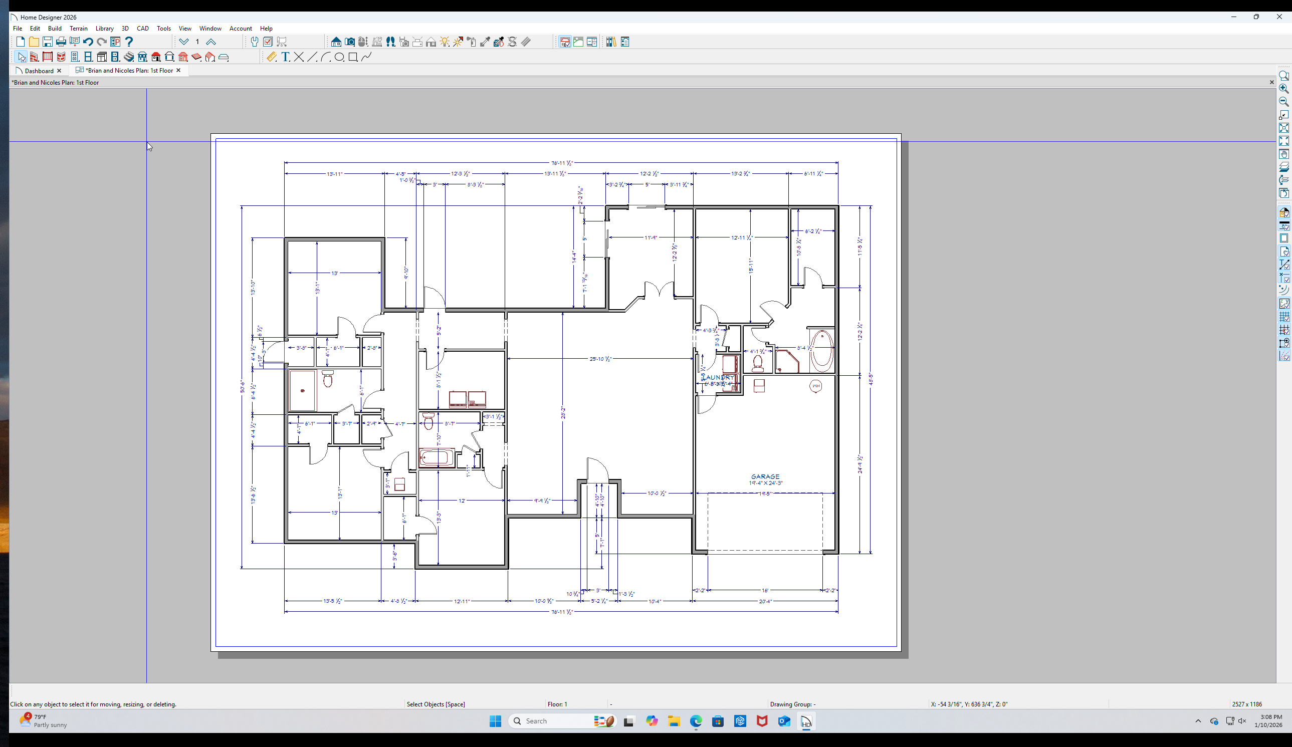

KTBuilder Posted January 10 Author Share Posted January 10 Just adding to my question above, when I go to Print Preview, the walls are shaded like they originally were. Get out of Print Preview and they are no longer shaded. Link to comment Share on other sites More sharing options...

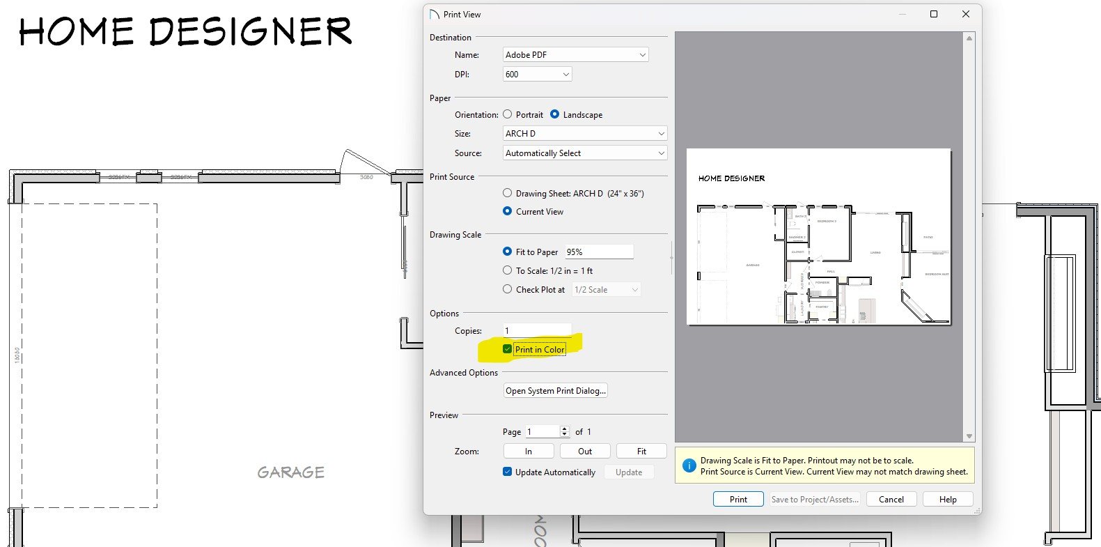

scottharris Posted January 10 Share Posted January 10 Did you check the option to print in color? Link to comment Share on other sites More sharing options...

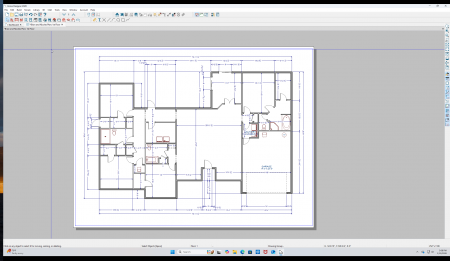

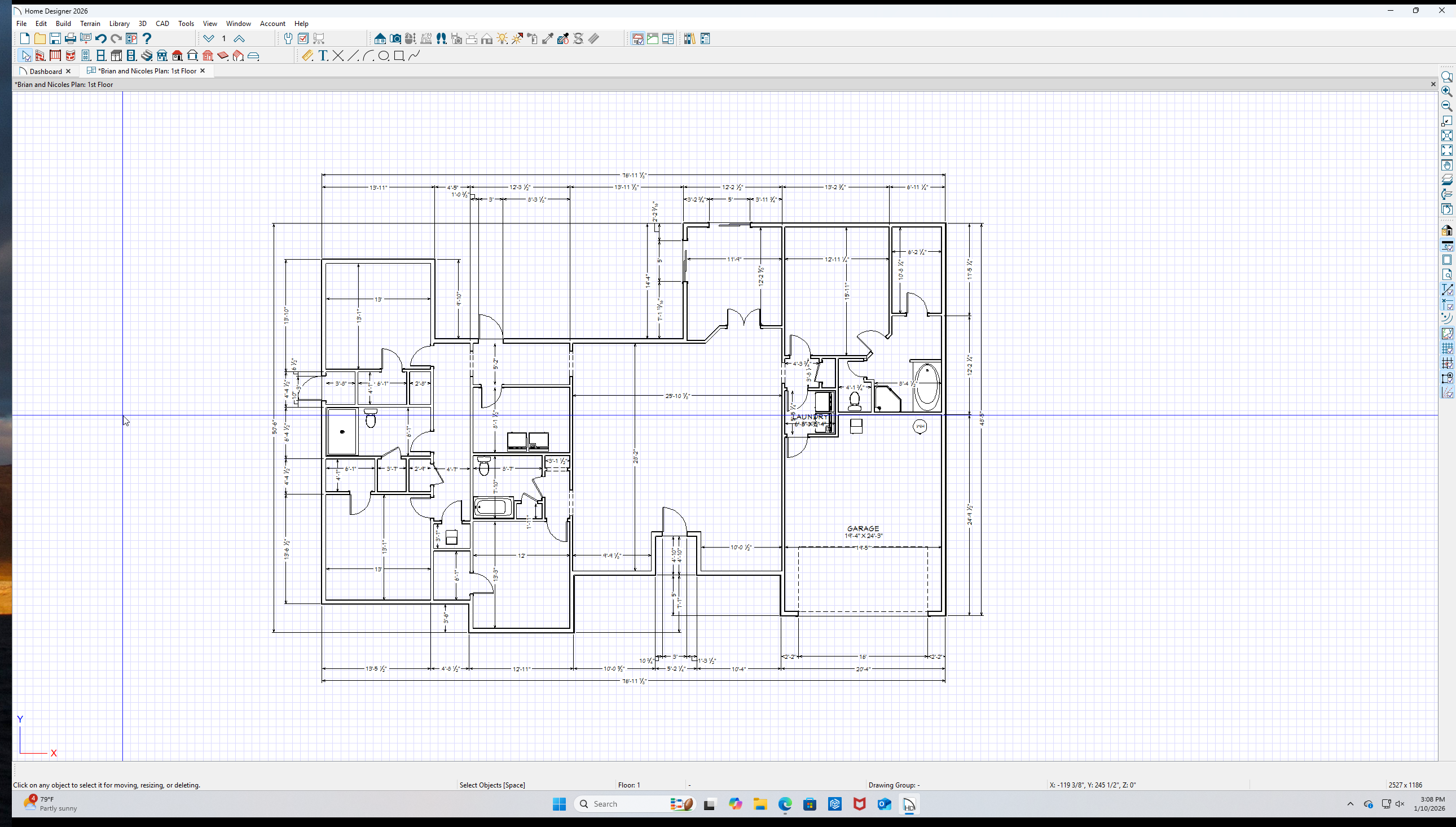

KTBuilder Posted January 10 Author Share Posted January 10 Thanks for the response Scott. It's just the regular Plan when you are designing, that no longer shows shaded walls. (see screen shot). If I go to Print Preview, it shows the shaded walls. (see other screen shot) I'm just trying to get the shaded walls back in standard Plan view. I don't know what I did to make them un-shaded. Any other ideas? Link to comment Share on other sites More sharing options...
Rookie65 Posted January 10 Share Posted January 10 You have "color" turned off in your 1st screen shot, and "on" in the 2nd. Look at the little house image in the right side tool bar. 1 Link to comment Share on other sites More sharing options...
