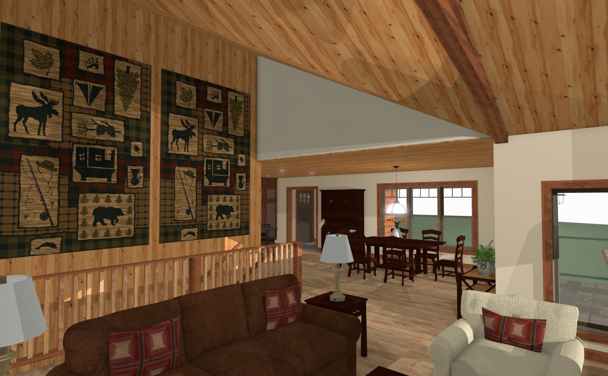

scottb613 Posted December 13, 2025 Share Posted December 13, 2025 Hi Folks, I have two intersecting gables - one is the great room with a vaulted ceiling, and the other is the kitchen and dining room with flat ceilings. How do I get the vaulted portion to continue all the way to the wall with the carpets hung on them - uninterrupted? The ceiling line from the right of the image - to the bottom of the truss - should continue to all the way the wall - eliminating the sheet rocked triangle. Home Designer 2021 Thanks. Regards, Scott Link to comment Share on other sites More sharing options...

y-g-m-n Posted December 14, 2025 Share Posted December 14, 2025 How did you make the vaulted ceiling? Ceiling plane or UNchecked Flat Ceiling? Try ceiling plane as you can force it to do what you want. 1 Link to comment Share on other sites More sharing options...
scottb613 Posted December 14, 2025 Author Share Posted December 14, 2025 7 hours ago, y-g-m-n said: How did you make the vaulted ceiling? Ceiling plane or UNchecked Flat Ceiling? Try ceiling plane as you can force it to do what you want. Hi Folks, I haven't messed with this software in a while - as I only got into this to design my own retirement home. I did use the basic room settings. I'm pretty sure I haven't used ceiling planes before - let me do some research and see if I can figure them out. Do they work in the basic Home Designer Suite? Thank you kindly. Regards, Scott Link to comment Share on other sites More sharing options...
scottb613 Posted December 14, 2025 Author Share Posted December 14, 2025 Hi Folks, Crap - there are no ceiling planes in the basic suite - at least from what I can gather. My only alternative might be to hobble something together in Blender and import it - I've done that before for other custom objects, but it is truly a PITA getting things to line up. Regards, Scott Link to comment Share on other sites More sharing options...
y-g-m-n Posted December 15, 2025 Share Posted December 15, 2025 yup basic does not have custom ceiling planes Pro does. Link to comment Share on other sites More sharing options...
