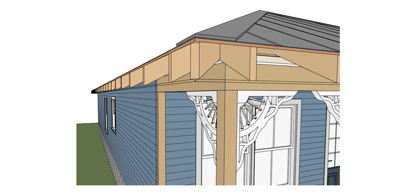

MississippiMims Posted July 13, 2025 Share Posted July 13, 2025 I have searched the content and can't find solutions to these three problems. I would like exposed rafter tails in this model and have been able to accomplish that thanks to some reference guides. One image shows the model the way the program frames the eaves. The problems I cannot find solutions to are: A) I want the rafter with a birdsmouth cut that sits down over the top plate. B} I would like to have a shingle strip at the top of the rafter tail. C) I would like for the siding to extend to the roof decking. Can anyone offer some help? Link to comment Share on other sites More sharing options...
MississippiMims Posted 16 hours ago Author Share Posted 16 hours ago I'm still having the same problems as above. This, however, is a new project and I have changed the soffit material to "no material". Why do I still have a line at the bottom of the rafter tails? It shows up in my elevation views as well; which is a problem when I am building layouts for final construction drawings. I also tried turning off ceiling planes but it doesn't get rid of it. Any suggestions? Link to comment Share on other sites More sharing options...
y-g-m-n Posted 9 hours ago Share Posted 9 hours ago probably because in VECTOR view. Try going into the tools menu and open up LAYER DISPLAY OPTIONS: Then turn off: ROOF OVERHANG and other Roof items you donot have nor want to see. Link to comment Share on other sites More sharing options...
