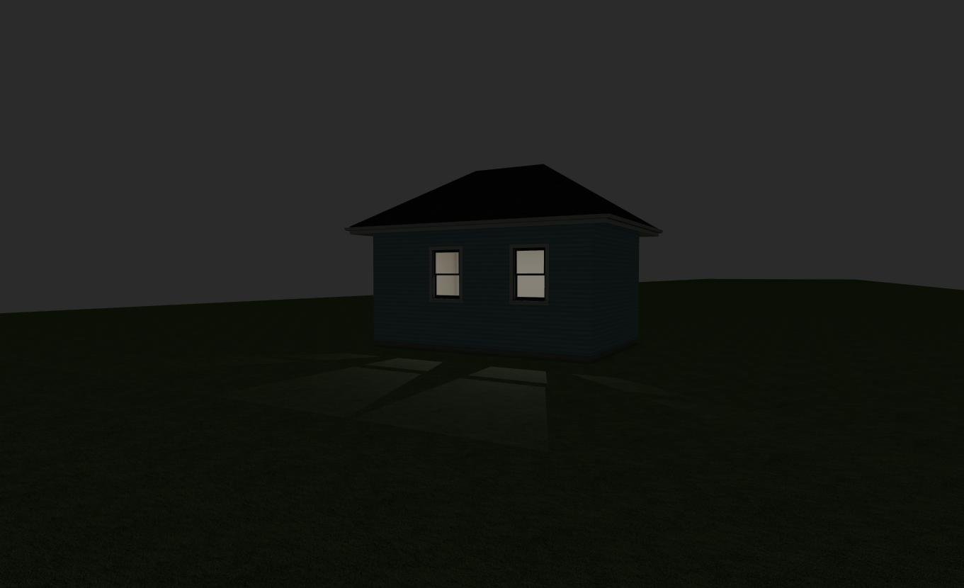

Erichk1 Posted July 13, 2025 Share Posted July 13, 2025 I am trying to create a night scene to see my drawing in 3D at night. I went to the Home Designer Pro Support page and it gave me information on editing the active camera. It says to "uncheck sunlight." When I go to my edit active camera, on my program, I do not have the option to "uncheck sunlight." I am including two screen shots below showing the support page, and my screen. Any help would be greatly appreciated. Erich Kaiser Home Designer Pro 2022 Build 23.4.1.80 SX MAC OS Monterey 12.7.6 4GHZ Quad Core Memory 32GB 1867 MHz DDR3 Graphics AMD Radeon M395X 4 GB Link to comment Share on other sites More sharing options...

ConnorE Posted July 14, 2025 Share Posted July 14, 2025 On 7/13/2025 at 9:53 AM, Erichk1 said: Why the discrepancy in the Support Instructions and my program? I did it years ago with the same program and now it doesn't seem to work. I was able to get close to the image you posted with these steps: 3D > Rendering Techniques > Physically Based 3D > Lighting > Toggle Sunlight - Off 3D > Edit Active Camera > Backdrop Panel Remove Backdrop Change Background Color to something dark. Alternatively, you could probably use a specific dark backdrop instead of using the solid Background Color. You can also lower the brightness in the PBR settings if you want it to look darker. As Rookie65 mentioned, you are using an older version of Home Designer, and the support article is for the newest version. Link to comment Share on other sites More sharing options...
