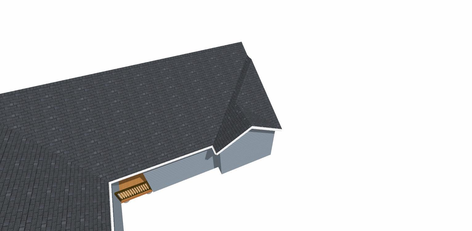

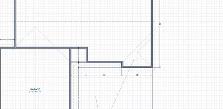

McLaugh417 Posted May 29 Share Posted May 29 Hello all, I have used this program a decent about and I am normally able to figure out how to work around some of the funky stuff the auto rebuild roofs feature does. I have pictures of what I am trying to fix, and I can upload the actual file as well. The thing is I know why (structurally) it is trying to generate it the way it does, but in the real world the small gable in question would just be an overframe. If anyone has any fixes (im sure they are out there) please let me know. Also this is home designer suite 2017 if that helps. roofissuefile.dxf Link to comment Share on other sites More sharing options...

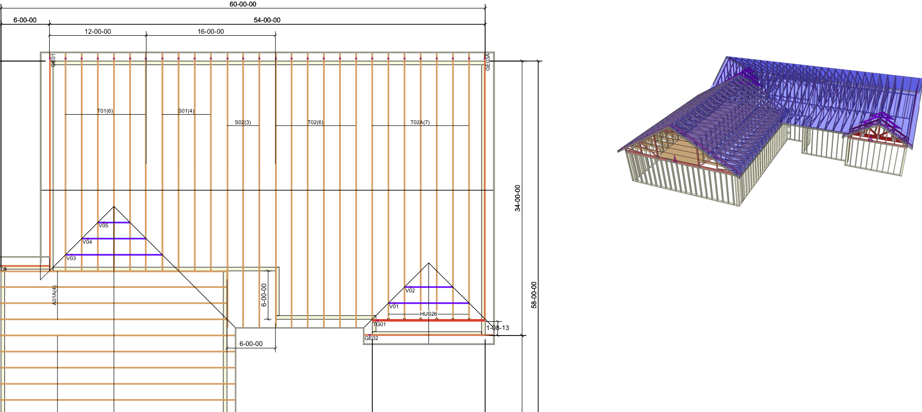

McLaugh417 Posted May 29 Author Share Posted May 29 Here is the actual truss layout of the house I am trying to draw. Link to comment Share on other sites More sharing options...

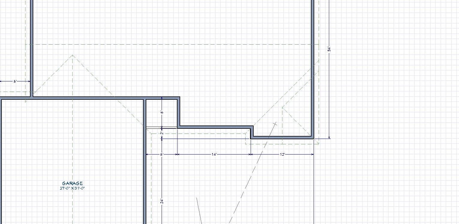

McLaugh417 Posted May 29 Author Share Posted May 29 Also another tid bit of information. It seems as though the program is not building the ridge at the center of the building along the 34' side (right side). The ridge is at 16' from the back. Should be at 17' if equal pitch which it is supposed to be. Link to comment Share on other sites More sharing options...
y-g-m-n Posted May 30 Share Posted May 30 too old software for me as I forget what it would let you do or not. If my project I would just edit roof planes manually. Link to comment Share on other sites More sharing options...
