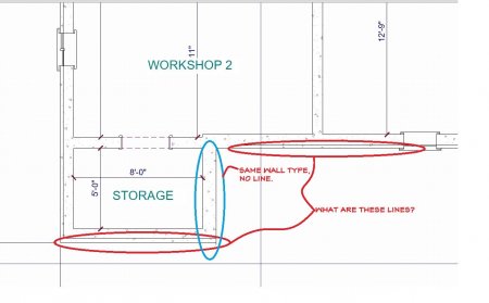

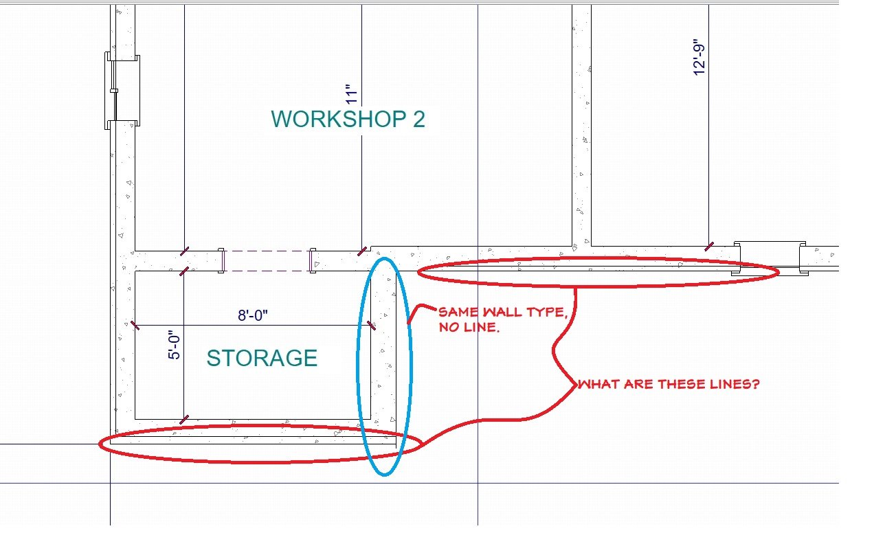

GLOBE-Res Posted January 10 Share Posted January 10 FOR SOME REASON SIMILAR WALLS HAVE AN ADDITIONAL LINE. WHY? WHAT IS THE ADDITIONAL LINE? Link to comment Share on other sites More sharing options...
y-g-m-n Posted January 11 Share Posted January 11 that looks like foundation wall so it could be brick ledge of some sort. Link to comment Share on other sites More sharing options...
GLOBE-Res Posted January 11 Author Share Posted January 11 LOL ok, that narrows it down lol. Nope, it's a foundation wall, no pony wall. Link to comment Share on other sites More sharing options...
GLOBE-Res Posted January 11 Author Share Posted January 11 how do I turn off brick ledge line? Link to comment Share on other sites More sharing options...
GLOBE-Res Posted January 11 Author Share Posted January 11 I understand that it's likely a brick ledge line but I don't want to see the line. Other foundation walls have a brick ledge but they don't have the brick ledge line. WTF!!!!!!!!!!!!!!!!!!!! Link to comment Share on other sites More sharing options...
GLOBE-Res Posted January 11 Author Share Posted January 11 This is crazy. 8 foundation walls are clean. One foundation wall shows a brick ledge. WTH. Someone needs to be able to answer this problem. 1 Link to comment Share on other sites More sharing options...
y-g-m-n Posted January 12 Share Posted January 12 go to tool bar: TOOLS click: DISPLAY OPTIONS Turn off from view BRICK LEDGE LINES They only show up when you have brick on exterior. Not sure why it bugs you since if you have brick they will make a brick ledge to support and get proper drainage. Link to comment Share on other sites More sharing options...
GLOBE-Res Posted January 12 Author Share Posted January 12 Well it bugs me because it's not consistent. The lines show up on some foundation walls but not all foundation walls. When the lines appear on some walls but not all walls it's confusing. And, I don't build foundation walls with a specific brick ledge. I simply but brick at the top of the wall. Link to comment Share on other sites More sharing options...
