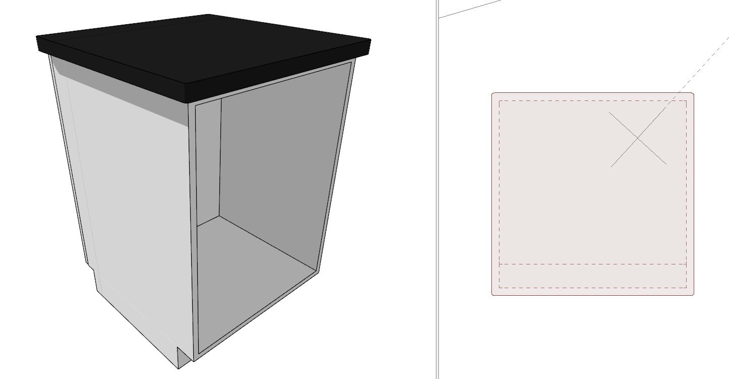

Vikki_WA Posted January 6 Share Posted January 6 Does anyone know how to create a backless cabinet in HD Pro 2025? I normally drag the back of the cabinet partly through the wall behind it, but I now want one with a window behind the cabinet so it can't have a back at all. It sure would be nice if this was a feature of regular cabinet configuration, or if the back could be a separate material. Link to comment Share on other sites More sharing options...
scottharris Posted January 7 Share Posted January 7 You could place two cabinets opposing one another back-to-back. Take one of them, and remove the front face items leaving only an opening. Link to comment Share on other sites More sharing options...
