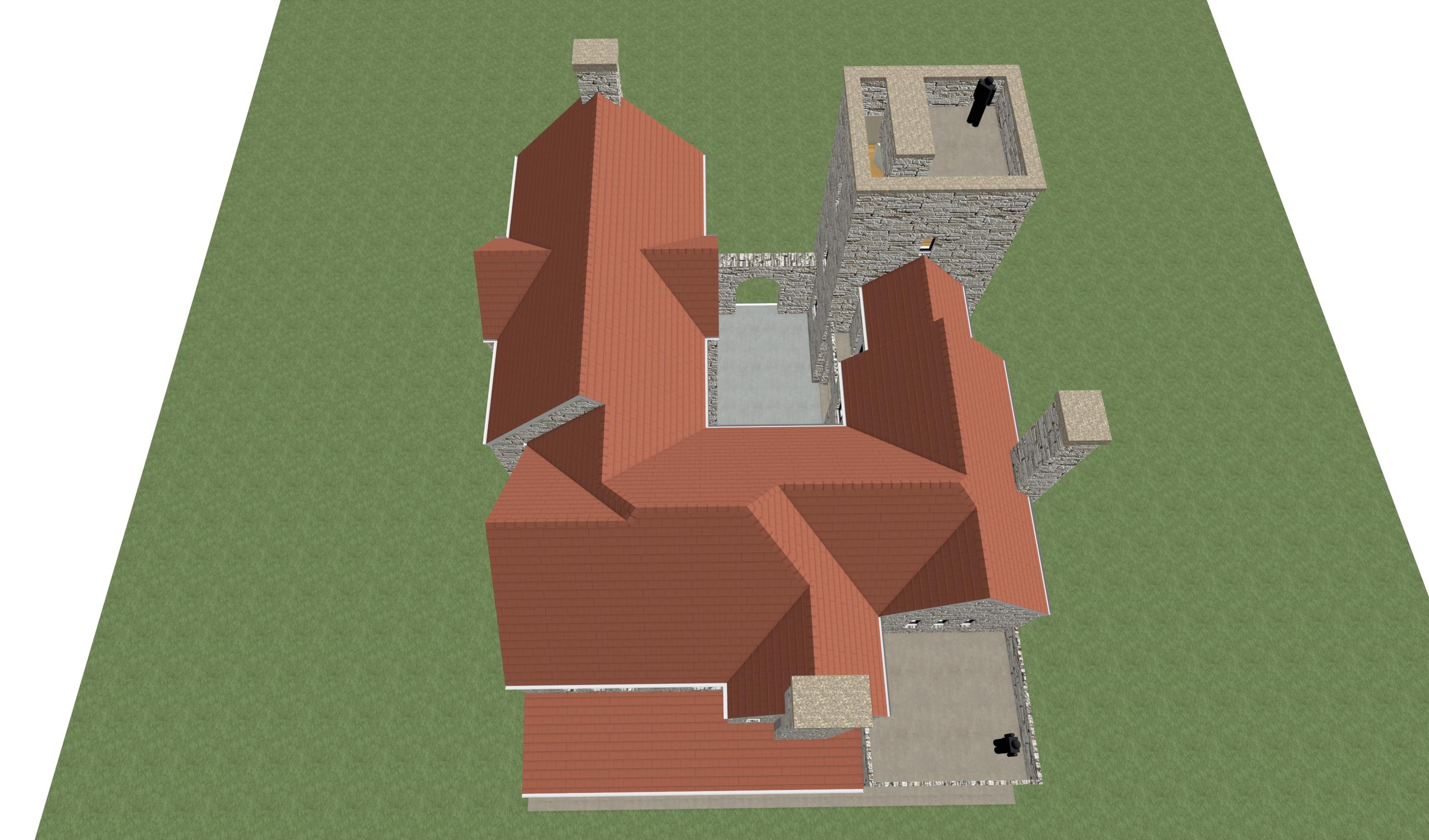

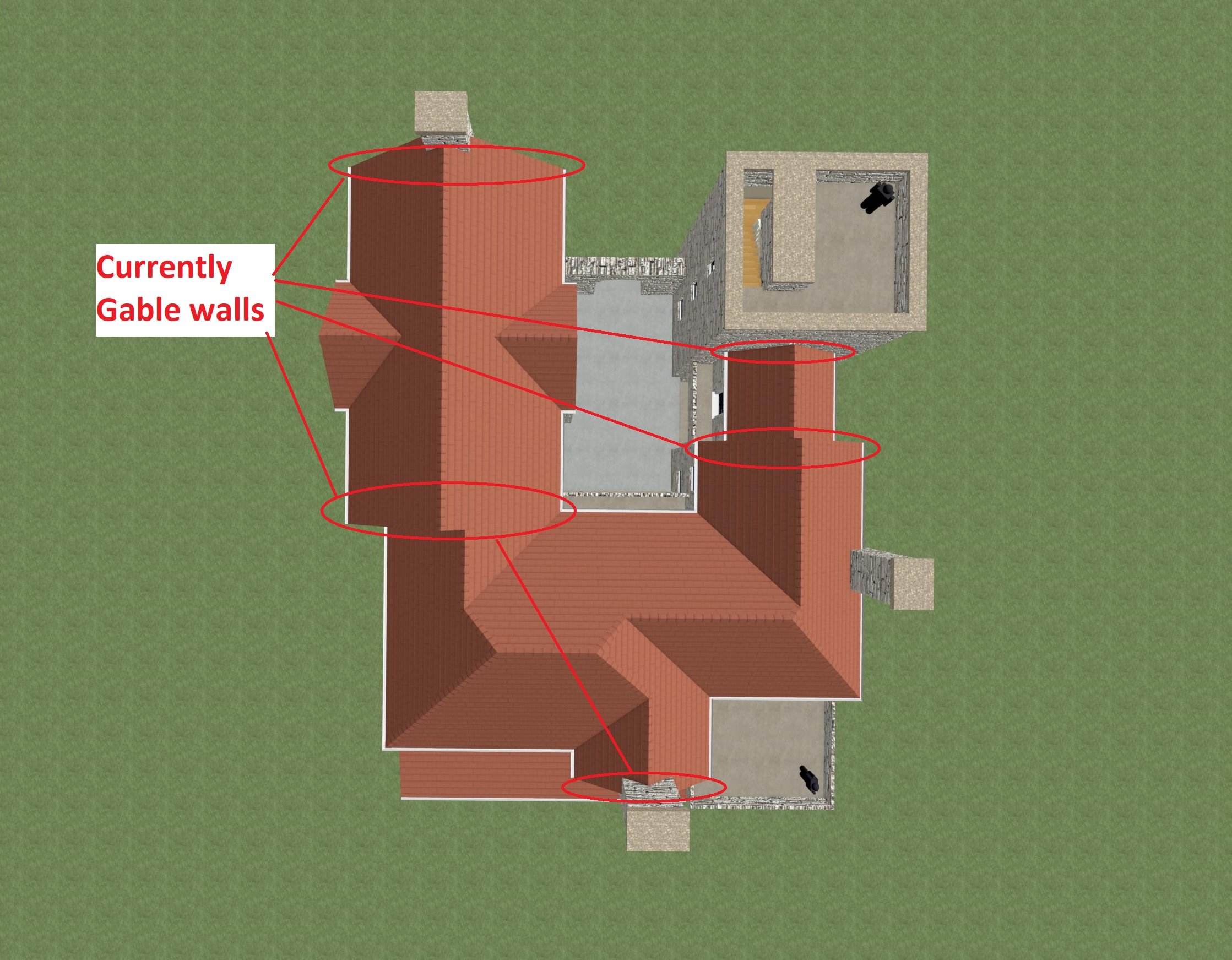

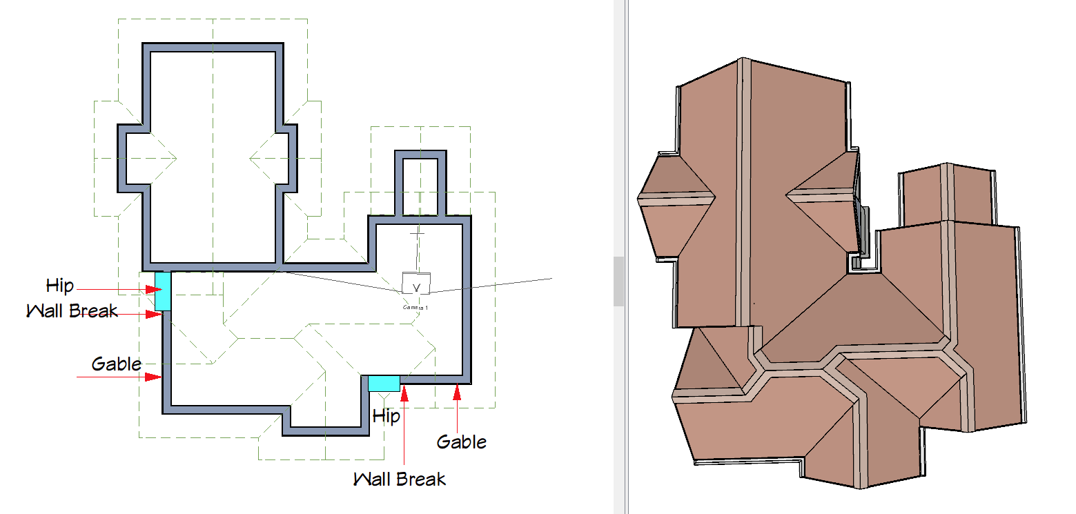

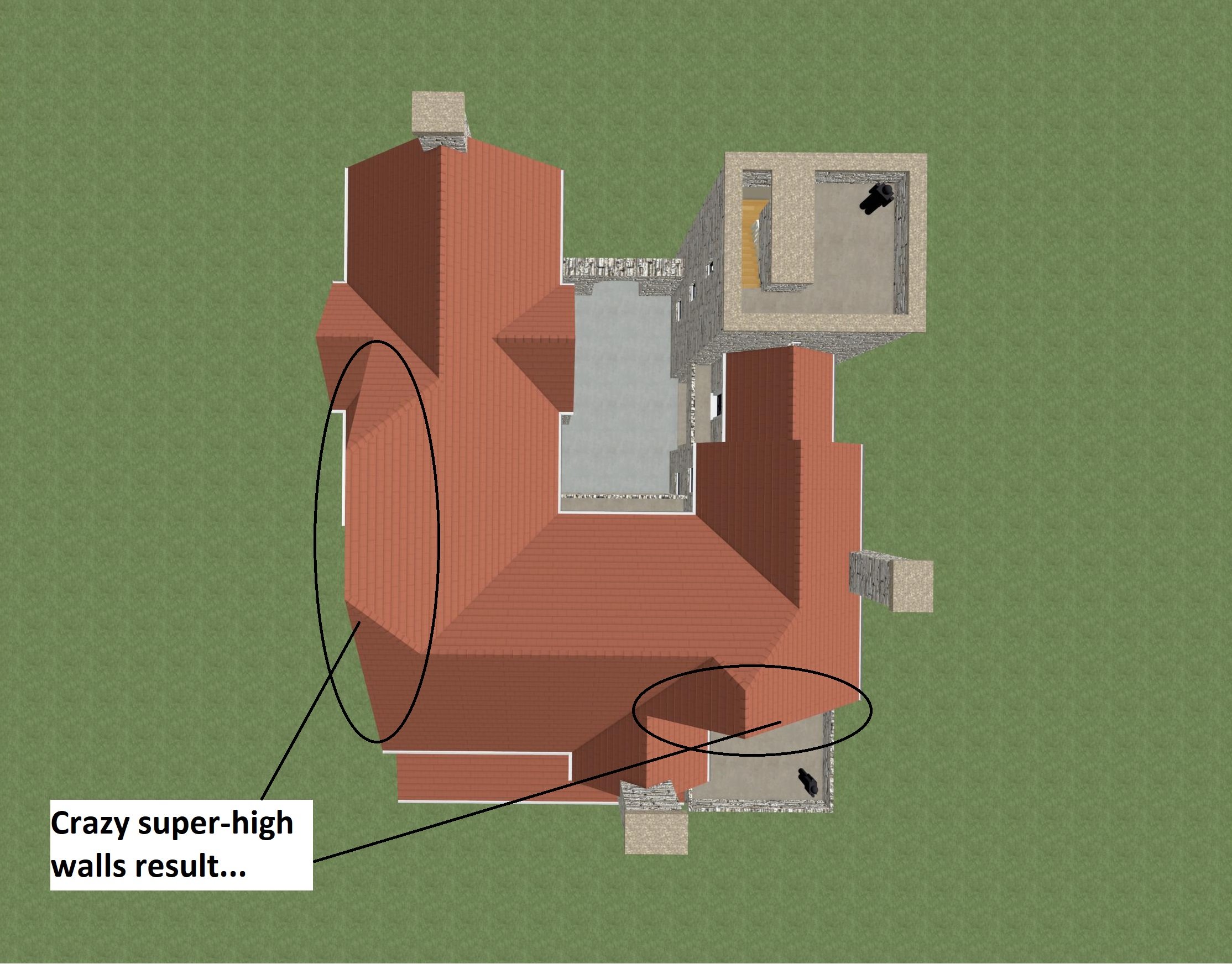

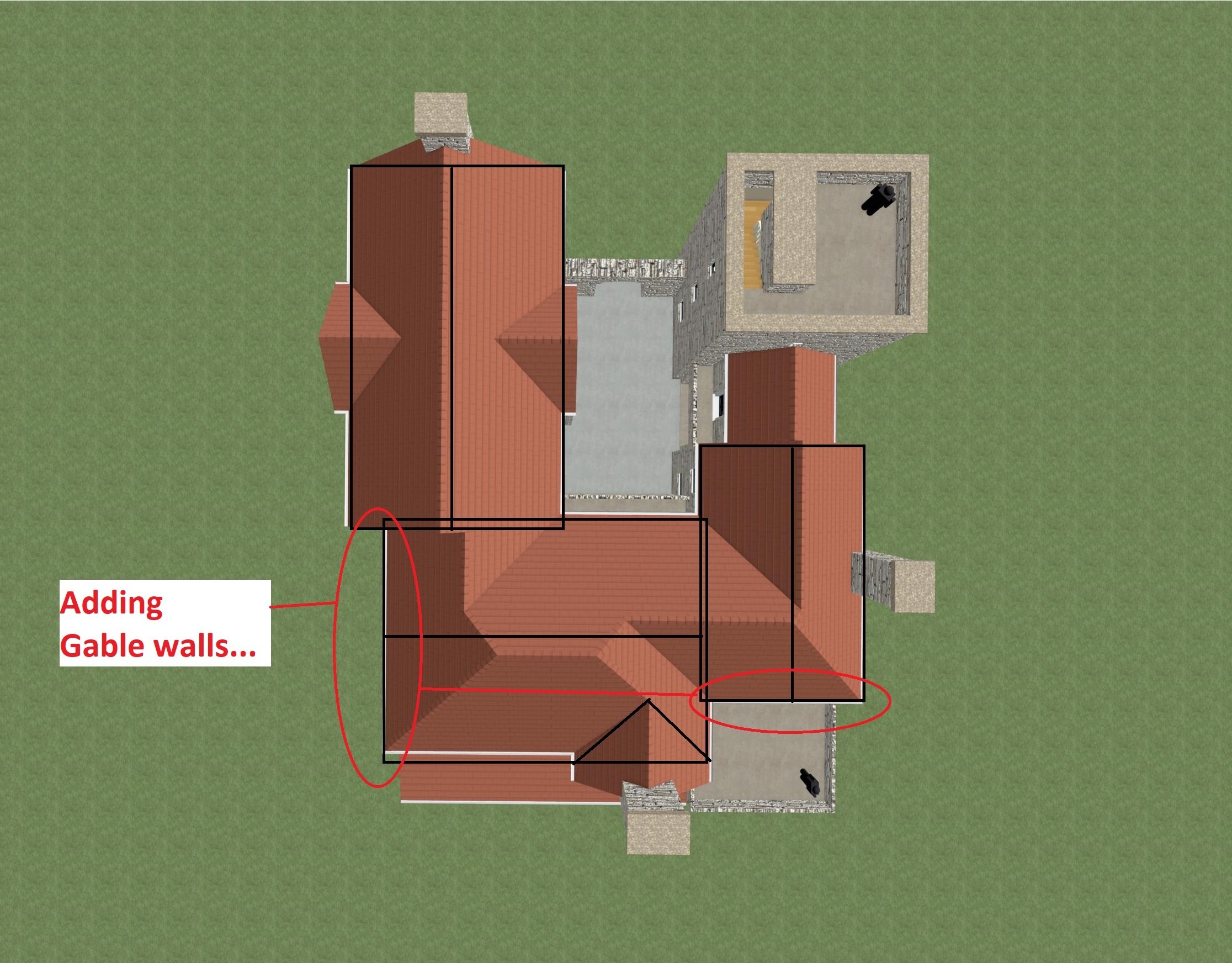

GroverJR Posted October 29, 2025 Share Posted October 29, 2025 I'm trying to get some gable walls for my rooflines but it is giving me very large gable walls which extend into parts of the building which shouldn't happen. I've attached three screen shots. A - shows current gable walls. B - shows (black lines) planned gable walls and peaks C - shows what happens then the planned gable walls are made into gable walls. I've tried all kinds of combinations (even with interior walls) to create the roofline I want, but with no success. Any suggestions? Thanks in advance! Link to comment Share on other sites More sharing options...
Jo_Ann Posted October 29, 2025 Share Posted October 29, 2025 Is this what you want? 1 Link to comment Share on other sites More sharing options...
GroverJR Posted October 29, 2025 Author Share Posted October 29, 2025 I tried that before but I guess I didn't have the wall break close enough to the other walls to create the roof lines I wanted. Now I have it. It's not perfect, but easily close enough. Thanks! Link to comment Share on other sites More sharing options...

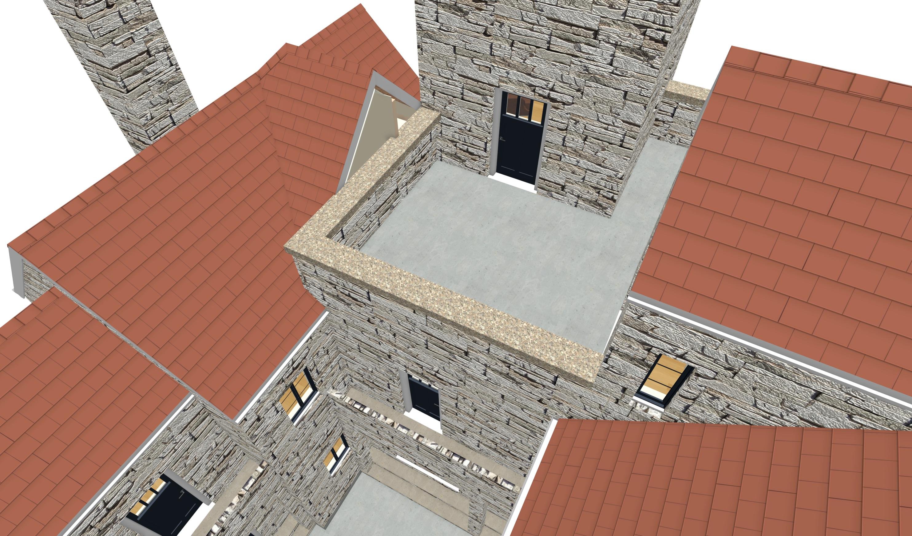

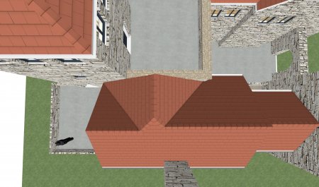

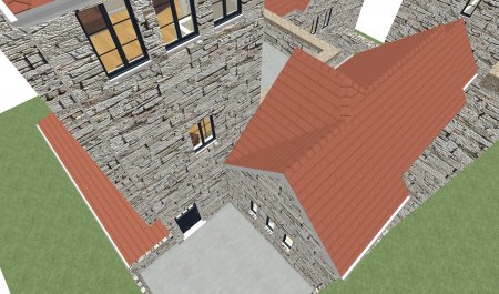

GroverJR Posted November 4, 2025 Author Share Posted November 4, 2025 Update to the plans changed the rooflines and they are ALMOST perfect except this one frackin wall! I have a balcony wall and for some reason the roofline next to it makes a peak to intersect it. I've tried changing the interior-exterior options, removed the gable ends, adjusted every interior wall, etc. but nothing fixes this. It should be a simple roofline with gables at both ends.... Any help? This is the final piece as the layout is 100% done finally, but this roofline issue is driving me nuts. Link to comment Share on other sites More sharing options...
