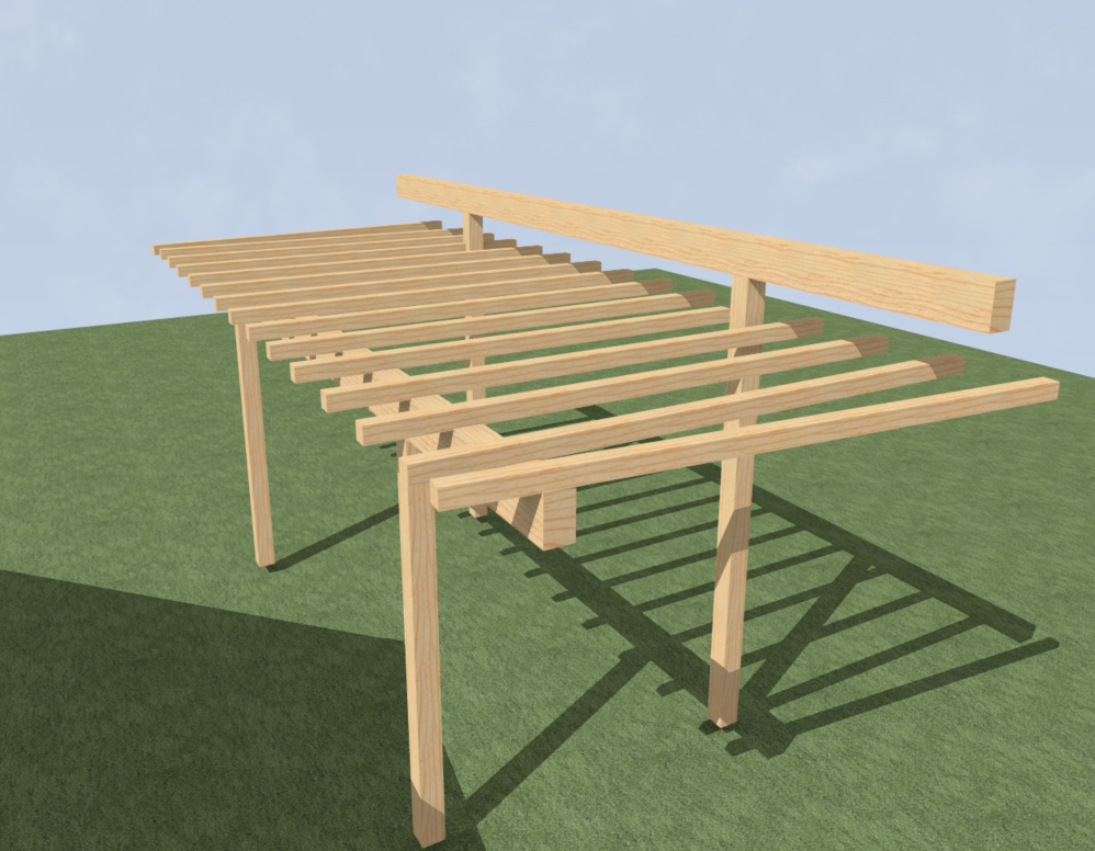

Trueburton Posted October 20, 2025 Share Posted October 20, 2025 I am designing a pergola manually and want them pitched 25 degrees. I am drawing them as a general member and tried drawing as a rafter but it wouldnt allow it without creating a roofplane. Is there an easy way to adjust the pitch on these? Link to comment Share on other sites More sharing options...
y-g-m-n Posted October 21, 2025 Share Posted October 21, 2025 nope as joists are horizontal. Roof rafters can be on slope which come from roof planes. So draw roof plane then adjust material to be OPENING (no material) under core library- Material - Insulation Then the roof disappears but the structure is left behind so rebuild framing. SHould add the rafters in and in the roof plane dialogue you can set their size and spacing. 1 Link to comment Share on other sites More sharing options...
