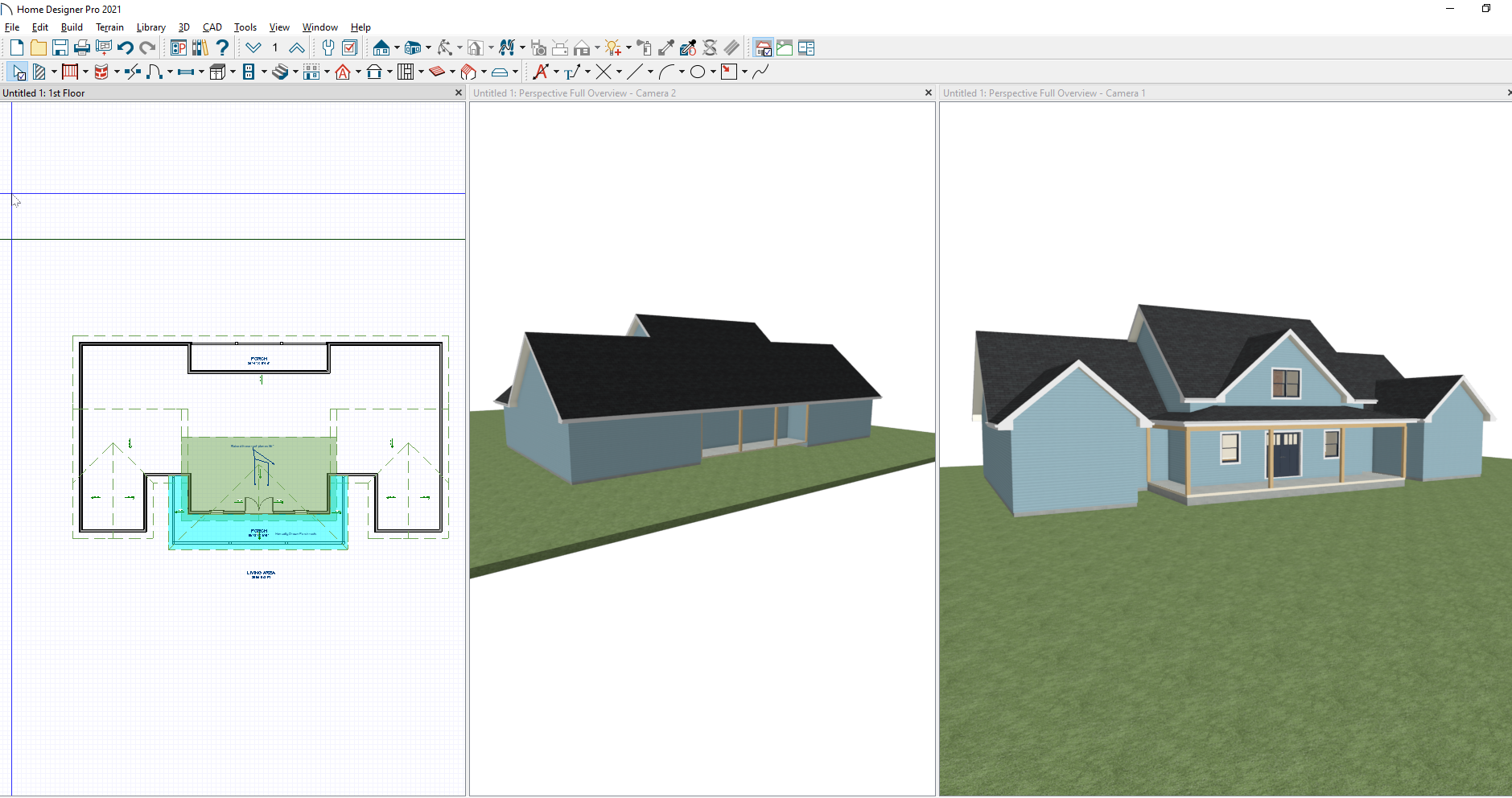

Doug_Morrison Posted October 19 Share Posted October 19 How would I draw this roof line for front of my house in HD Pro 24? This is the view of what it’s supposed to look like from back of the house This is front view that I drew obviously wrong Link to comment Share on other sites More sharing options...

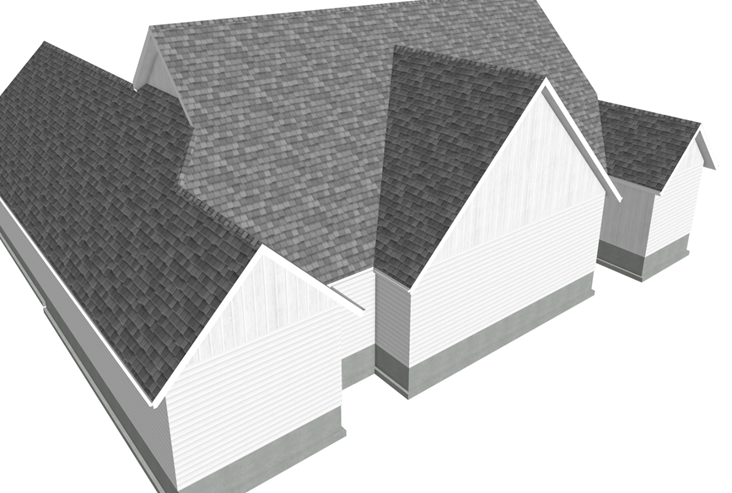

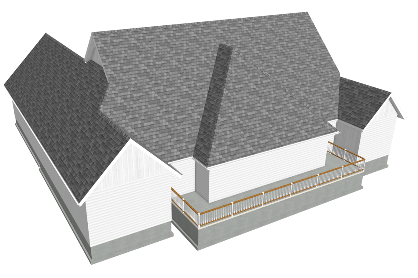

Garybills Posted October 20 Share Posted October 20 Here is one way. I used auto Roofs with the front porch marked no roof. I turned off auto rebuild roofs and raised the middle gable and the middle section of the main roof Planes 36", then built the porch roof on 3/12 pitch. 1 Link to comment Share on other sites More sharing options...
Doug_Morrison Posted October 21 Author Share Posted October 21 I spent the whole evening unsuccessfully trying to figure this out. Learned tons of news things about using the Transform/Replicate tool to move Roof Planes up & down in the Z-axis but can’t figure out how to get away from a hip roof to a shed roof with siding on the side? Link to comment Share on other sites More sharing options...
