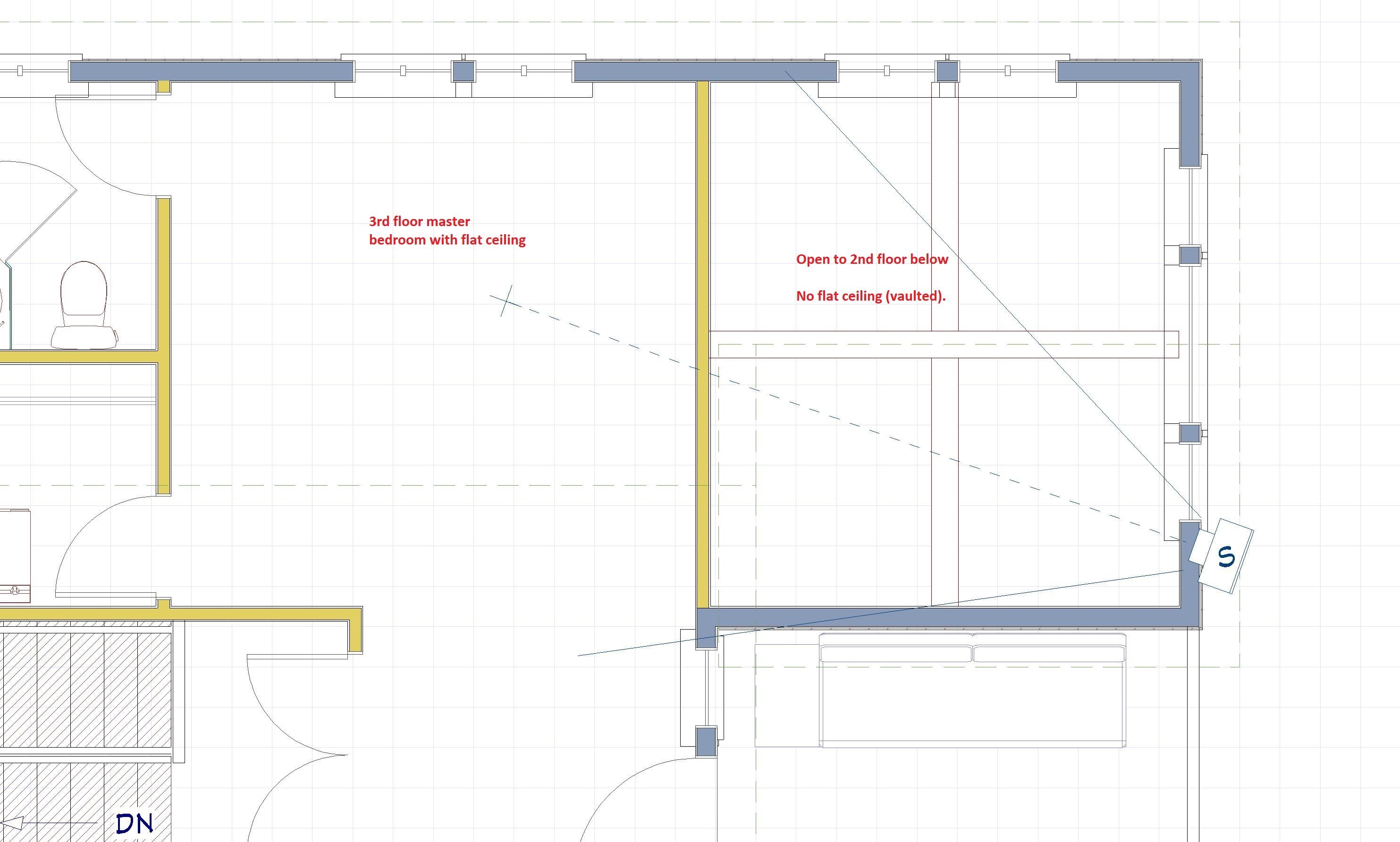

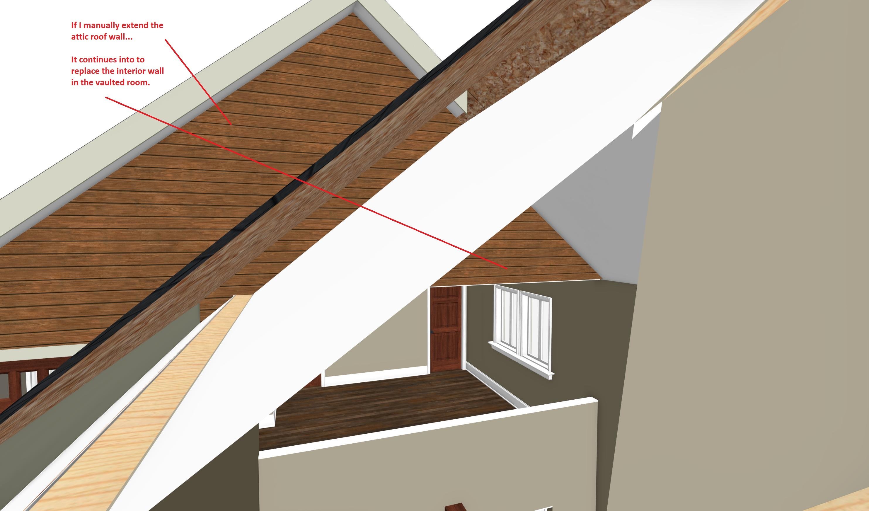

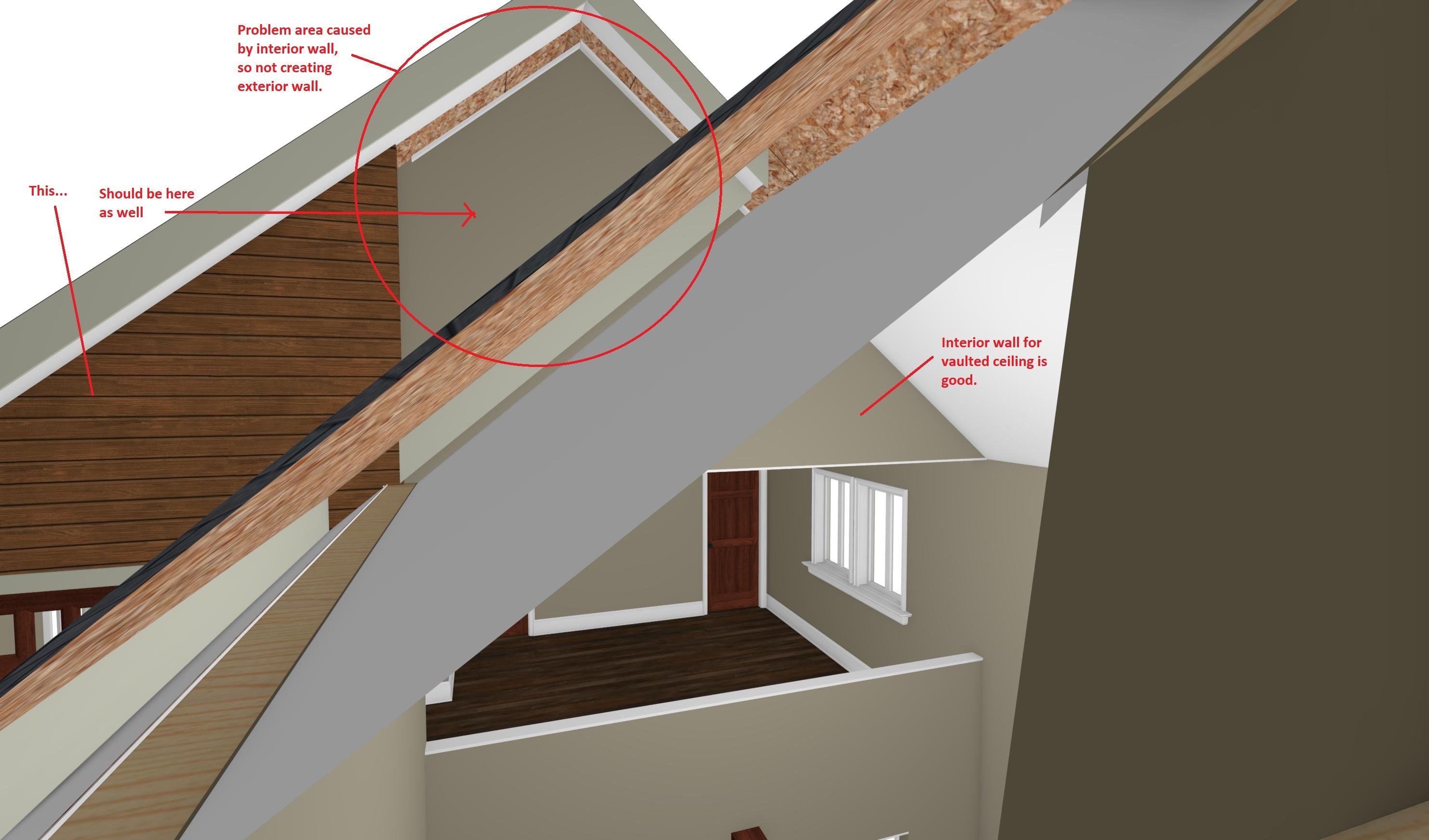

GroverJR Posted Tuesday at 10:19 PM Share Posted Tuesday at 10:19 PM I am using Home Designer Architectural (2020 version). I have an issue that keeps coming up. The attic wall should be exterior to show the siding on the roof walls, but if I manually change the attic wall by extending the exterior wall it replaces the interior wall in the vaulted ceiling room. Any thoughts on how to fix this? I am hoping it is something I am just overlooking. Thanks in advance! Link to comment Share on other sites More sharing options...
Jo_Ann Posted Tuesday at 11:41 PM Share Posted Tuesday at 11:41 PM Architectural does not have the automatic "roof cuts wall at bottom function". So, you need to cover up the interior siding with the "backsplash" tool. Link to comment Share on other sites More sharing options...
