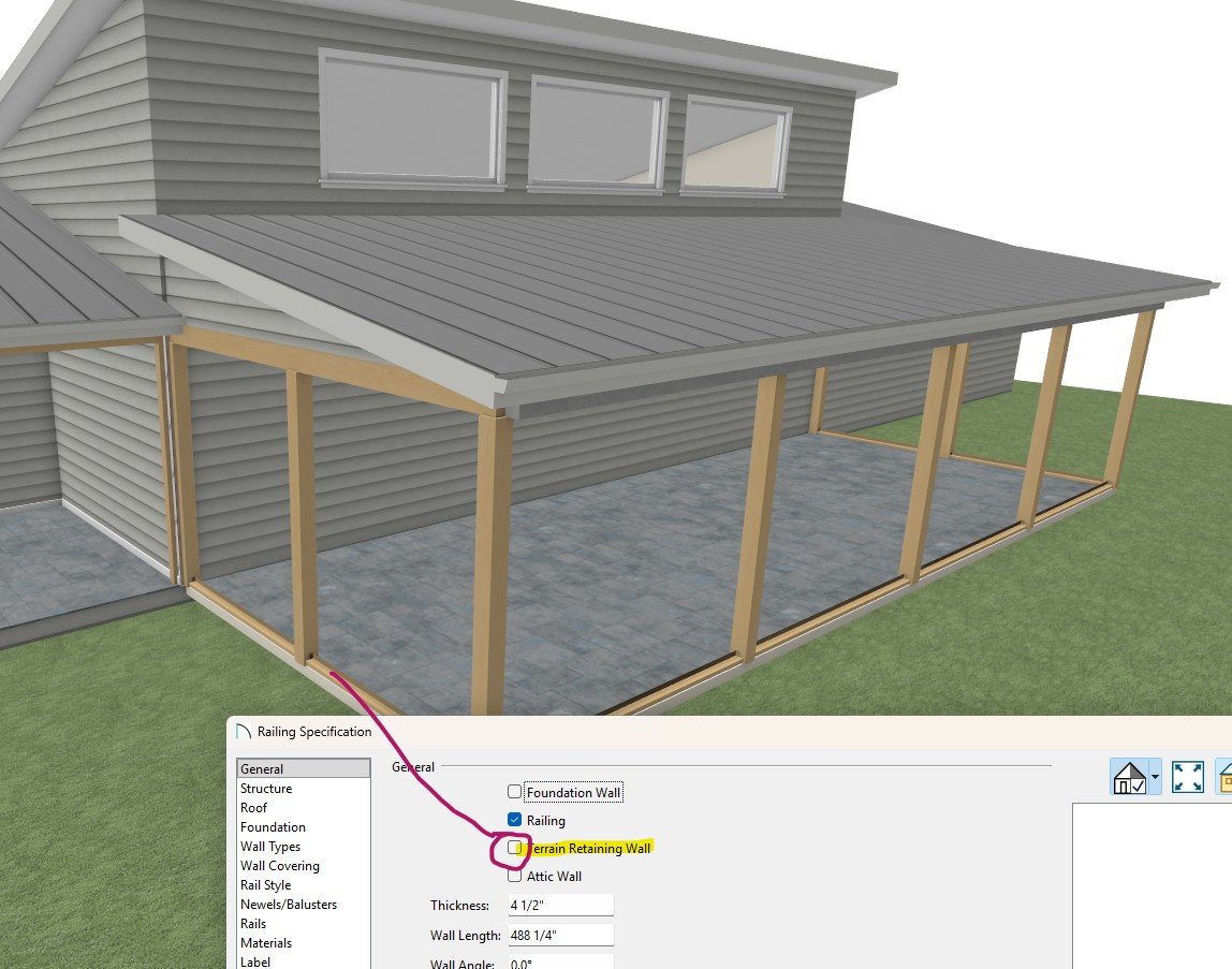

FlyGuy09 Posted September 30 Share Posted September 30 I have a rough house designed and added terrain to the existing plan. When selecting Build Terrain, the porch railings all disappear. Can someone please tell me why this is happening? I am using Home Designer Pro 2025. Link to comment Share on other sites More sharing options...

FlyGuy09 Posted October 1 Author Share Posted October 1 Thanks for your consideration on this. I have attached the plan. If you add a Terrain PerimAttempt 2.planeter around the house, then Build Terrain, you'll see what I'm talking about. All of the Post to Beams disappear but the floors of the porches are still visible. While looking at the plan, perhaps you can also tell me why when adding a window to the sloping attic wall and selecting "Match Roof" for window, nothing happens. Thanks again! Link to comment Share on other sites More sharing options...
scottharris Posted October 1 Share Posted October 1 On your porch railing walls, uncheck the option that they are 'terrain retaining walls' (they are meant to be at the level of the terrain). Link to comment Share on other sites More sharing options...

Solution FlyGuy09 Posted October 3 Author Solution Share Posted October 3 That seemed to work, thank you for the tips. Link to comment Share on other sites More sharing options...
