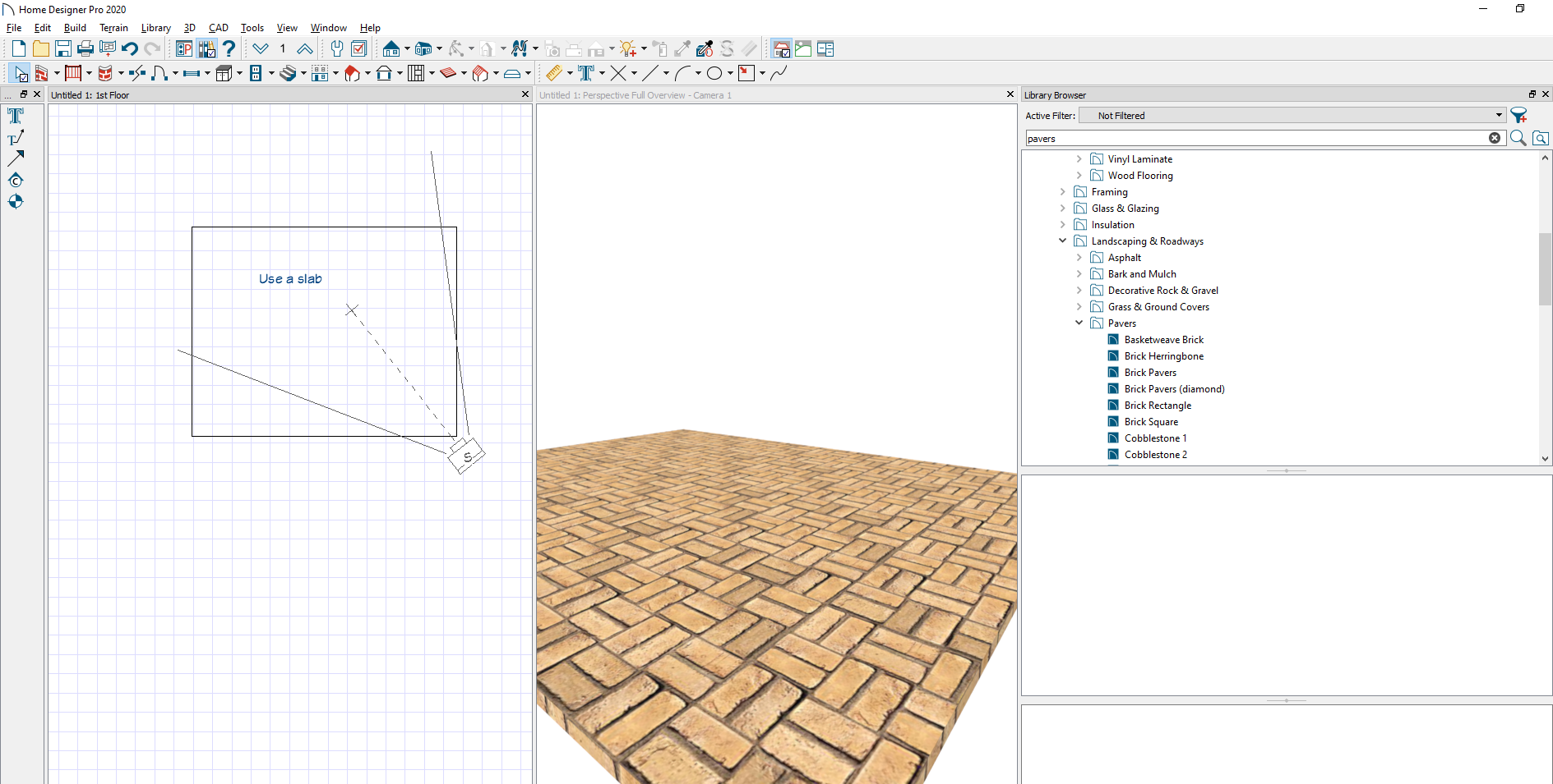

KTBuilder Posted September 24 Share Posted September 24 I'm using Home Designer Pro 2020, and am trying to find a catalog or somewhere in the Library for Concrete Pavers, to use around a patio and pool area. Anybody know where I can find some? Thanks Link to comment Share on other sites More sharing options...
Garybills Posted September 25 Share Posted September 25 There are pavers in the core catalog, use a slab and change the material. Link to comment Share on other sites More sharing options...
KTBuilder Posted September 25 Author Share Posted September 25 Yes, I saw those in the core catalog, but they are all brick and cobblestone. I'm looking for concrete pavers, similar to those manufactured by Belgard. Some have a mix of 3 different sizes to use in various patterns. Link to comment Share on other sites More sharing options...
Garybills Posted September 25 Share Posted September 25 Ok, there is a Mutual Materials catalog that might have something like that but unfortunately the catalogs only go back to HDP 2022. Link to comment Share on other sites More sharing options...
Rookie65 Posted September 25 Share Posted September 25 Or you can read up on creating your own materials for the user catalog. You can copy an image from their website and import that. Set the scale you want it to be at, and you should be good to go. 1 Link to comment Share on other sites More sharing options...
KTBuilder Posted September 26 Author Share Posted September 26 Thanks Rookie. That may be the way I'll have to do it. Link to comment Share on other sites More sharing options...
