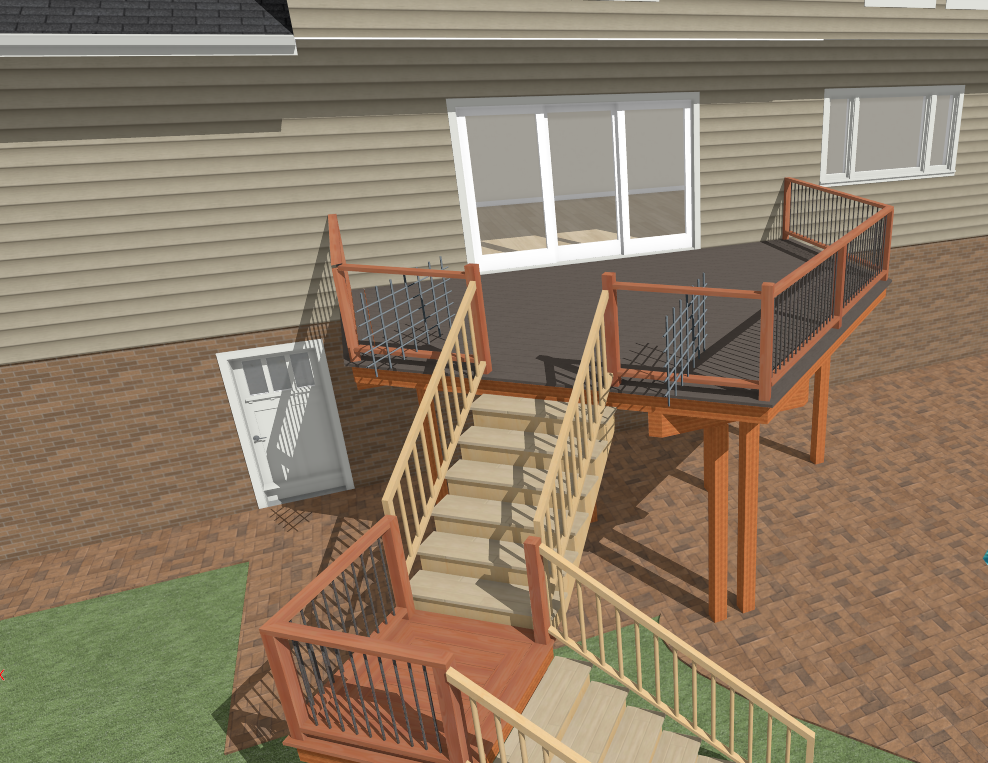

LancasterLinda Posted September 18, 2025 Share Posted September 18, 2025 Hey all! I'm trying to get the Trex Wire Mesh Railing used for the Trex deck I'm drawing for a contractor. The Trex Catalog does not include their railings and the AZEK Building Products Catalog doesn't provide a mesh railing. The closest I've come to is selecting the Baluster type from the Library and choosing Cross Hatch: However, the balusters are at a 90 degree angle. Anyone know how I can turn them or what I can use to create something similar to Trex's Wire Mesh Railing? This is how it's showing up in Plan: Any tricks will be greatly appreciated!! TIA, Linda in Lancaster (Ohio) MSI Laptop Home Designer Pro 2025 Link to comment Share on other sites More sharing options...

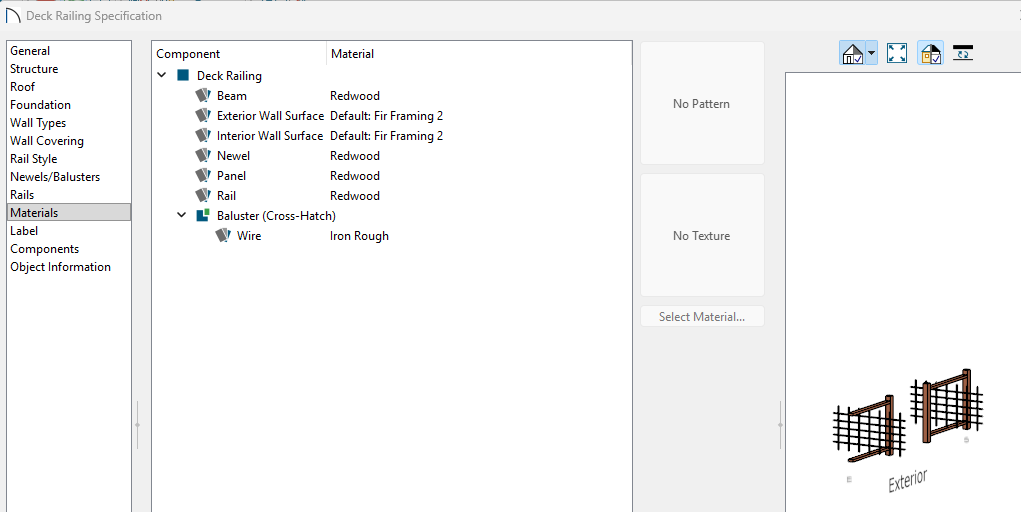

Solution y-g-m-n Posted September 18, 2025 Solution Share Posted September 18, 2025 Change them to PANELS and then change the PANEL material to what you like. click on these and open the edit screen for these "Railing Walls" Go to RAIL tab and at top select PANELS for the railing. Then go to material tab and change the PANEL material to whatever looks like what you want. Check in the bonus stuff for WIRE AND LATTICE plenty in there that may be close to what you need. OR find a picture file and edit a material to have it. 1 Link to comment Share on other sites More sharing options...

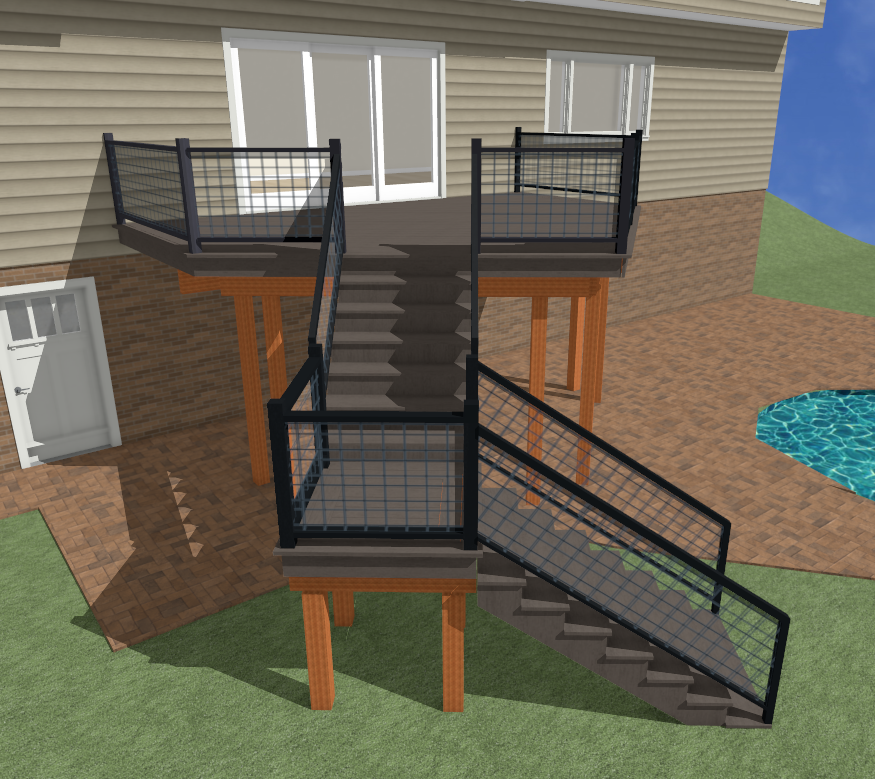

LancasterLinda Posted September 22, 2025 Author Share Posted September 22, 2025 THANK YOU y-g-m-n!!! It worked. I've used that panel option in the past but it was so long ago I totally forgot about it. You're the Best! Link to comment Share on other sites More sharing options...
