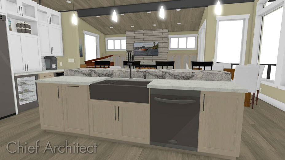

DIYPete Posted August 22 Share Posted August 22 When I place an Apron sink in to an appropriate Base cabinet, and I want the countertop to have an opening there as the edge of the countertop should be over the edges of the sink, the countertop covers the opening. Is this a design flaw? Link to comment Share on other sites More sharing options...
scottharris Posted August 22 Share Posted August 22 You will need to use a custom countertop. See this how-to article https://www.homedesignersoftware.com/support/article/KB-00890/placing-an-apron-sink.html Link to comment Share on other sites More sharing options...
DIYPete Posted August 23 Author Share Posted August 23 (edited) I had already tried that, but it still didn't look right. I believe the issue is that the sink is (true) 30" x 18" x 10" and requires a 33" base cabinet according to the sink specs. I will continue playing with it. Well, the final solution was a custom countertop and fillers on the base cabinet. It doesn't provide an accurate solution to the materials list, but it looks good. Edited August 26 by DIYPete Added final info. Link to comment Share on other sites More sharing options...
Vikki_WA Posted September 8 Share Posted September 8 1st, edit the base cabinet to turn the blank panel or drawer panel at the top of the cabinet into an opening that is high enough (low enough?) to accommodate the height of the sink. Make sure there is nothing above that opening such as a blank area or separation. Make sure to remove any countertop edge moldings from that cabinet as well. This method works well for me. Link to comment Share on other sites More sharing options...
