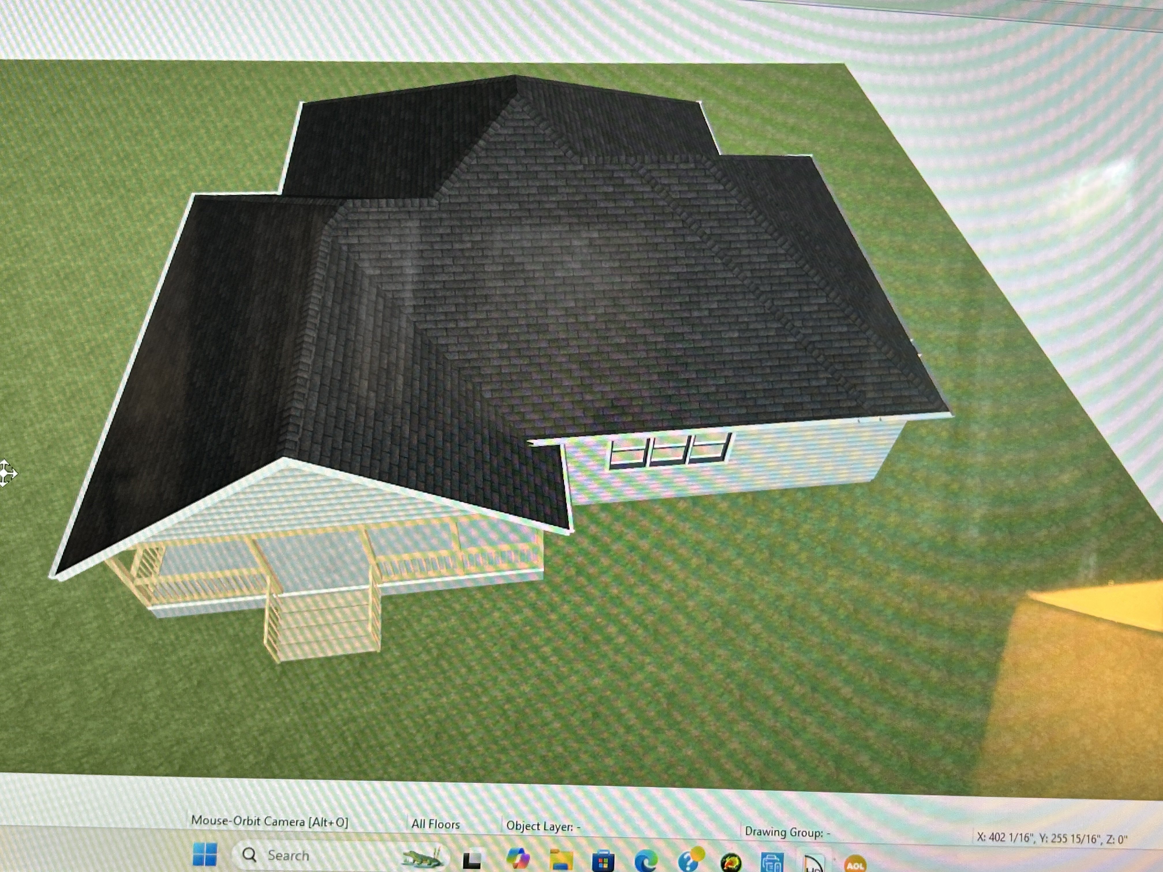

Userjg Posted June 17 Share Posted June 17 I have the home designer architectural software i purchase a couple of months back How do i get vaulted ceilings over my kitchen/Living room area i have tried different roofs etc. but i think it may be in my design. right now i just defaulted back to hip roofs any suggestions thanks Link to comment Share on other sites More sharing options...
Rookie65 Posted June 17 Share Posted June 17 Turn off "flat ceiling over this room" in the room defaults drop down box. Can always look at the reference manual for other solutions to different things. Link to comment Share on other sites More sharing options...
