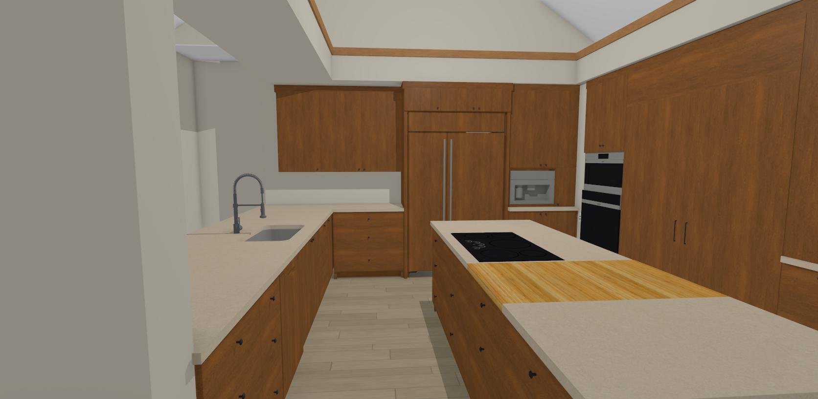

Janetcrouch Posted June 17, 2025 Share Posted June 17, 2025 (edited) I have been having issues with inserting a sink or a cooktop into a custom countertop at the correct height. When I am building an island with a half wall, I need to remove the countertops on the cabinets so that I can draw a custom countertop over the cabinets and half wall with an extension for a bar. But when I insert a sink or cooktop over the appropriate cabinet, it lowers to the height of the cabinet instead of flush with the countertop. I do not see any way to adjust the height from the floor of these items so that they are not below the countertop height. What can I do or what am I doing incorrectly? Edited June 17, 2025 by Janetcrouch added a picture Link to comment Share on other sites More sharing options...
Solution Jo_Ann Posted June 17, 2025 Solution Share Posted June 17, 2025 Hint: "I need to remove the countertops on the cabinets". No, you don't. Link to comment Share on other sites More sharing options...
Janetcrouch Posted June 17, 2025 Author Share Posted June 17, 2025 Do you mean I can draw over the countertop that is already on the cabinets? I think I have tried that before and it raises the height. I will try putting the countertop back on. Link to comment Share on other sites More sharing options...
Janetcrouch Posted June 17, 2025 Author Share Posted June 17, 2025 That worked! I don't know why I have had that problem with the custom countertop being raised to sit on top of the other countertop before, but it's not happening now. Thank you Jo_Ann! Such an easy fix. Link to comment Share on other sites More sharing options...
