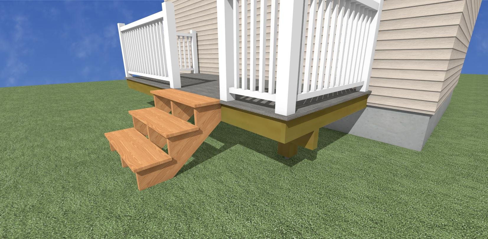

RicBrown Posted February 18 Share Posted February 18 How to draw deck stairs so the first step is even with the deck, 1 Link to comment Share on other sites More sharing options...
y-g-m-n Posted February 18 Share Posted February 18 the top step is one down from top floor/landing review all the stair options screen gives you. Link to comment Share on other sites More sharing options...
RicBrown Posted February 18 Author Share Posted February 18 When building decks we always start the top step even with the deck surface so what I'm asking is how can you raise the stairs so its even at the top of the deck as shown in the picture Link to comment Share on other sites More sharing options...
y-g-m-n Posted February 19 Share Posted February 19 might not be able to in the HD series. Unless try making a landing at the top the sane size as your top step and then the stairs can come off of it... might look right. HD just not setup to build the extra top tread when the top level will suffice... I hate to say it but might be easier in long run to change the way you build them and save some $ on the cost of that last tread Link to comment Share on other sites More sharing options...
Rookie65 Posted February 19 Share Posted February 19 Open your stair specification drop box. Under the "section heights" area, check "top tread" only and set it to "lock top". Then you can adjust the materials, etc. as needed. You should update your signature with the program version and type so everyone knows what you're working with 1 Link to comment Share on other sites More sharing options...
