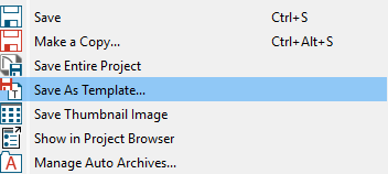

Renerabbitt Posted Thursday at 03:46 AM Share Posted Thursday at 03:46 AM 1 hour ago, ishoultz said: Also, is it possible to change the layout template that HDPro uses? Again, I've just been doing the "Save As" file creation but would rather just have it set. Any help would be greatly appreciated. Thanks in Advance this is a very old video and is modifying the core data files which I would not recommend. HD2025 I believe has the Save As Template option in your file menu. Also your default plan and layout files are set from preferences under the new plan panel Link to comment Share on other sites More sharing options...

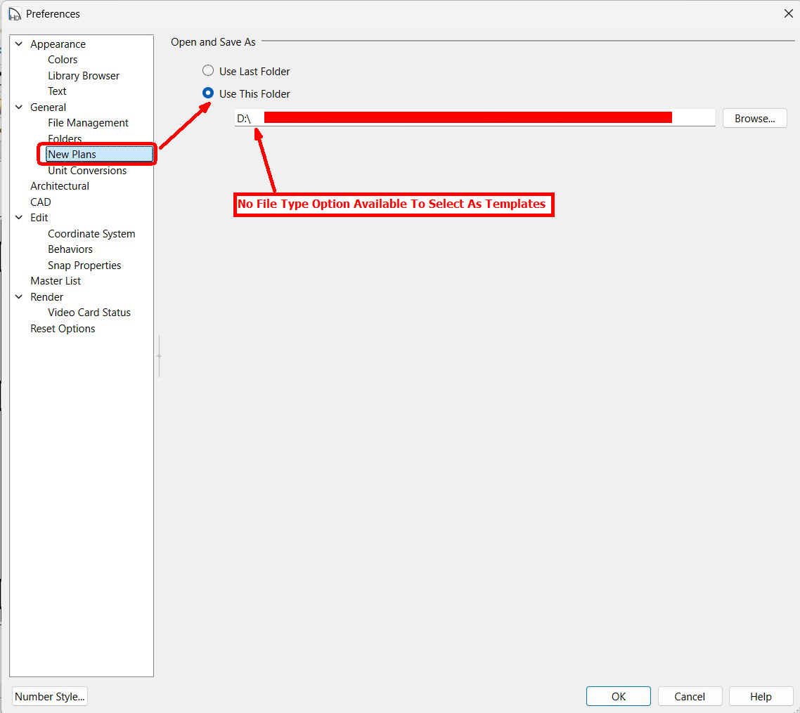

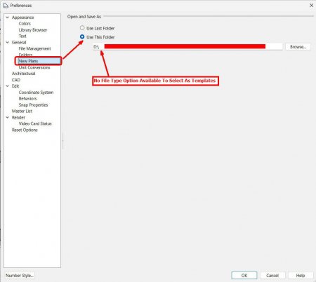

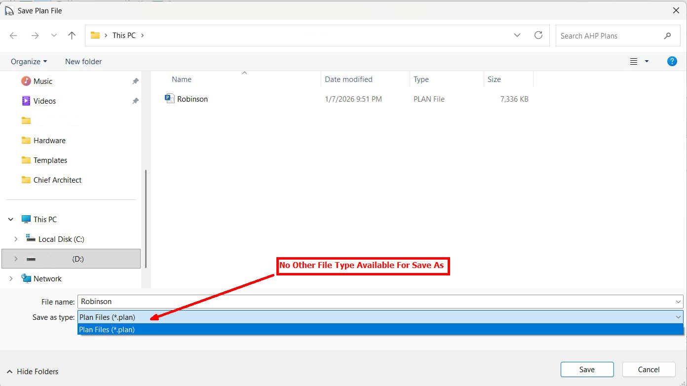

ishoultz Posted Thursday at 04:23 AM Author Share Posted Thursday at 04:23 AM 28 minutes ago, Renerabbitt said: this is a very old video and is modifying the core data files which I would not recommend. HD2025 I believe has the Save As Template option in your file menu. Also your default plan and layout files are set from preferences under the new plan panel @RenerabbittThanks for the attempt at help. I'm not sure if the version I'm using is different, but I don't see the options you are referring to. This is what I see when I try to do a File/Save As I don't see an option to save this as a template file. For the New Plan in Preferences, I only see a location to specify a folder location, not a file type. Not exactly sure what the issue is. As I mentioned, this is Home Designer Pro 2025. Any other thoughts? Link to comment Share on other sites More sharing options...
Renerabbitt Posted 7 hours ago Share Posted 7 hours ago On 1/7/2026 at 8:23 PM, ishoultz said: This is what I see when I try to do a File/Save As It does seem as if these options are not available in HD2025, only HD2026. In that case simply gut a project and for each new project make a copy of your gutted project and start from there Link to comment Share on other sites More sharing options...
