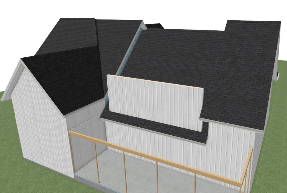

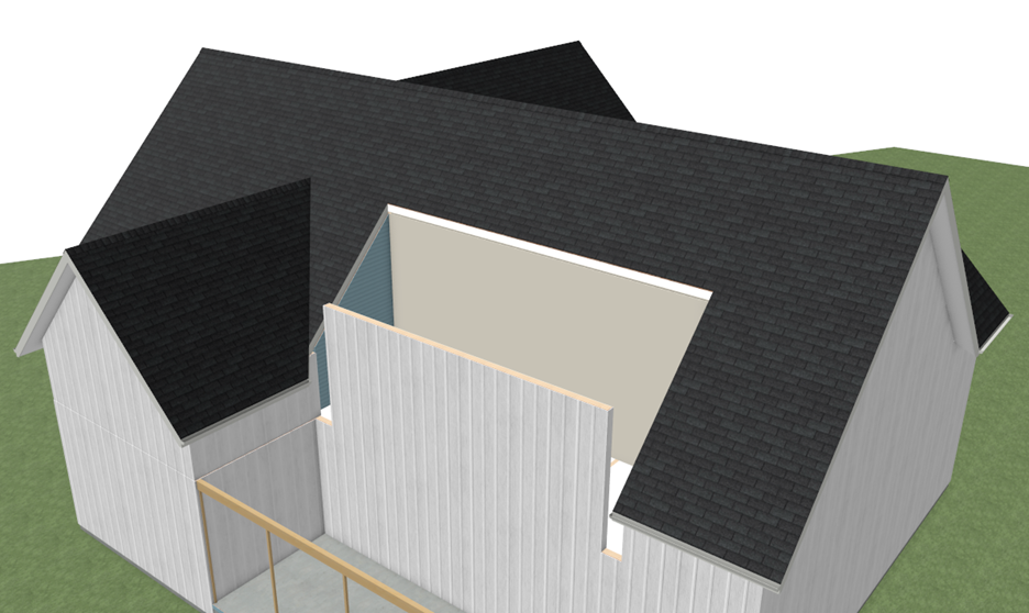

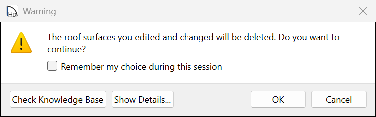

Doug_Morrison Posted November 4, 2025 Share Posted November 4, 2025 Using HD Pro 2024 and struggling to build this shed dormer on back of house. Here’s what it’s supposed to look like. Here’s where I’m at in HD, and software won’t let me build a roof over this room? I get this error and software locks up if I hit OK. I.ve attached the plan file if that helps. Any help building this shed dormer would be appreciated. Thanks in advance! Plan 7877 (r2-ver5).plan Link to comment Share on other sites More sharing options...

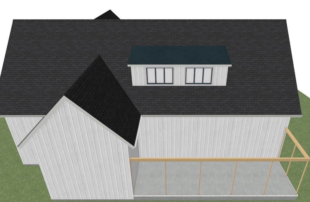

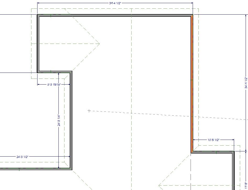

scottharris Posted November 4, 2025 Share Posted November 4, 2025 Doug, here's what I looked at, refer to the images. 1. I turned on the Auto Rebuild Roofs 2. On floor 2, I extended your wall across, so the roof would build symmetrically 3. Placed a shed dormer and adjusted the windows. It's a floating dormer; if you want a structural dormer, which seems likely here, you need to draw walls to connect it (refer to the help system if you need) Link to comment Share on other sites More sharing options...
