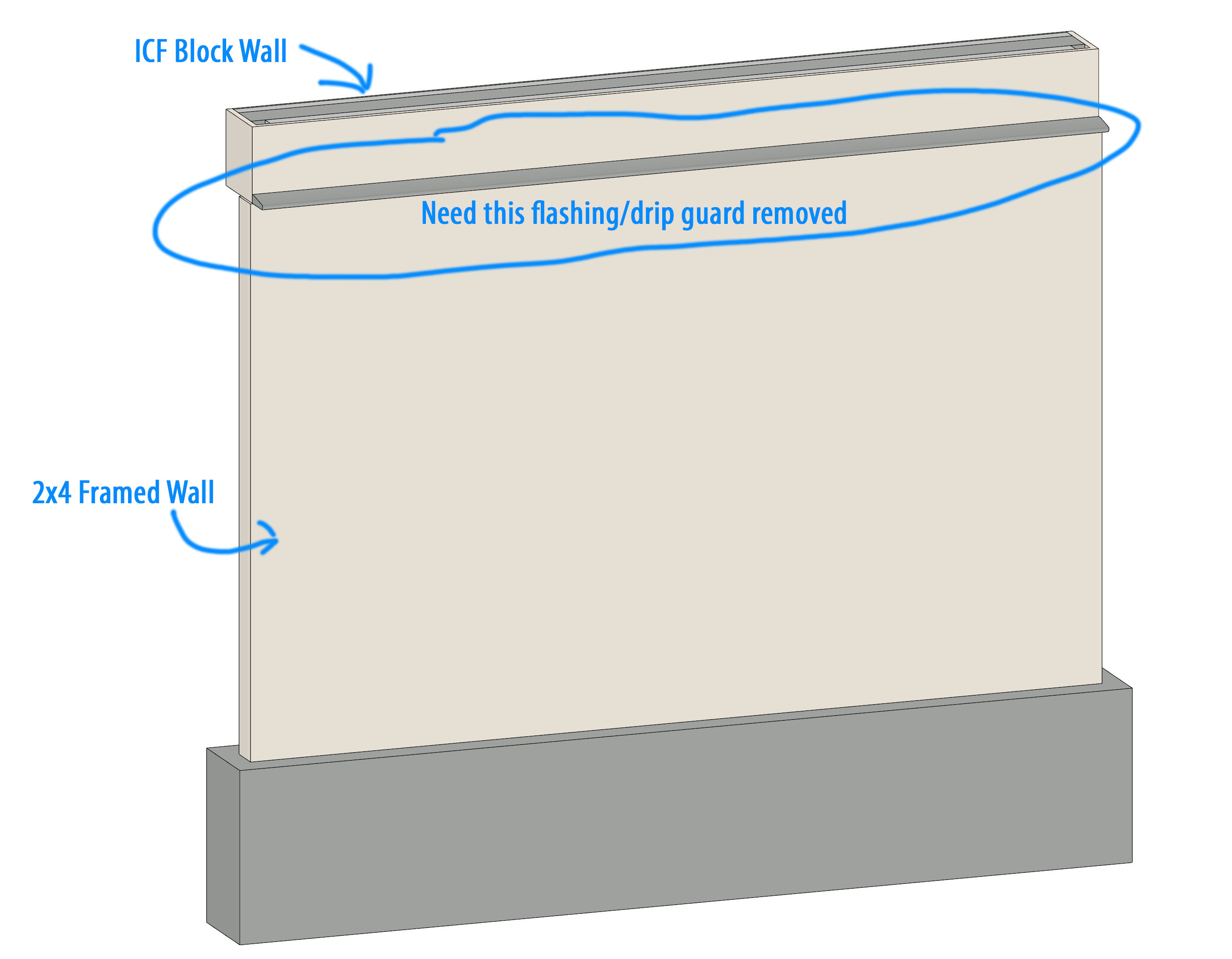

cgrafx Posted November 1, 2025 Share Posted November 1, 2025 I am working with Home Designer Pro 2026 I have 2 story house. The bottom half is ICF block and the upper half is 2x6 engineered. The front doorway of the house is a 2x4 wall built inside an 8ft x 8ft opening in the ICF block. I have not found a way to represent this combined ICF + 2x4 wall. I have tried creating the primary ICF wall with a passthrough hole in it, but there isn't a way to build a wall inside a wall. I've also tried a pony wall with the 2x4 wall on the bottom and ICF on the top, but Home Designer insists on putting in a stucco drip edge at the split between the two wall sections. Looking for best option to create this composite wall section. Link to comment Share on other sites More sharing options...

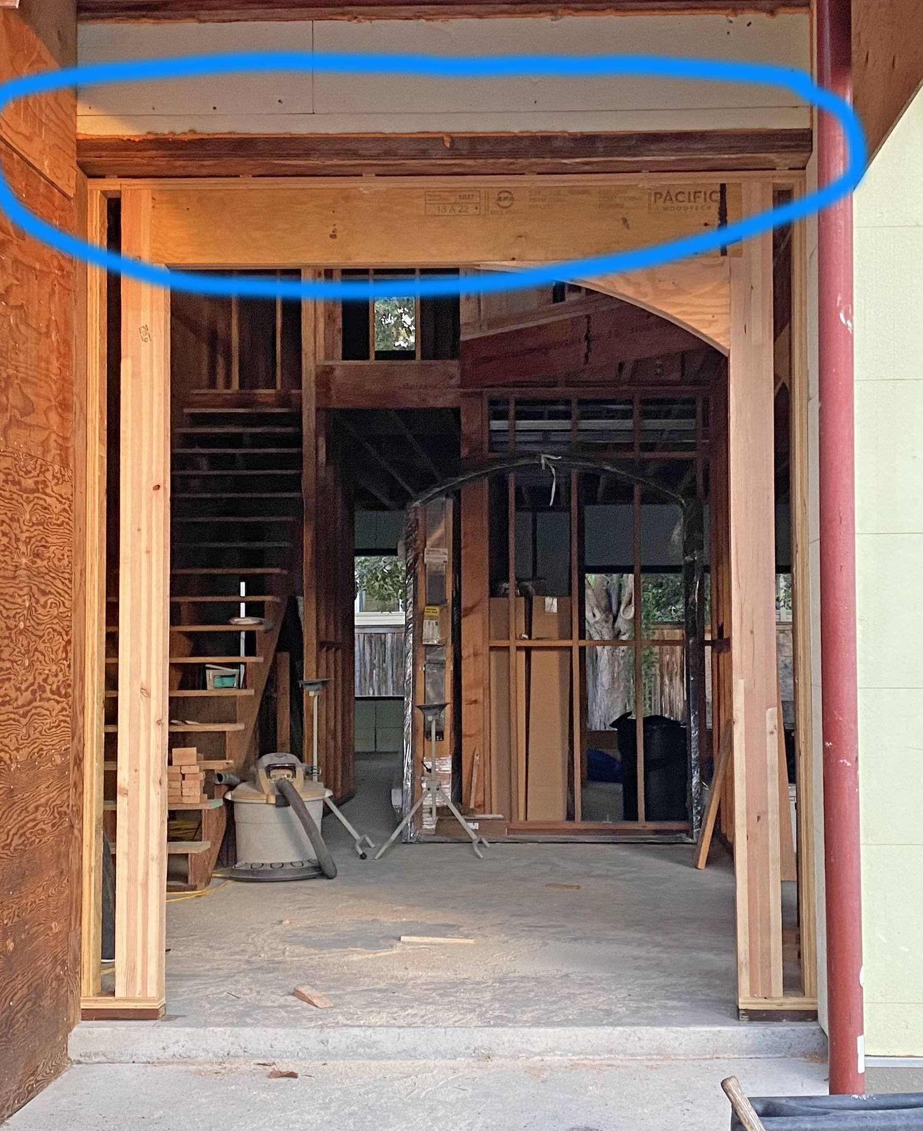

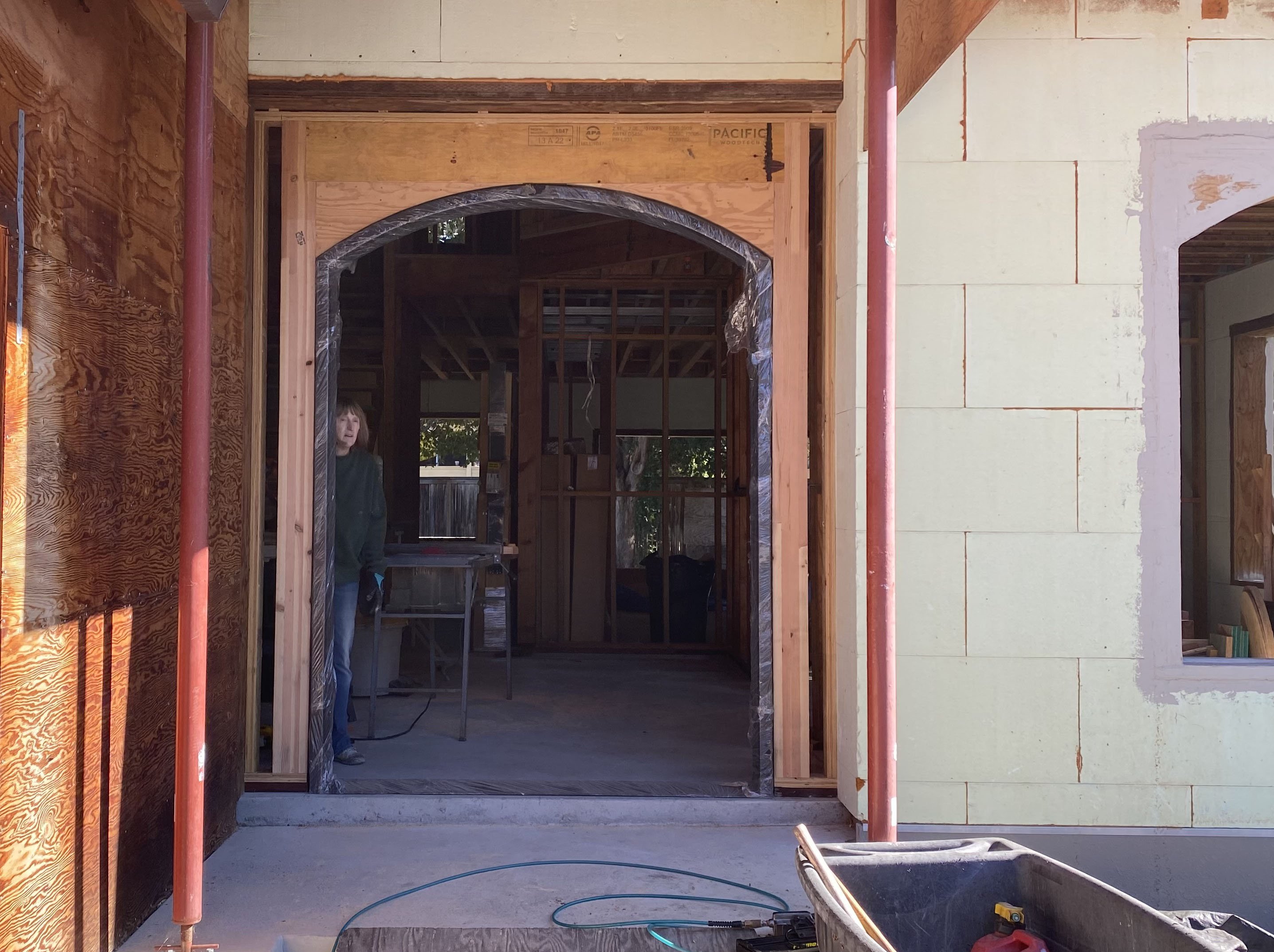

cgrafx Posted November 1, 2025 Author Share Posted November 1, 2025 Yes, I framed inside the opening for the door (I'm the owner/builder). Trying to create a complete set of as-built plans to go with the custom build. The original architectural plans were done a long time ago and are hand drawn. I have a hybrid set of plans currently that was started in a different CAD program and then dropped into Adobe Illustrator, but I'd really like to have a proper set of CAD files to go with the house. The door framing is inset a couple of inches on the inside of the house leaving a much larger inset at the front which has a 2nd curved relief over the door to bring it flush with the ICF wall. I'd really like to understand how to create these sorts of models in Home Designer. I do understand that it may not be possible to get exactly what was built, but I'd like to get as close as possible. The difference for me is just dropping a door into the ICF wall will not really come close to matching what was built. 32 minutes ago, y-g-m-n said: When it is all finished what will be different there? I mean if nothing then just stick your door in the main wall and forget about this framing. Link to comment Share on other sites More sharing options...

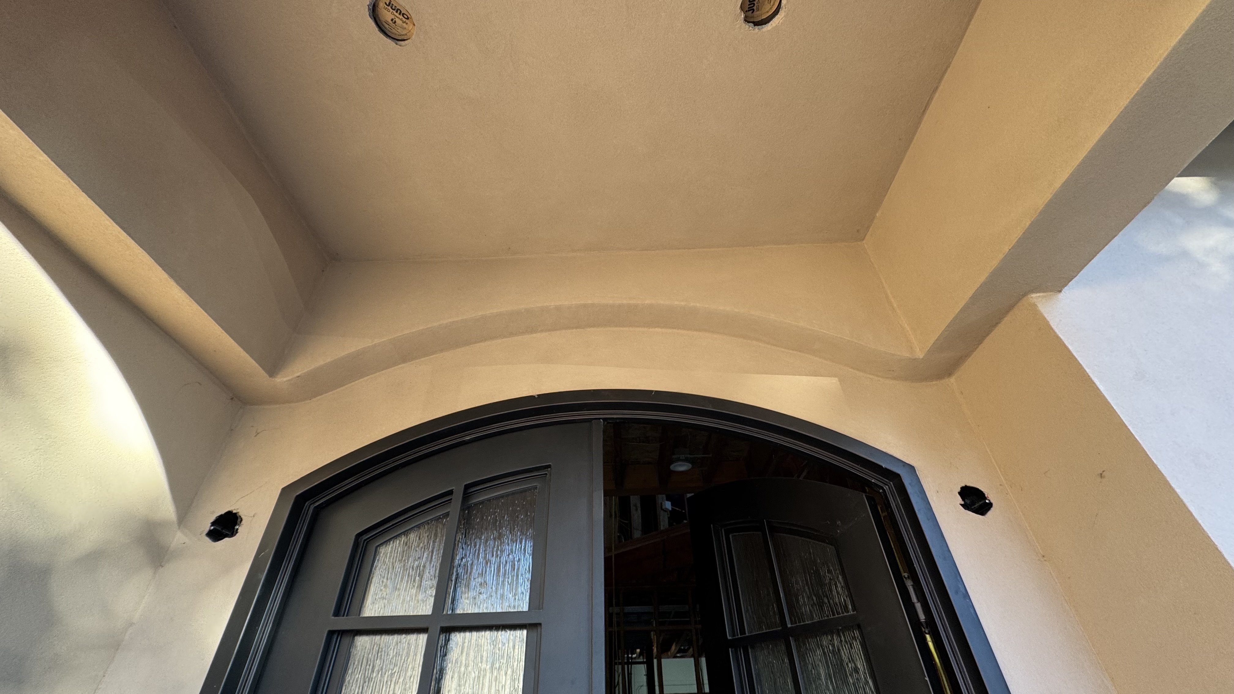

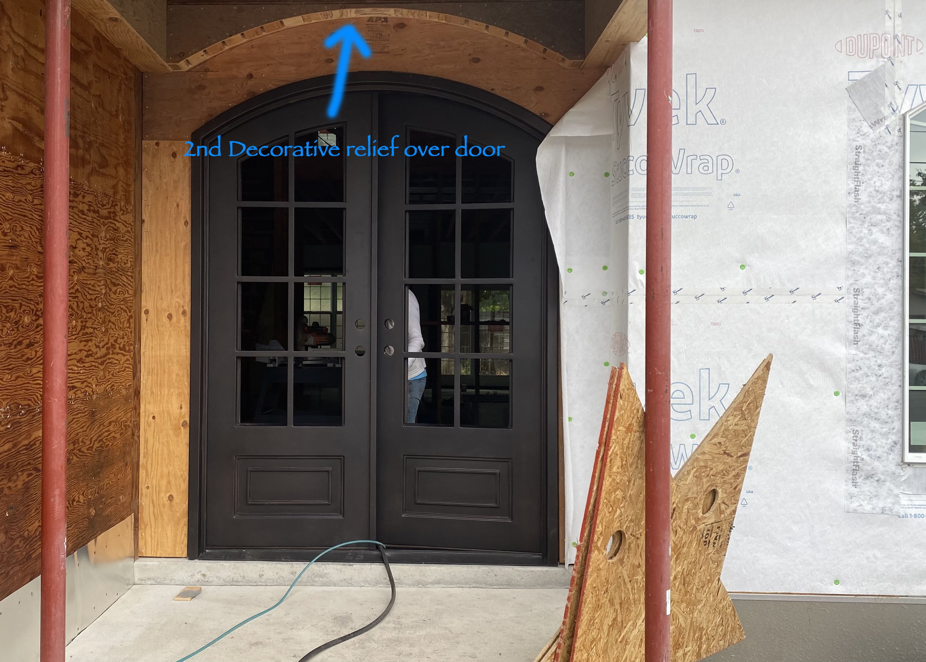

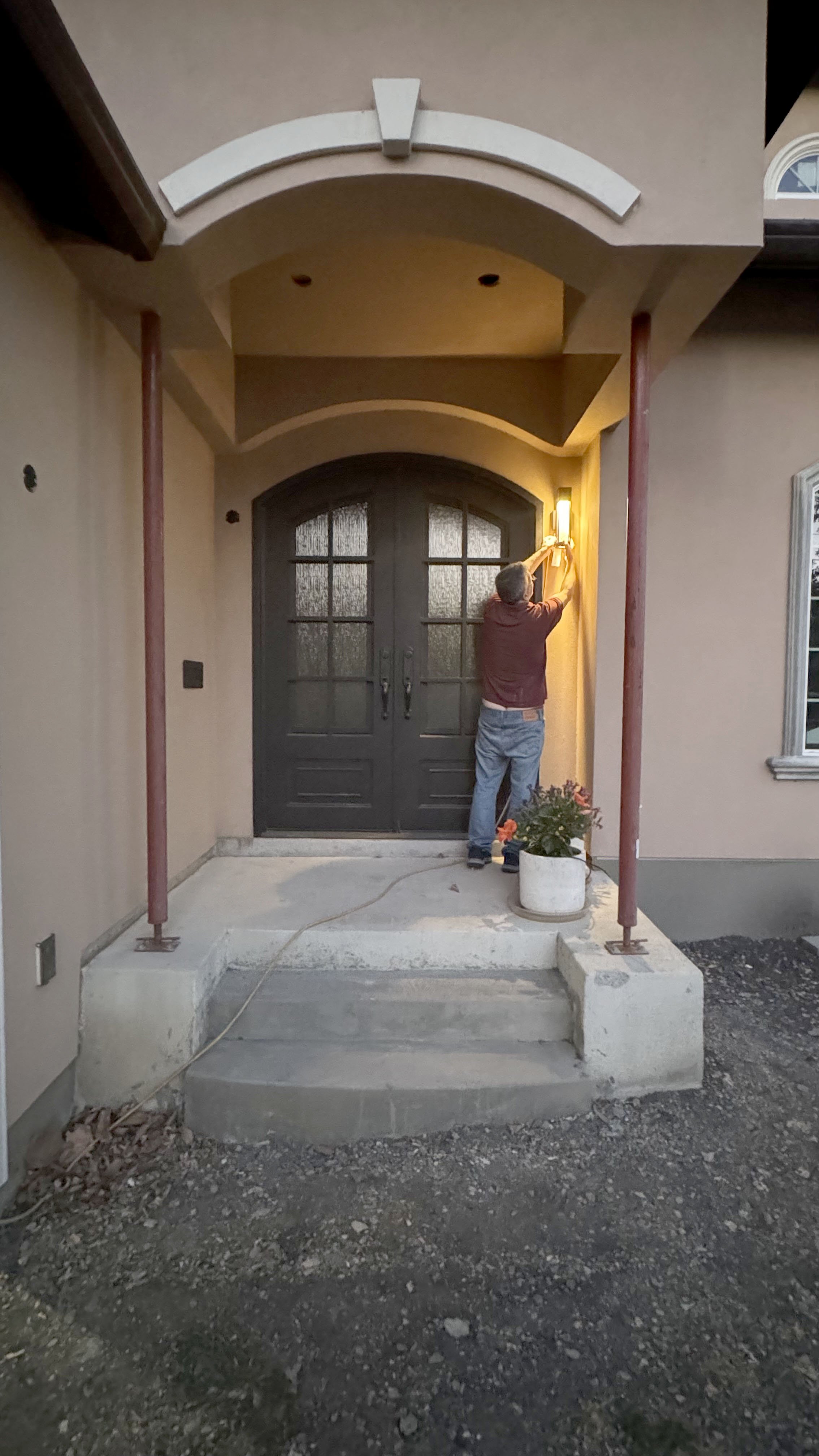

cgrafx Posted November 4, 2025 Author Share Posted November 4, 2025 Thanks.. I have played with pretty much all of the options and can't get the flashing between the ICF and the framed wall to turn off. I don't have a problem getting the door to cut in, just need the flashing not to show up. Guess I can play with this more, but it seems like this should be simple to accomplish. But maybe its not doable in the home designer product. You can see the actual finished entry with the stacked relief over the door in the attached photo. Link to comment Share on other sites More sharing options...
