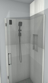

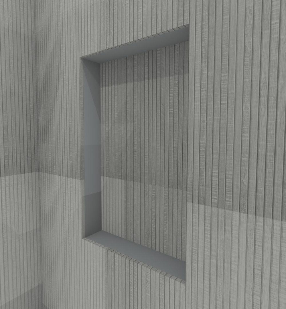

360Remodels Posted October 13, 2025 Share Posted October 13, 2025 Hi, I need to draw a shower with tile that does not go to the ceiling. I am using glass walls for the surround and a custom backsplash for the wall tile. I inserted a niche and I can add tile to the back but when I try to use the material painter on the sides of the niche, it adds tile material to the whole wall to the ceiling. Is there a certain way to do this so that only the sides of the niche get tile? I have experimented with using thin soffits around the sides of the niche but the tile doesn't wrap into the niche correctly. Any other work arounds? Thanks! Link to comment Share on other sites More sharing options...

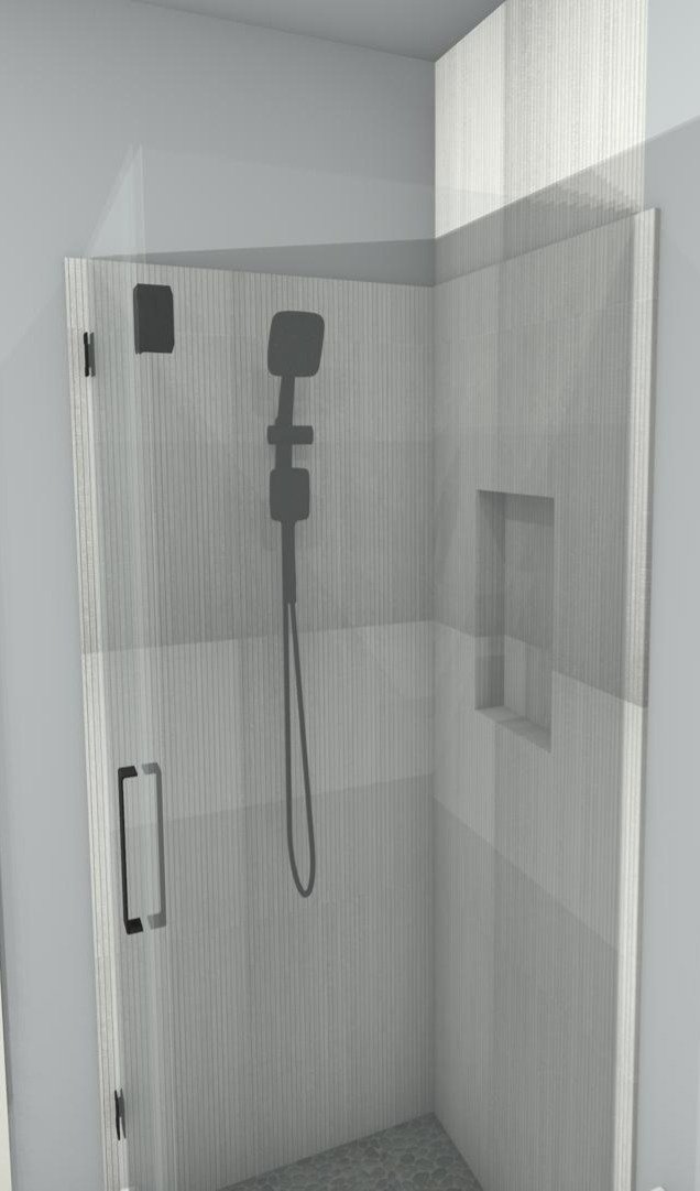

Solution y-g-m-n Posted October 14, 2025 Solution Share Posted October 14, 2025 maybe easiest way is to: click on the NICHE and open edit screen . Then go to FRAME tab and click them on and give them thickness of tile you will use and then adjust material for it and you will get it all the way around. here you can set the BACK material as well in lieu of custom backsplash. Link to comment Share on other sites More sharing options...

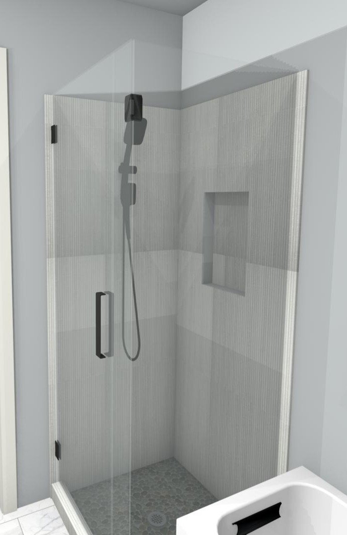

360Remodels Posted October 14, 2025 Author Share Posted October 14, 2025 That worked! Thanks! Link to comment Share on other sites More sharing options...
