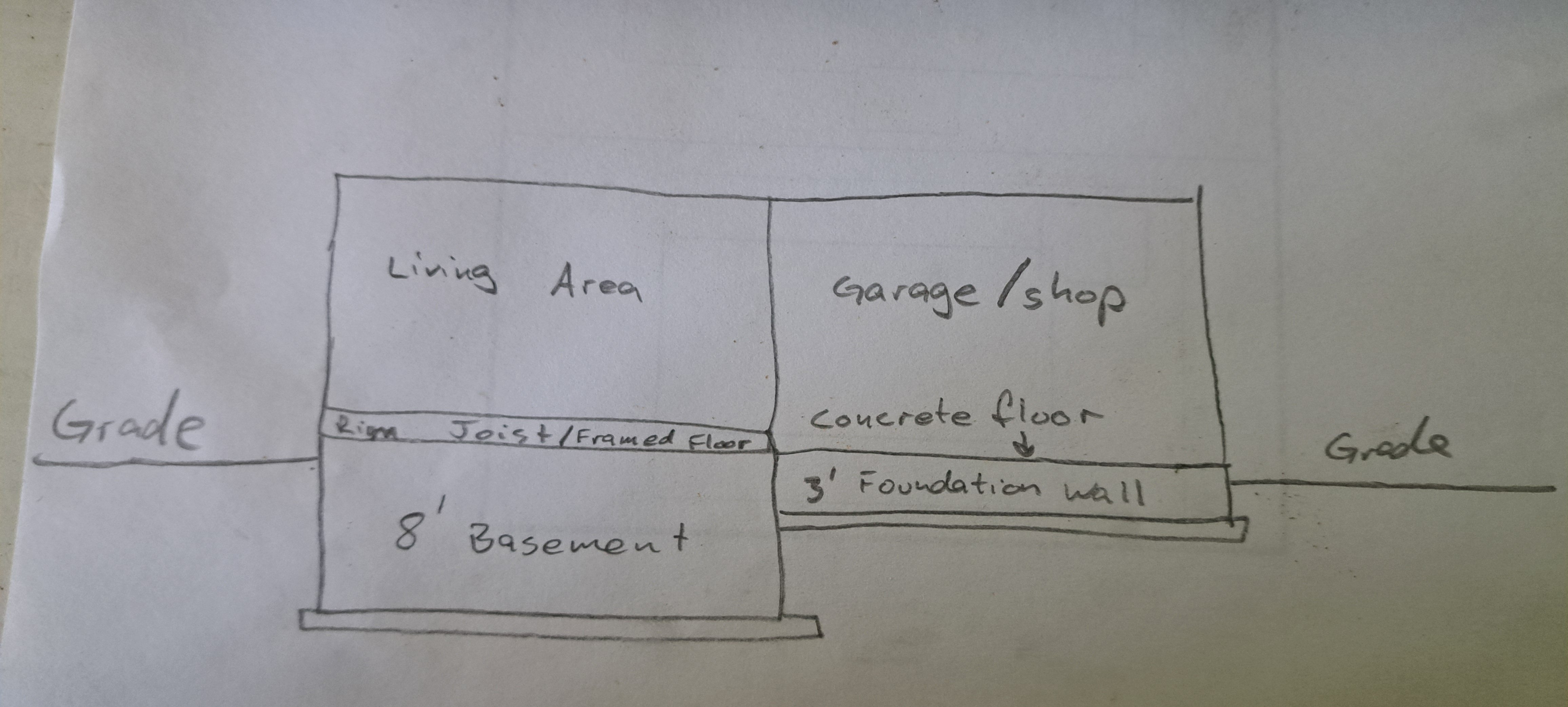

artavox Posted September 17, 2025 Share Posted September 17, 2025 I'm designing a house with a half basement . The other half of the foundation needs a 3' stem wall (to get the footing below frost line). The 'slab with footing ' tool won't let me add a stem wall and the foundation wall tool always puts the concrete floor down on the footing and adds a floor on top, creating a crawlspace. I need to create two foundation areas, with their tops at the same elevation, and, backfill the shallower one to pour a 4" slab. The shop side of the house will look like a slab on grade. Any ideas?? P.S. Is there anyone who can point me in the right direction for a tutorial on doing split levels within the same storey? Link to comment Share on other sites More sharing options...
Rookie65 Posted September 17, 2025 Share Posted September 17, 2025 Try calling the room with the shorter stem wall a garage in room type only. Then you can name the display name whatever it needs to be. Set your garage room defaults to what you need it to be. Link to comment Share on other sites More sharing options...
artavox Posted September 17, 2025 Author Share Posted September 17, 2025 I tried that. The closest I got was a framed floor over the foundation. No idea how to back fill and get a slab floor that sits level with the top. Link to comment Share on other sites More sharing options...
