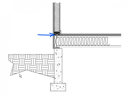

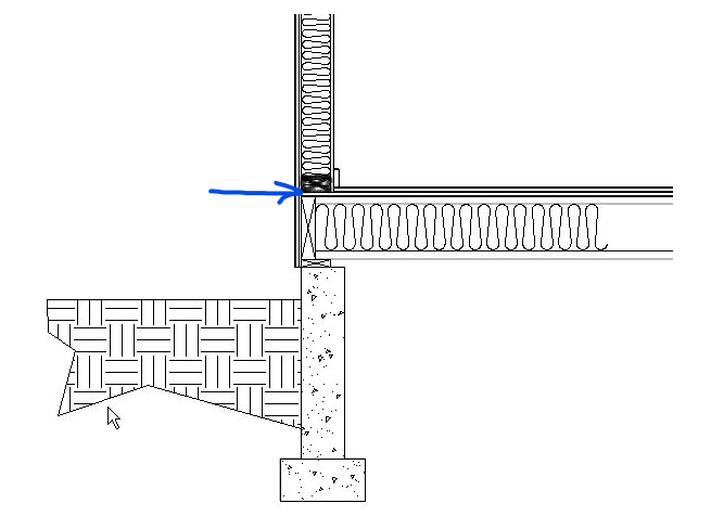

Rookie65 Posted August 18, 2025 Share Posted August 18, 2025 The subfloor is already doing that. Look closer Link to comment Share on other sites More sharing options...

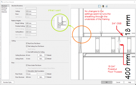

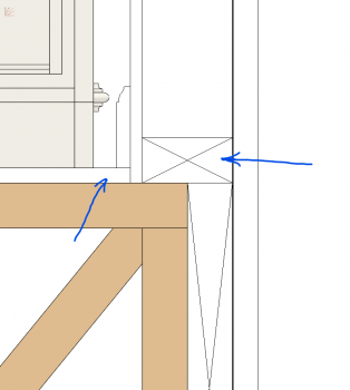

ChiefNZ Posted August 18, 2025 Author Share Posted August 18, 2025 2 hours ago, Rookie65 said: The subfloor is already doing that. Look closer Apologies. That's an illustration taken from the one of the tutorials, meant to illustrate what I'm wanting to achieve. Here's how it looks for me at the moment. Link to comment Share on other sites More sharing options...

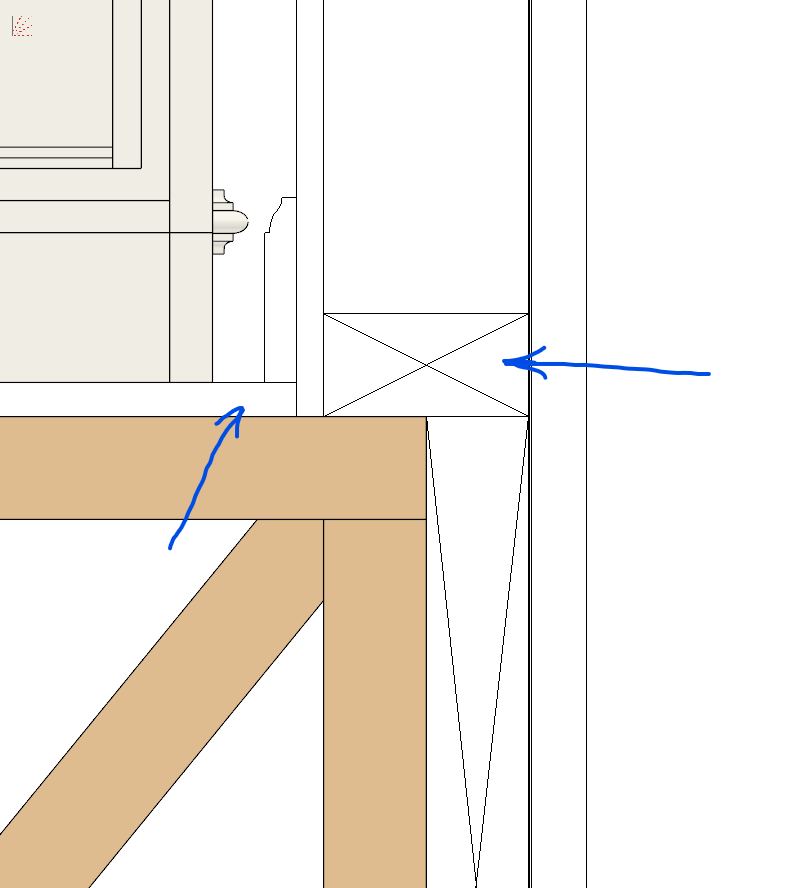

y-g-m-n Posted August 18, 2025 Share Posted August 18, 2025 heck that looks like the flooring on top of the floor truss since cabinet sit on it as does baseboard molding. check your default settings for Framing. Fr Foundation, 1st & 2nd flooring as it applies - review "FLOOR STRUCTURE FOR FLOOR X" Where X is for the floor above E.g. for Foundation tab you set the flooring structure for the 1st floor Link to comment Share on other sites More sharing options...

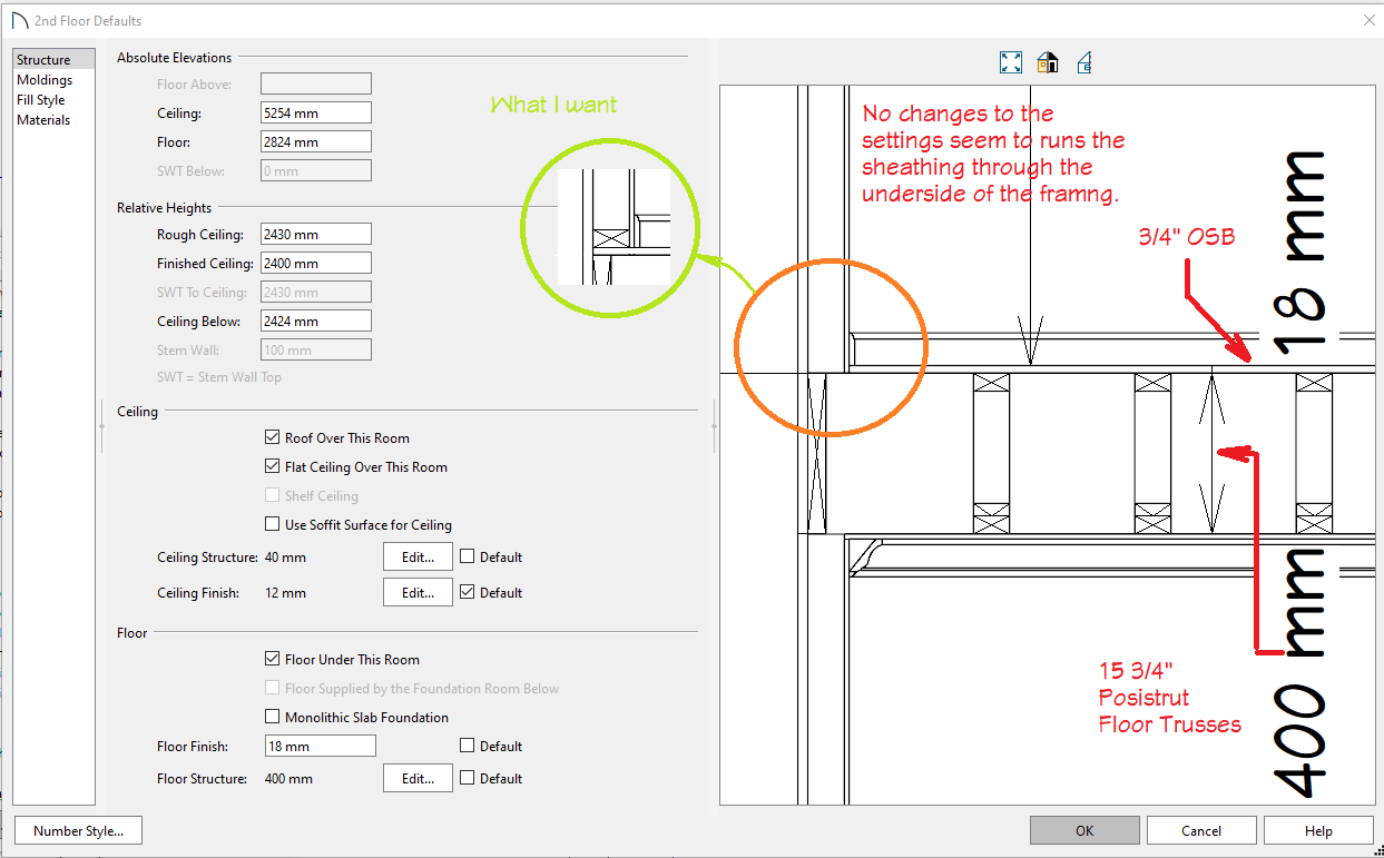

ChiefNZ Posted August 18, 2025 Author Share Posted August 18, 2025 14 hours ago, y-g-m-n said: heck that looks like the flooring on top of the floor truss since cabinet sit on it as does baseboard molding. check your default settings for Framing. Fr Foundation, 1st & 2nd flooring as it applies - review "FLOOR STRUCTURE FOR FLOOR X" Where X is for the floor above E.g. for Foundation tab you set the flooring structure for the 1st floor My version of CA is House Designer Pro 2025 X16 It's taking a bit, but I am making some progress... Here's my settings for floor 2. The typical floor height is 2400mm (8ft) in NZ for a room and so that is my goal for the finished height when all the linings and sheathing are in place. However, It doesn't seem to matter what measures I change, none of them promote the sheathing to go under the framing (the standard method for framing here). Here's my settings and a close up of the prototype in the default settings dialogue for Floor 2.... Link to comment Share on other sites More sharing options...

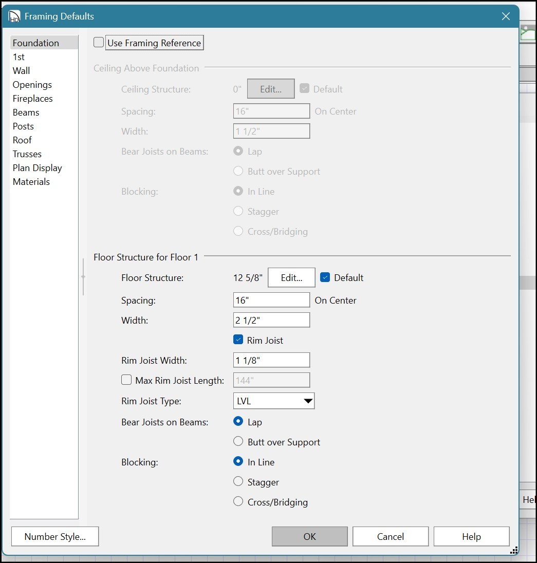

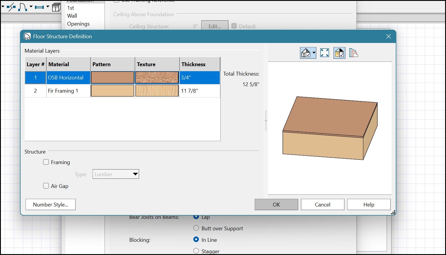

y-g-m-n Posted August 19, 2025 Share Posted August 19, 2025 not sure where you got your screen from but here is what I see using HD PRO 2025 Framing page is what you see under : EDIT - DEFAULT SETTINGS - FRAMING Notice it came up on FOUNDATION tab and you can define the first floor structure. IGNORE actual timber sies as they are program defaults So I then click on EDIT net to FLOOR STRUCTURE See it has plywood and JOIST material 11 7/8" tall. that is it. my guess is you do not have the sheathing GEt to that screen and click HELP Link to comment Share on other sites More sharing options...
ChiefNZ Posted August 19, 2025 Author Share Posted August 19, 2025 13 hours ago, y-g-m-n said: not sure where you got your screen from but here is what I see using HD PRO 2025 Framing page is what you see under : EDIT - DEFAULT SETTINGS - FRAMING Notice it came up on FOUNDATION tab and you can define the first floor structure. IGNORE actual timber sies as they are program defaults So I then click on EDIT net to FLOOR STRUCTURE See it has plywood and JOIST material 11 7/8" tall. that is it. my guess is you do not have the sheathing GEt to that screen and click HELP Hi Y-G-M-N. Thank you for taking the time to look at my issue. That is what I needed to know and it make sense how the program handles floor diaphragms. I'm back in the race and making progress again. Most obliged... Link to comment Share on other sites More sharing options...
