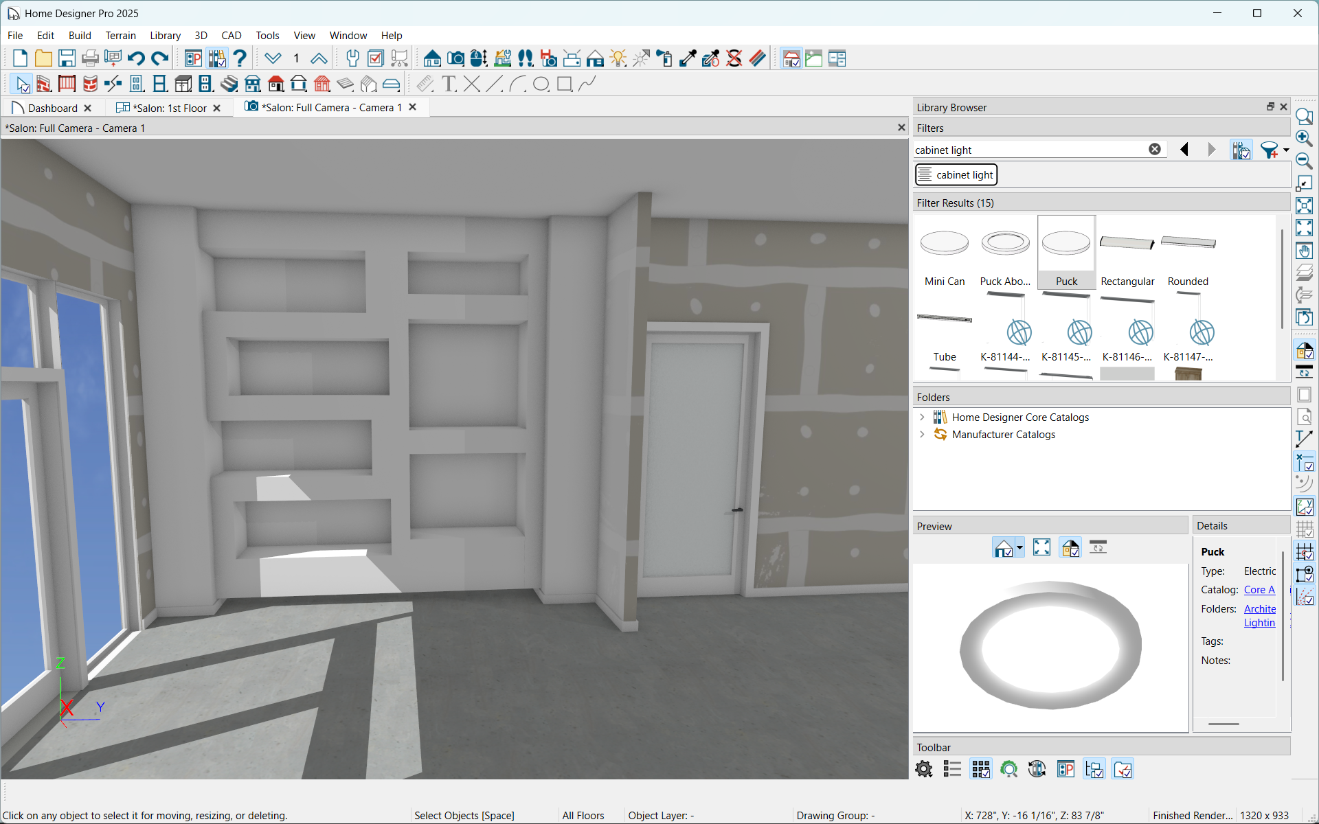

jbandele Posted August 31 Share Posted August 31 I created this bookshelf using cabinet shelf tools. Is there a way to position the light fixture underneath the shelves? Link to comment Share on other sites More sharing options...
y-g-m-n Posted September 1 Share Posted September 1 It should have elevation location dims...think they call it offset from ceiling... So place it where you want it in plan view then click on it and open up the edit dialogue screen for it and adjust vertical location to be underside of shelf you want to locate it at. 1 Link to comment Share on other sites More sharing options...
