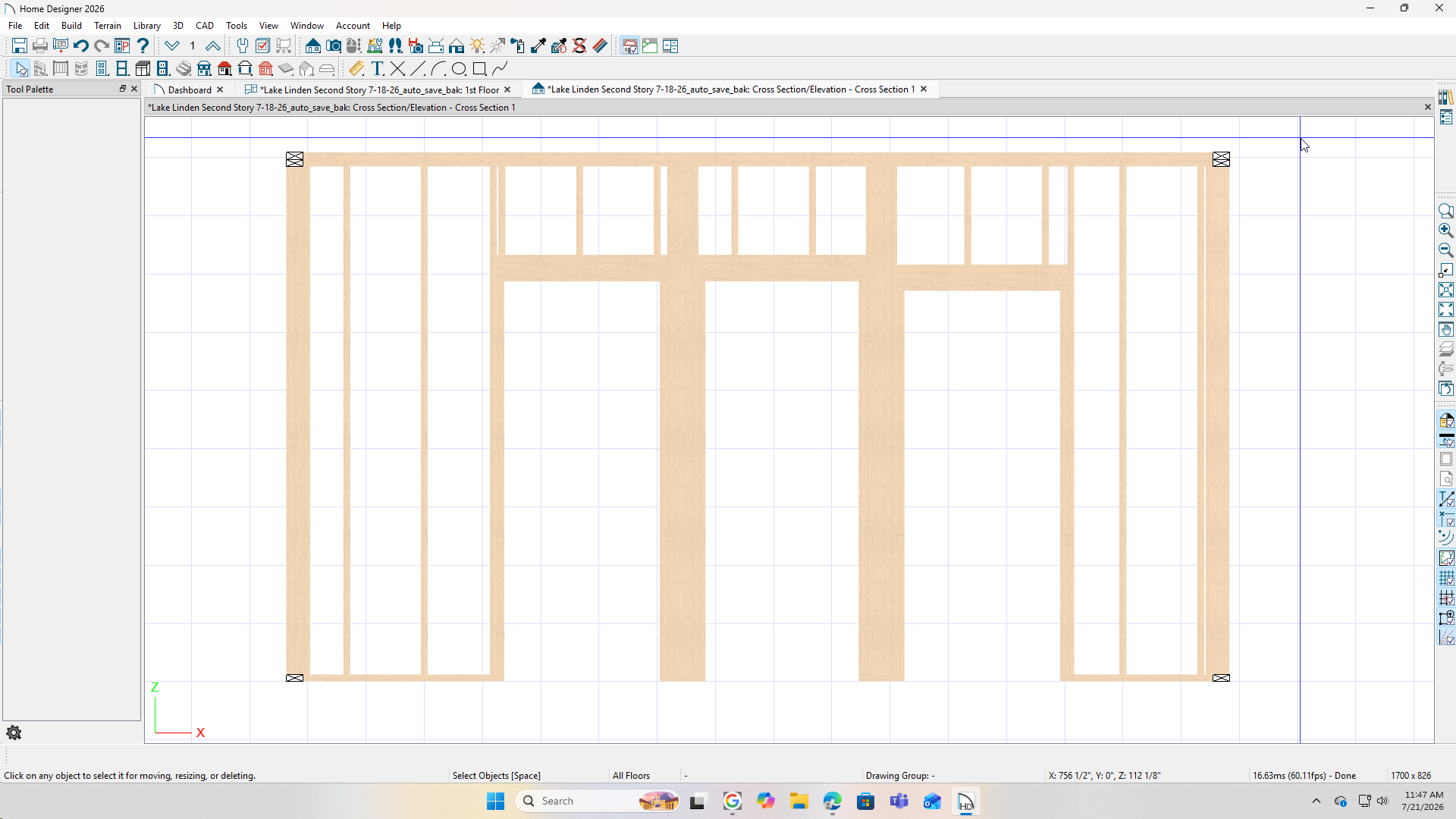

Jdscott Posted July 21 Share Posted July 21 Hello, What option needs to be checked to see individual lines on the wall framing? It looks like one solid piece now. Thanks Link to comment Share on other sites More sharing options...
ChiefTylerL Posted July 21 Share Posted July 21 @Jdscott, It looks like you're using the Standard Rendering Technique which will not display edge lines. Switching to the Vector Rendering Technique will give you the edge lines that you're looking for. This can be done by being in the elevation view, going to 3D> Rendering Techniques, and selecting Vector View. I hope this helps! Link to comment Share on other sites More sharing options...
Jdscott Posted July 21 Author Share Posted July 21 This is a drawing brought in from Home Designer Suite. When I go to Vector view its dark and won't let me choose it. Link to comment Share on other sites More sharing options...
ChiefTylerL Posted July 22 Share Posted July 22 Based off of that description it sounds like you may not have been in the elevation view when navigating to 3D> Rendering Techniques, since these options are only available when you're in a camera/cross section view. If this isn't the case I would recommend contacting Technical Support for further assistance. Using the Technical Support Center: https://www.chiefarchitect.com/support/article/KB-00717/using-the-technical-support-center.html Link to comment Share on other sites More sharing options...
