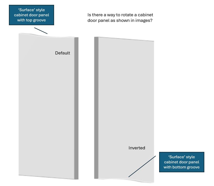

JodieCameron Posted May 29 Share Posted May 29 Hi All, One of the bonus catalogue cabinet door panels called 'Surface' has a grove cut into the top to allow opening without hardware. I would like to know if there is a way to invert this door so they can be placed on upper cabinets and have the groove at the bottom. I have attached an image for visual reference. I am using 2025 Home Designer Pro. I have tried via the edit settings, individual cabinet section settings and also copied it to my user library to edit freely, but with no luck. Thanks all!! JC Link to comment Share on other sites More sharing options...
ChiefTylerL Posted May 29 Share Posted May 29 Hello @JodieCameron, It looks like to add a rotated version of this door to your catalog you will need to place the door freestanding (In the middle of your room), take a cross section/camera view, rotate the door so that it is now inverted, and with the door selected use the Add to Library button on the bottom toolbar. This will add the rotated cabinet door to your user catalog that you can then apply to your wall cabinets. I hope this helps! Link to comment Share on other sites More sharing options...
JodieCameron Posted May 30 Author Share Posted May 30 Thanks heaps Tyler - that worked a treat - that was the only thing I didn't think of. Link to comment Share on other sites More sharing options...
