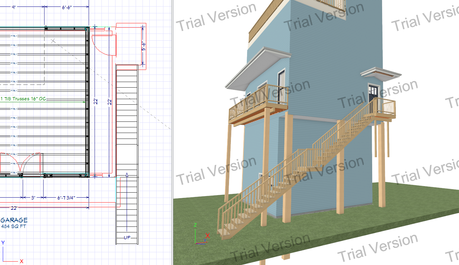

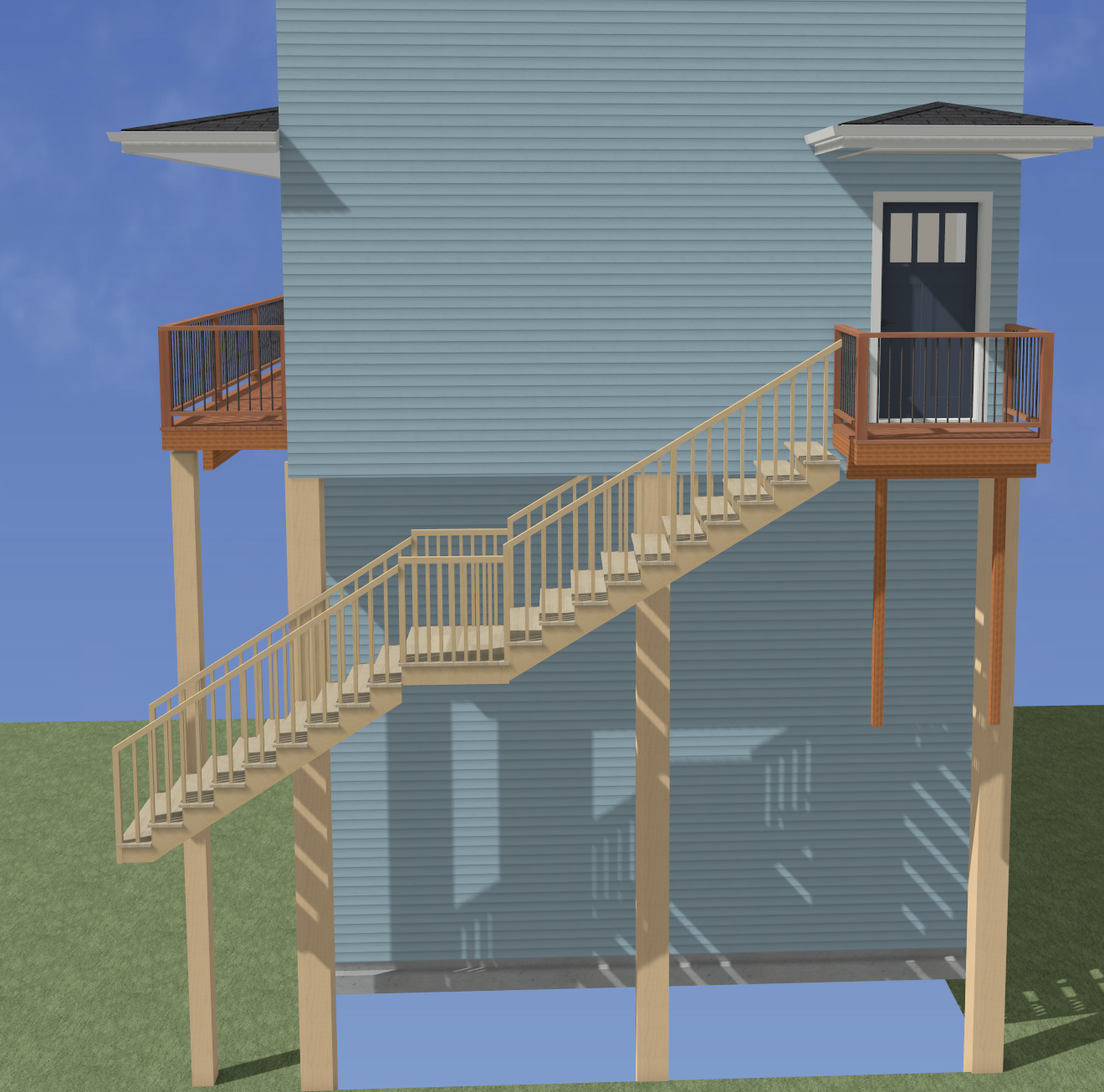

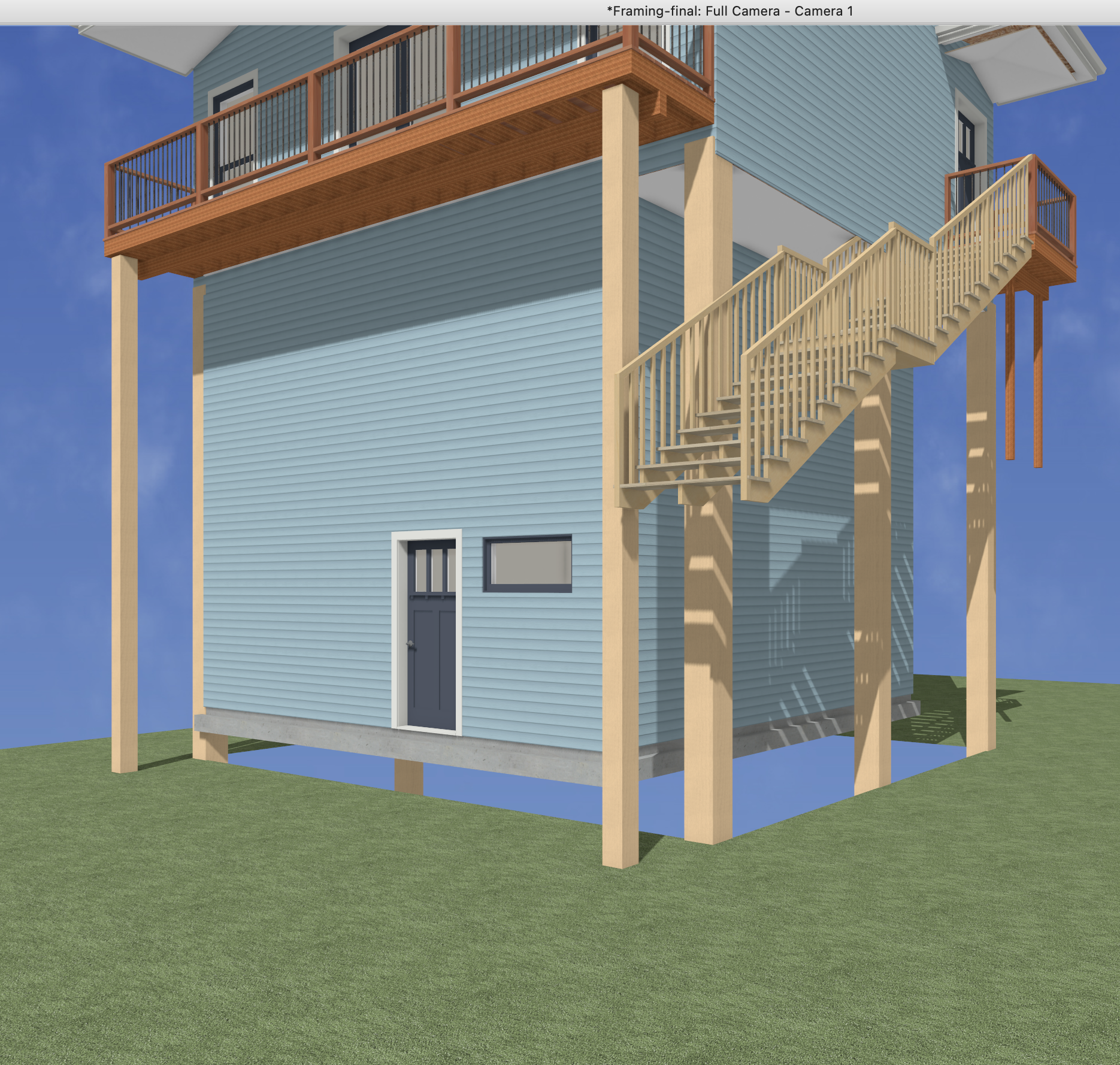

Heididesign Posted September 22 Share Posted September 22 HD Pro 2025 I cannot seem to connect the top of my stairs to the deck and they do not end on the ground. They only go down one floor level. The deck post do not go all the way down either. The pilingson the house I drew in. Link to comment Share on other sites More sharing options...

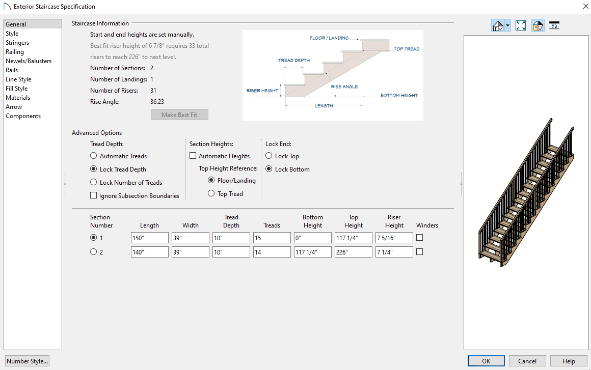

Garybills Posted September 23 Share Posted September 23 I don't have HDP 2025, but I used the trial version of 2026. You need to draw the 2 stair sections and landing on floor 1 and they will build to floor 2, then you will need to set them up in the stair advanced options to get them to the 3rd floor. I drew in the terrain and have the bottom at 0" so you may need to adjust the bottom to whatever your terrain will actually be. Hope that helps. Link to comment Share on other sites More sharing options...
Garybills Posted September 23 Share Posted September 23 You should be able to select the deck post in the 3d view and drag them down. Link to comment Share on other sites More sharing options...
