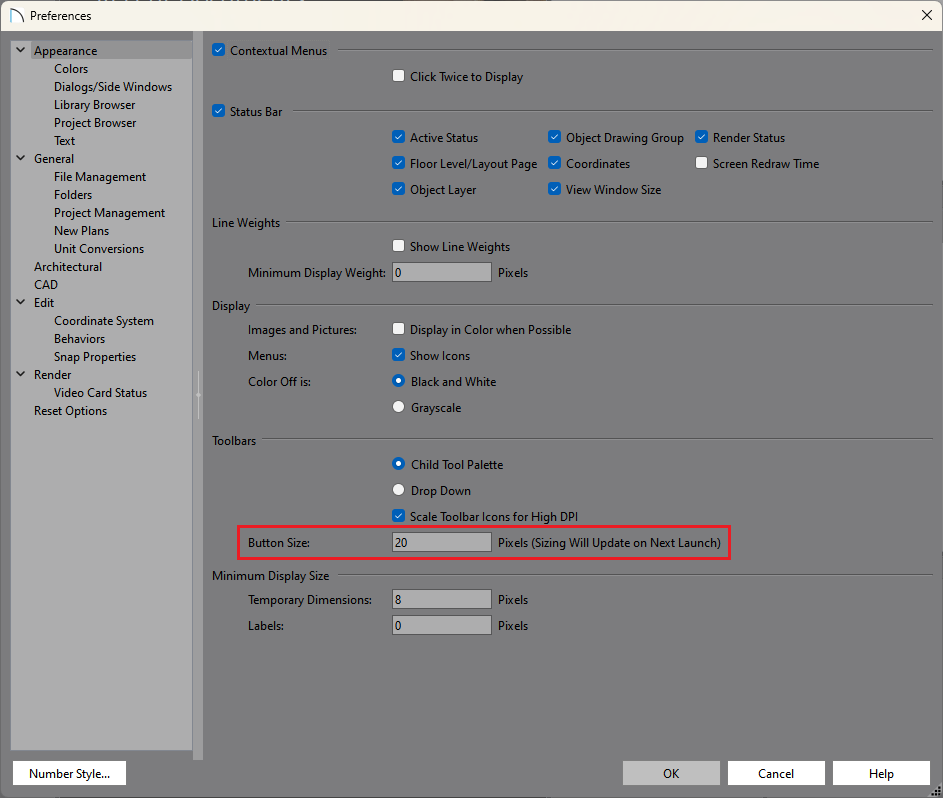

ConnorE Posted Monday at 03:04 PM Share Posted Monday at 03:04 PM Hey Mike, If you go to Preferences > Appearance there is a Button Size control under the "Toolbars" section where you can increase the size of the toolbar buttons. Link to comment Share on other sites More sharing options...
