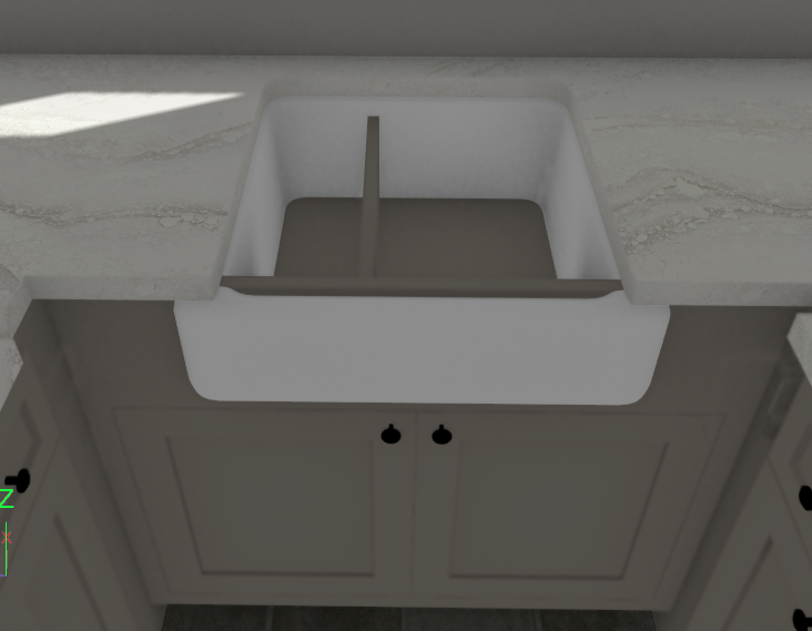

LexieSolis Posted October 24, 2025 Share Posted October 24, 2025 Hi! I'm trying to place an apron sink in this custom cabinet, but it keeps doing this to me. Can anyone help me remove this out of the sink? Thank you! Link to comment Share on other sites More sharing options...

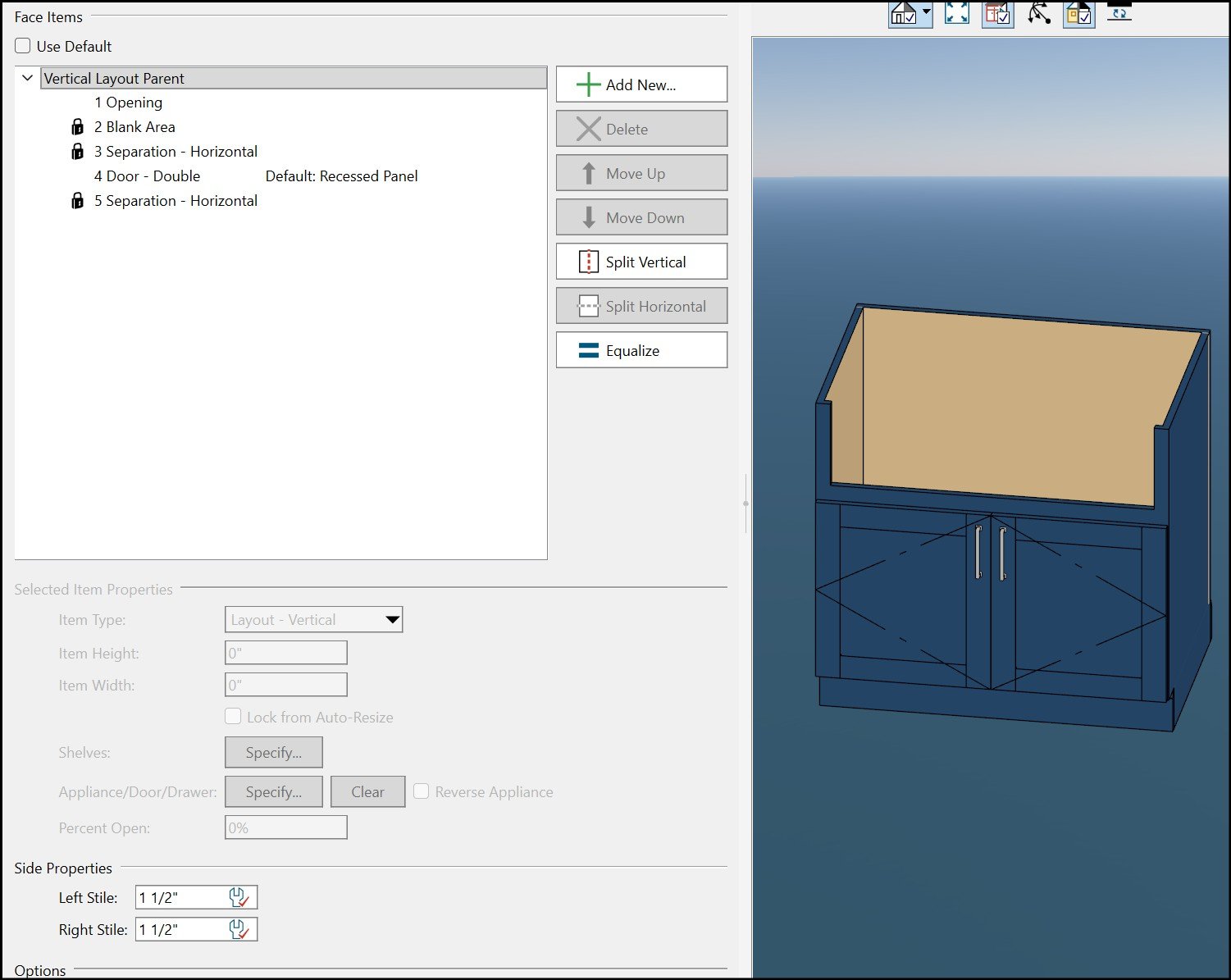

y-g-m-n Posted October 25, 2025 Share Posted October 25, 2025 need to edit the CABINET. Open edit dialogue and then go to FRONT. Assuming face frame and overlay type Starting from Top Open Area > Height = Your Cabinet Sink Height and might need to adjust stile width to close up sides to meet sink so (Cab W - Sink W)/2= stile width Blank Area > Depends on Cabinet specs and sink Height but should be whatever is need to ensure some space for doors to open Separation - Horizontal > Height = Your Cabinet standard Double Door > Height = What ever cabinet manufacture states if you do not know use 16.5" Separation - Horizontal > Height = Your Cabinet standard Everything depends on which Apron sink you choose as well as cabinet. So choose cabinet and use their specs for stile, overlay etc. Then customize the front as most APRON SINK CABS do not have opening cut since all sinks are different. IN fact some are made to just slip over plywood (see Kohler) Screen shot is of Apron Sink Cabinet I did. Remember installers will have to add internal cabinet structure to hold up sink - again depends on sink manufacture Link to comment Share on other sites More sharing options...
